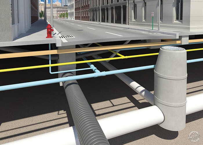

风险评估中的场地科学
就当前而言,新道路、桥梁、基础设施的最大限度价值提升意味着以更加优化的方式来解决当今城市所面对的诸如可持续发展以及城市弹性等问题。因此这就需要灵活运用BIM、CAD、以及GIS之间的动态数据。
在实际场地中结合实际地理环境通过数字方式构思方案,这能够提前解决建筑与设计过程中所出现的诸多问题。在许多大型基础设施项目中,长时间的延误往往来源于规划和许可阶段,因为其中涉及到太多的社会、经济、环境影响等因素的风险评估。工程师和规划者能够利用地理数据在设计之前就解决这些问题,这便是他们如此看重洪水泛滥地区的信息或者地下设施的定位图像的原因。因此,在方案中结合使用GIS和BIM,何乐而不为呢?
当项目已建成,GIS和BIM数据同样有用,相较于其他设施管理中的最终数据而言,GIS和BIM模型的结合能够灵活表达各种数据需求。投资方也能够在项目的全生命周期内查看这些重要数据。
举例来说,一条道路投入使用便意味着设施的管理,那么就需要安装护栏、分隔带、设置监管人员。但其中仍然存在多次翻修和改造的契机,那么,当GIS、CAD、BIM结合使用时,你便能够提升项目的可行性,同时减少错误,而这种技术在项目的后期维护中同样发挥着重要作用。
The Science of “Where” in Risk Assessment
Maximizing the long-term value of new roads, bridges, and facilities means delivering better designs to solve many of the sustainability and resiliency issues facing cities today. This will require optimizing dynamic data interchange between BIM, CAD (computer-aided design), and the geospatial information provided by GIS.
Placing a digital design in a real place, within real geography, eliminates much of the front-end risk of designing and building. The biggest delays in large infrastructure projects come from the planning and permitting phases, which involve a lot of assessments of social, economic, and environmental impacts. Engineers and planners do much of that assessment outside of the design process using geospatial data; that’s how they look at floodplain maps or locate underground utilities. So, why not design using GIS and BIM data simultaneously?
This GIS and BIM integration is equally useful once a structure is built. Rather than oversimplifying the end data provided for facilities management, the flexible model—connected to GIS—delivers everything operations need. Customers have the ability to reuse that data throughout the structure’s lifecycle.
For example, operating a road in the real world means managing utilities, managing guardrail installation, maintaining striping, and overseeing maintenance crews. There’s a lot of retrofitting and renovation. When GIS, CAD, and BIM are connected, you’re improving operability and eliminating errors. This technology convergence will play an important role in predictive maintenance, too.
