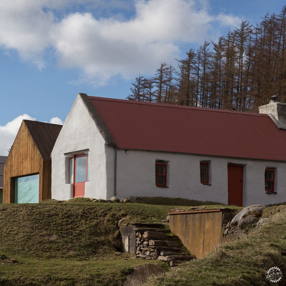

Urban Agency建筑事务所位于爱尔兰首都都柏林,在哥本哈根和里昂都设有办事处,在十年前,客户委托他们设计一个项目,即扩建Carragh Lake山坡上的小屋。
客户想利用手头上的闲钱逐步完成这个项目,同时希望建筑在退休前可以建成。
Architecture firm Urban Agency, which has offices in Dublin, Copenhagen and Lyon, was asked more than a decade ago to develop a proposal for extending an existing cottage on a hillside overlooking Carragh Lake.
The client wanted to work on the project gradually whenever he had money available, with the aim of completing it in time for his retirement.

卧室扩建部分的形式与旧房屋相似,不同之处是新建筑完全由混凝土建造,整体的感觉让人联想到爱尔兰的乡土石材建筑。
Urban Agency建筑事务所联合创始人Maxime Laroussi告诉Dezeen的记者:“与现有的农舍相比,扩建面积相当大。在参考爱尔兰传统农舍和谷仓后,我们决定把建筑分成两个类似体量。”
The gabled form of the bedroom extension mirrors that of the old cottage, but is constructed entirely from concrete to lend it a monolithic feel reminiscent of Ireland's vernacular stone buildings.
"The extension is quite large in relation to the existing cottage, so we decided to break the volume into two small hut-like structures as a reference to traditional Irish cottages and barns," Maxime Laroussi, co-founder of Urban Agency told Dezeen.

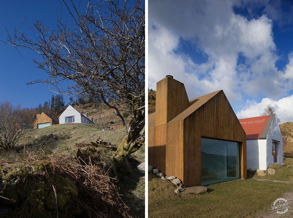

The remote site is very exposed to the wind and rain, which informed the choice of concrete for the outer shell.
The architects tried using a traditional method for pigmenting the concrete but realised that it would be prohibitively expensive, and the majority of the pigment would end up hidden in the mass of the walls.
Instead, after a prolonged period of research, they discovered an iron-oxide powder than can be purchased from garden centres and is typically used to boost iron levels in soil. When mixed with water and applied to the concrete surfaces, the powder produces a vibrant rust colour that will last longer than standard pigments.

The concrete was cast in situ using wooden boards that have left the texture of their grain on the surfaces. The boards run vertically, so when rain falls on the building the pattern of the wood is emphasised.
The position and orientation of the new structures were determined by the topography of the site and the relationship to the views. The end wall of the gabled volume incorporates a large window that faces out towards the lake.
The interior of the new extension features cement mixed with lime that is painted white to create a sense of consistency with the existing cottage. The material creates a slightly textured surface with softened edges that evokes the appearance of traditional lime-based render.
