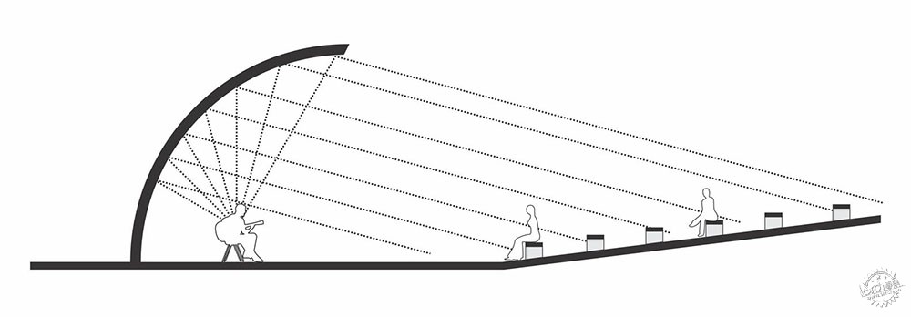

在声学壳体的设计中,其结构应当视具体情况而具体分析,因为不同空间所使用的的结构不尽相同,但是一般来说,声学壳体结构通常是一个以观众席中某一点为圆心的空间形体,抽象来看就是一个侧放的圆锥体,因此,这个圆心到壳体结构中的任一点的距离基本上是固定的。有的形状也许无法做到这一点,但是一个成功的声学壳体应当尽量遵循几何原则,运用马鞍形或波峰形都是不错的选择,一般的声学壳体由半圆形底座与抛物线形开口共同构成。
然而,还有其他一些因素会对声学壳体的有效性产生影响,通常来说,声学壳体所对应的地面应当具有一定的起坡,这样能够拥有很好的可视性,所以观众座椅通常呈放射状排布。同时,气候条件的影响也至关重要,如果当地的风速超过15公里/小时,那么就会对声音的传播造成干扰。[1]在设计中,还应该考虑环境材料,因为有的自然材料(例如草地)会吸收部分的声浪,而有的材料(例如水)却是声音的天然反射装置。
In the design of acoustic shells, each structure should be considered on a case-by-case basis, due to the spatial variations of each setting in which they could be used. However, they can generally be conceived as a geometric result of following a radius projected in three dimensions from a point in the audience, like a cone lying on its side. This point should therefore be about the same distance from every point of the concrete shell; however, varying geometries are possible that come close to this, and a successful acoustic shell could very well follow a folding geometry, or be created from geometries in a saddle or crest shape. Generally, they are formed by semicircular base and parabolic openings.
However, there are other factors involved in the proper functioning of acoustic shells. Usually, the ground outside the shell needs to be inclined, since this allows better visibility for the audience, and seating may also be arranged radially in an amphitheater form. Climatic conditions are also important for proper operation, since if the wind speed exceeds 15 kilometers per hour, this may cause disruption to the sound. [1] Environmental materials should also be considered, because certain natural materials, such as grass, partially absorb sound waves, while water surfaces are excellent reflectors.

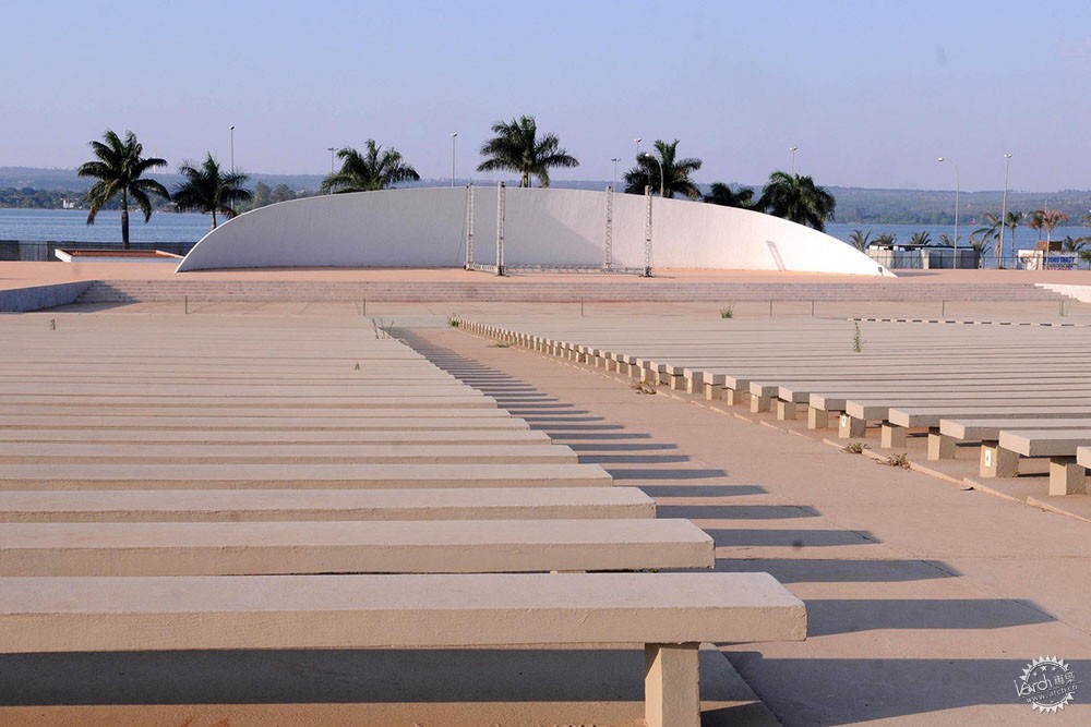

Acoustic Shell of Brasília /奥斯卡•尼迈耶
Acoustic Shell of Brasília / Oscar Niemeyer
剧场设计小帮贴:声学空间的工作原理第5张图片
Image © Gonzalo Viramonte

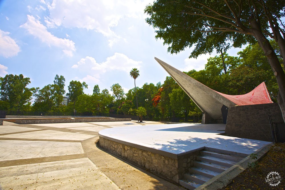

Parque Agua Azul声学壳体修复项目/ S2 Arquitectura
Rehabilitation of the Acoustic Shell of the Parque Agua Azul / S2 Arquitectura
剧场设计小帮贴:声学空间的工作原理第6张图片
Image © Carlos Garza

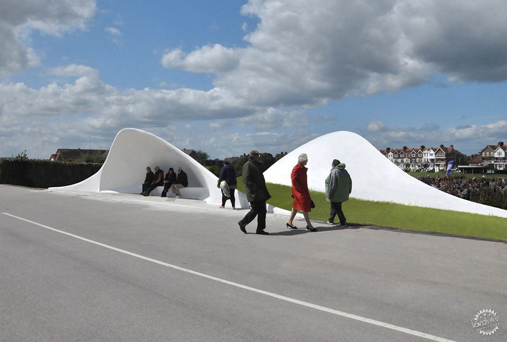

声学壳体/弗拉纳根劳伦斯
Acoustic Shells / Flanagan Lawrence
剧场设计小帮贴:声学空间的工作原理第7张图片
Image Cortesia de Flanagan Lawrence

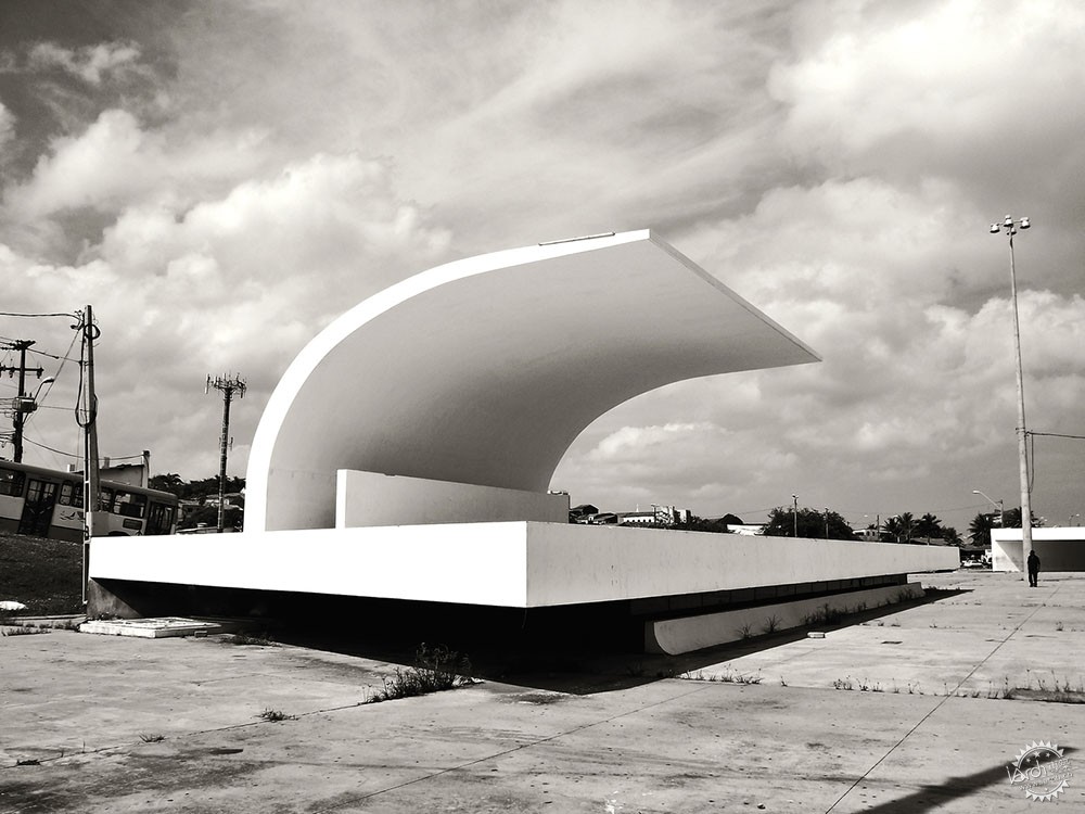

Memorial Maria Aragão/奥斯卡•尼迈耶
Memorial Maria Aragão / Oscar Niemeyer
剧场设计小帮贴:声学空间的工作原理第8张图片
Image © Rômulo Marques
