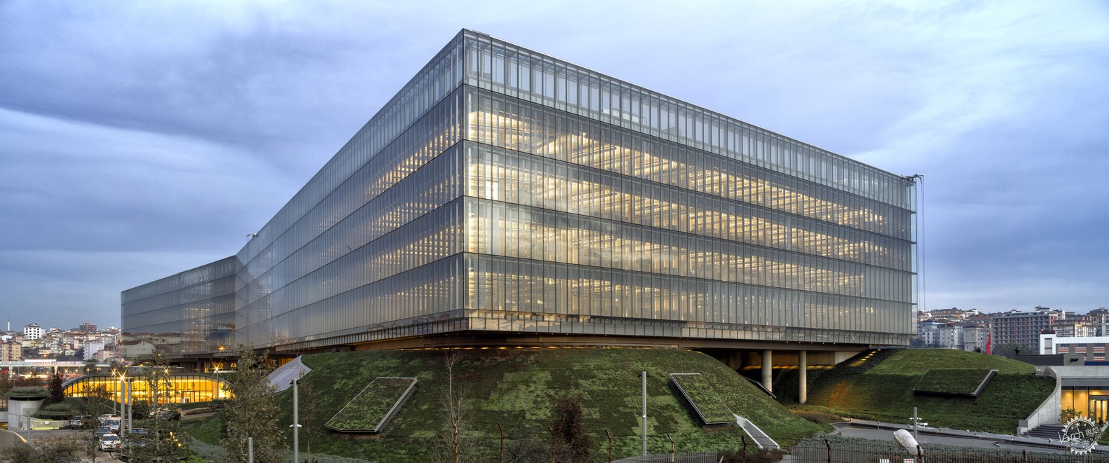

虽然双层幕墙的概念并不新鲜,但建筑师和工程师越来越倾向于使用这种幕墙。特别是在摩天大楼的设计中,双层幕墙因其通透的立面、热舒适度和听觉舒适度、低能耗以及易实施性而备受青睐。
While the concept of double-skin façades is not new, there is a growing tendency for architects and engineers to use them. Particularly in skyscraper design, they are favored for their transparent façade, thermal and auditory comfort, reduced air conditioning costs, and elimination of the need for window-specific technologies.

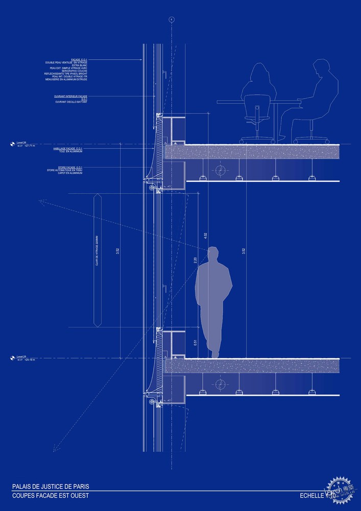

此外,双层幕墙还能适应较冷和较热的天气。正是这种多功能性使它们变得有趣:通过微小的动作,如打开或关闭进风口或出风口或启动空气循环器,就能改变外墙的性能。

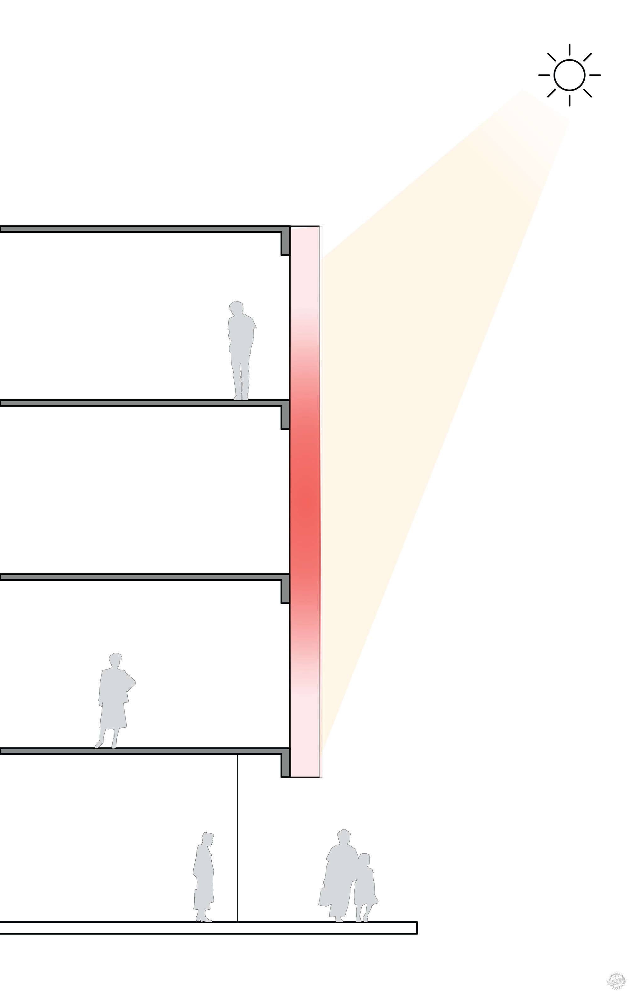

在寒冷的气候条件下,空气缓冲层可以起到阻挡热量流失的作用。空腔中被阳光加热的空气可以加热玻璃外的空间,从而减少室内对供暖系统的需求。
Additionally, double-skin façades are adaptable to cooler and warmer weather. It is this versatility that makes them so interesting: through minor modifications, such as opening or closing inlet or outlet fins or activating air circulators, the behavior of the façade is changed.
In cold climates, the air buffer works as a barrier to heat loss. Sun-heated air contained in the cavity can heat spaces outside the glass, reducing the demand for indoor heating systems.

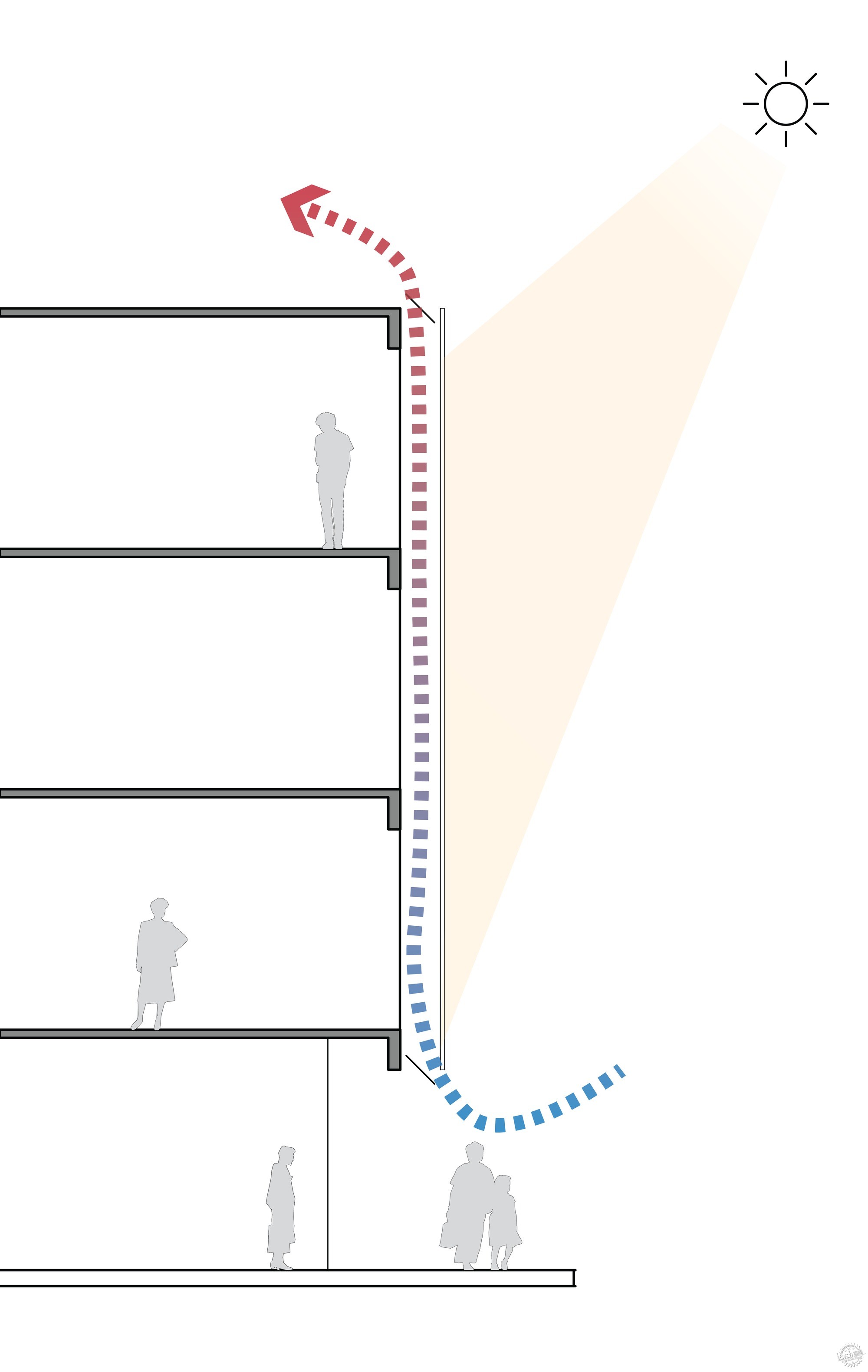

在炎热的气候条件下,可将空腔中的气体排出建筑物外,以减少太阳辐射热,降低制冷负荷。多余的热量会通过烟囱效应排出,空气密度的不同会产生循环运动,导致较热的空气从上方排出。当空腔中的空气温度升高时,它就会给周围环境带来微风,同时起到隔离作用,阻挡热量的吸收。
In hot climates, the cavity can be vented outside the building to mitigate solar gain and decrease the cooling load. Excess heat is drained through a process known as the chimney effect, where differences in air density create a circular motion that causes warmer air to escape. As the air temperature in the cavity rises, it is pushed out, bringing a slight breeze to the surroundings while isolating against heat gain.
