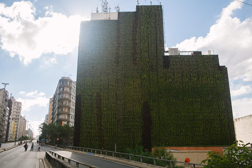

约30年前,法国景观设计师Patrick Blanc率先在巴黎建造了许多立体花园,这种做法在后来风靡世界。立体花园主要是通过有一定湿度的立体结构,然后在建筑的外立面上种植植物,从而有效控制建筑内部的温度与湿度,同时增加城市绿化系统的设施。
Blanc的这项壮举基于充分了解了自然对城市的重要性,并且意识到绿色空间的价值,以及它们对社会、环境和城市的巨大贡献。
新加坡、伦敦和圣保罗都将这种技术广泛运用于城市之中,目的是提升城市居民的生活品质。
About thirty years ago, French landscape architect Patrick Blanc became a pioneer in the implementation of vertical gardens in Paris, and later in other cities around the world. Through the creation of vertical structures capable nourishing plant species, these systems allow species to grow on the facades of buildings, considerably reducing a structure's internal temperature and allowing the expansion of green areas to new (vertical) territories within the city.

在圣保罗,由Guil Blanche于2013年成立的Movimento 90°已负责建设约16000平方米的立体绿化区域,尤其是在Avenida 23 de Maio,这里的绿化面积高达10950平方米,而沿Elevado João Goulart的一些建筑的山墙部分同样有约4180平方米的立体绿化。
事实证明,立体绿化能够为环境带来多项效益,例如废弃物的循环利用、减少建筑能耗和净化空气,同时还能够回收雨水,并将这些水进行植物灌溉的再利用。
In the city of São Paulo, for example, the Movimento 90° founded in 2013 by Guil Blanche is already responsible for the construction of about 16,000 square meters of green area in a series of vertical gardens throughout the city, especially on Avenida 23 de Maio, where there is 10,950 square meters of green space, and in the gables of buildings along the Elevado João Goulart, popularly known like "Minhocão," where there is 4,180 square meters.
In practice, vertical gardens provide a whole series of environmental benefits, such as solid residue recycling, heat reduction inside buildings, partial air clean-up through CO2 capture, and the ability to reuse captured rainwater, which is used for the irrigation of the plants.

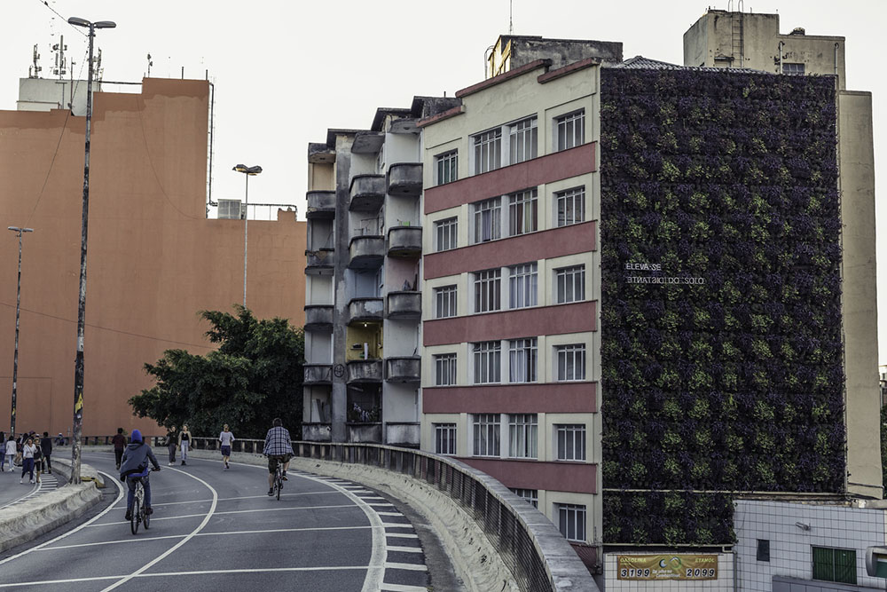

教程:手把手带你打造立体花园第3张图片
© Felipe Gabriel Via Movimento 90°. ImageEdifício Santos

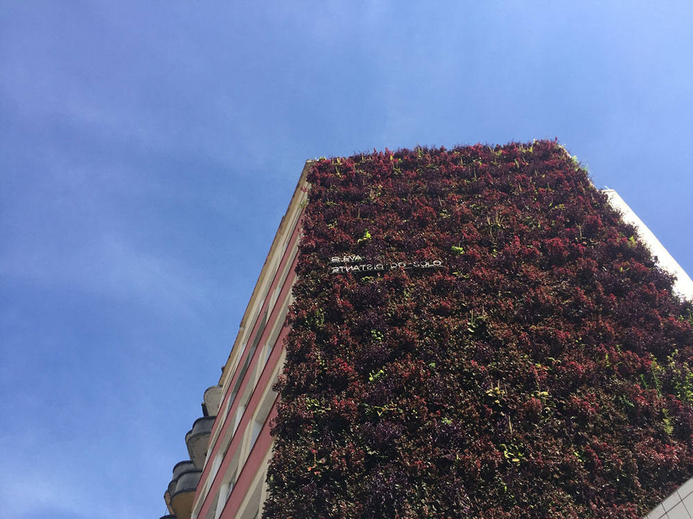

教程:手把手带你打造立体花园第4张图片
© Felipe Gabriel Via Movimento 90°. ImageEdifício Santa Cruz

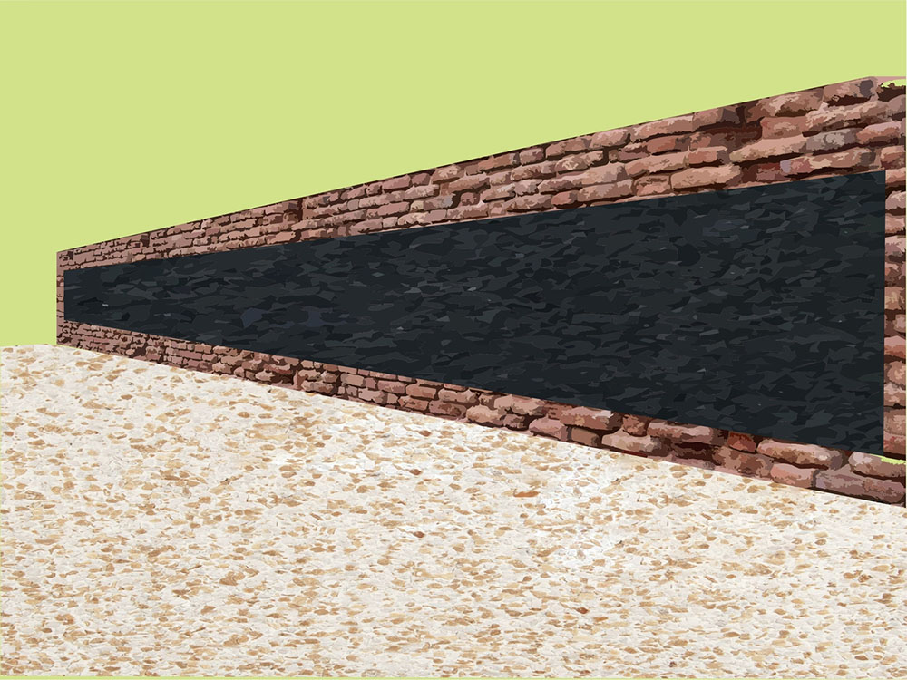

1、首先将一个毛毡板剪成多个长方形。可以根据所选择的植物种类来进行剪裁,但尺寸最好控制在25厘米至40厘米之间。
1. Begin by cutting one of the felt blankets into rectangles. The measurements are variable, according to the species chosen to compose the vertical garden, but should be between 25 and 40 centimeters.

2、将剪好的方形毛毡与第二片毛毡缝在一起,此时最好运用粗线来缝制,因为后期需要承受土壤与植物的重量。
3、将毛毡板与刚性薄片相连接,再通过防水隔板将薄片固定到墙上,这样水分就不会渗入建筑墙体之中。
2. Fasten the cutouts to the second blanket by sewing them together. Use thick thread or string, preferably, since the bags will be required to support earth and plants.
3. Attach the high-density felt panel to the rigid sheet. Then, attach the panel created to the wall using the spacers so that water cannot infiltrate the wall.

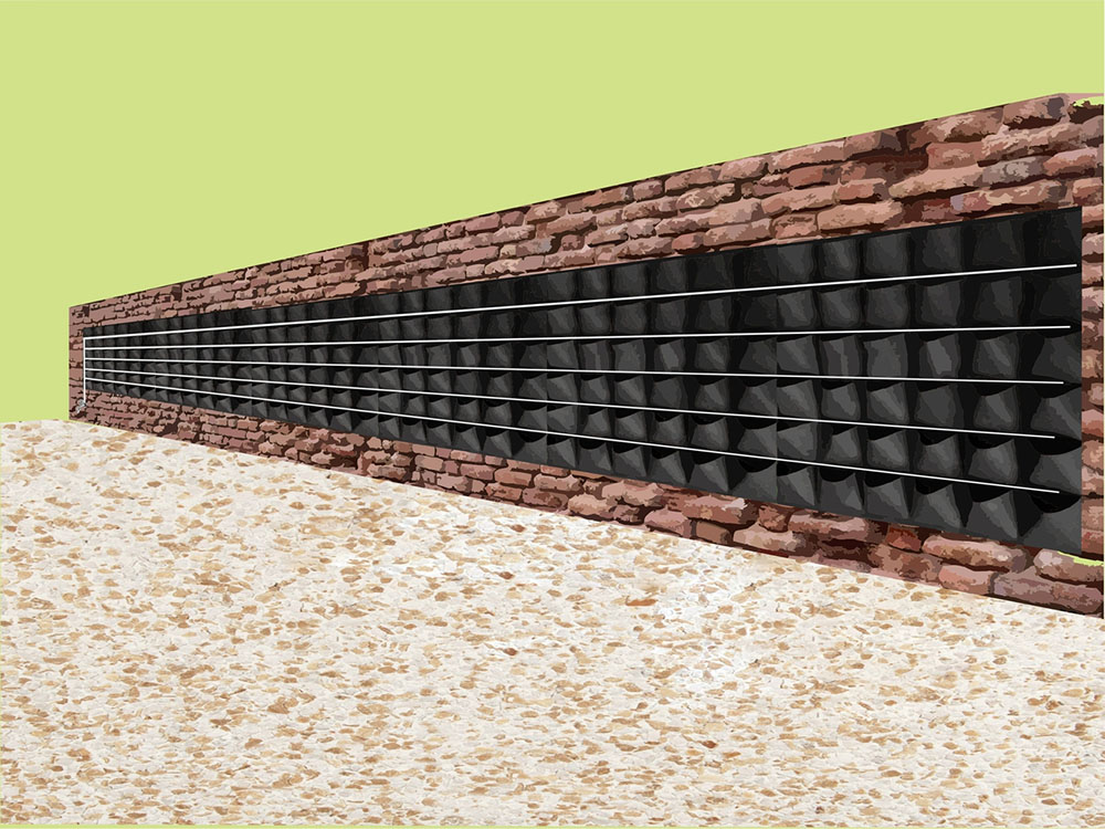

4、安装完成后,将软管与软管接合器相连接,需要切记的是每隔25厘米或30厘米为软管钻上线性排列的小孔,这样能够更加均匀地灌溉植物。在出水口连接定时器,并为放水设置好规定时间段。
4. After the sheet is installed, connect the hoses together with the couplers. Remember that the hoses must be drilled every 25 or 30 centimeters and arranged in a linear fashion, to irrigate the plants evenly. Connect the timer to the water outlet, and set it to release the water at set time intervals.

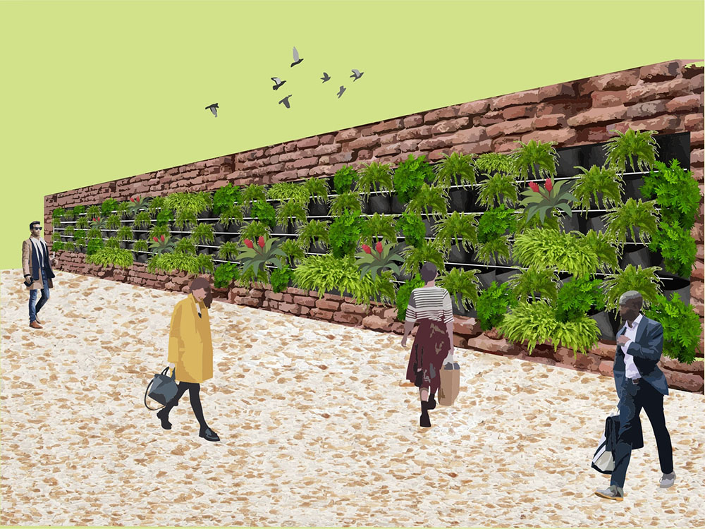

5、在制作好的毛毡袋中放入土壤和植物幼苗。
之后,这些植物将开始自己生长,几个月后整面墙都将变得如覆盖了植被层般地郁郁葱葱。
5. Insert fertilized soil and the selected plant species one by one, in each of the felt bags.
Off you go! Your plants will begin to grow, and in months, will fill the entire wall, making it appear like a homogeneous layer of vegetation.

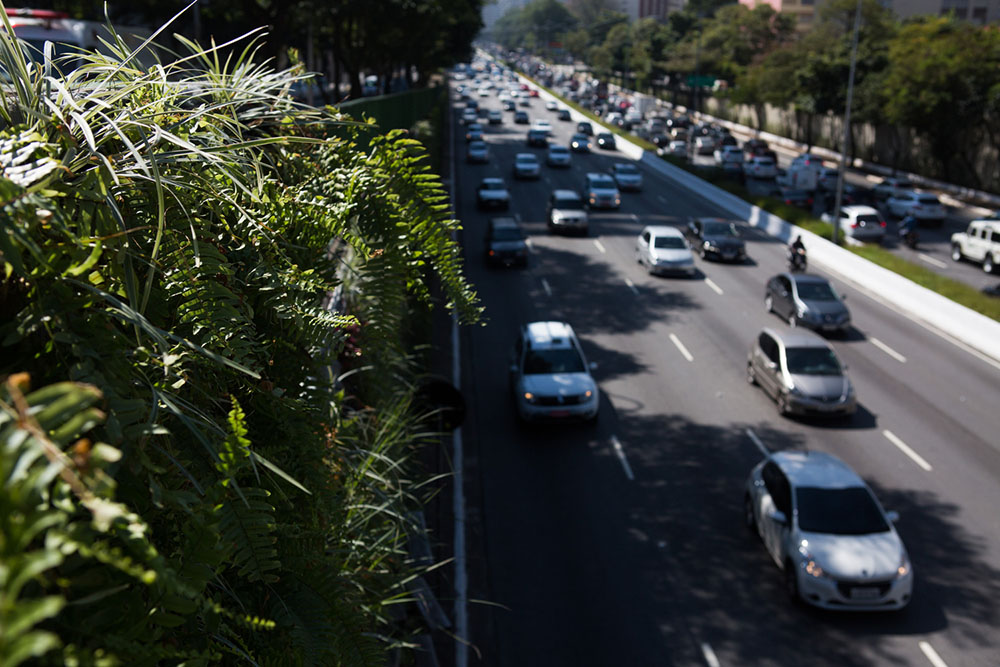

教程:手把手带你打造立体花园第9张图片
© Helena Wolfenson Via Movimento 90°. ImageAvenida 23 de Maio
