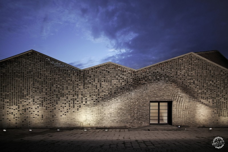

▽ 在破败不堪老建筑的基础上完成的改造,An exhibition space renovated from a dilapidated building
上海池社第1张图片

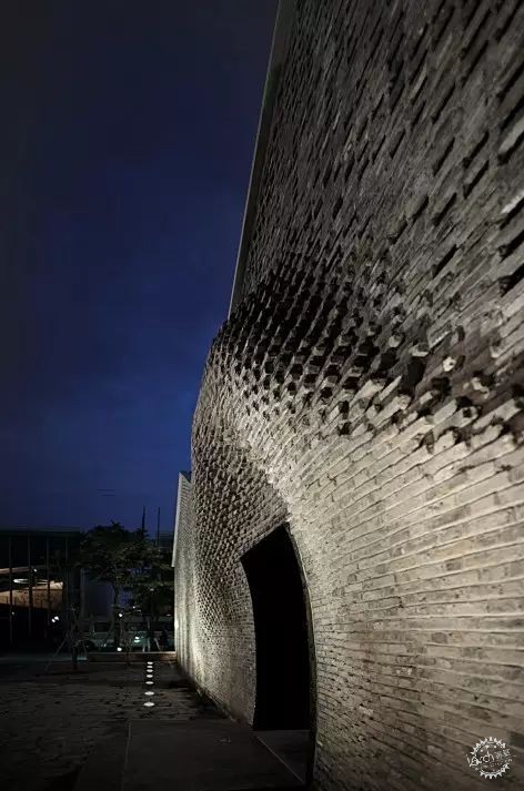

▽ 青砖在入口位置形成了褶皱肌理, The entrance is curled up a lit bit and create a wrinkle wall texture
上海池社第2张图片
上海池社第3张图片

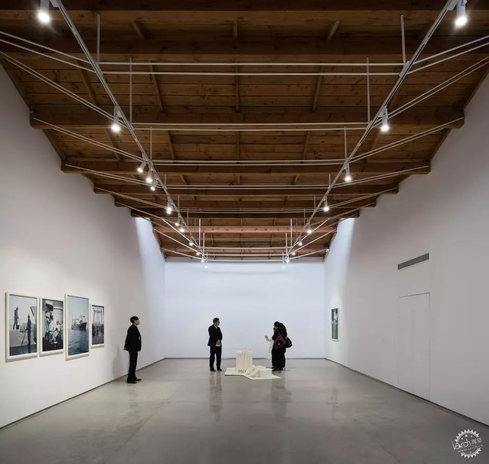

我们保留了原有建筑的外围护墙体,进行基本的性能改善和结构加固后获得最大化的展厅空间;同时在不影响整个园区空间感受的情况下局部将建筑屋顶抬高,获得一处可以享受完整天空的夹层休息空间;屋面结构替换为更加轻质有效,同时富有温暖气息的张拉弦木结构屋顶,并局部抬高获得表达气候时辰的北侧天光。建筑外围采用了和老建筑相协调的青砖形成其面向园区的主要界面,而入口位置的轻轻一掀,形成的褶皱肌理既形成了房子最让人印象深刻的形式处理,又表现了建筑物的基本表情:既背靠传统而又表达当下文化态势的一种身位。
We retained the initial exterior walls, followed by the elementary performance enhancement and structure reinforcement, in order to attain the maximum exhibition space. Therefore, under the condition of maintaining the space perception of the whole artistic park, part of the roof has been elevated in order to create an interlayer space, where people could enjoy the intact sky view. Furthermore, the roofing structure has been replaced by a lightweight and more efficient tensioning string wood structure, and part of them is lifted to obtain the skylight indicating the climate change, which presents a sense of harmony. On the other hand, the greygreen bricks coordinated with this ancient building have been applied on the exterior part located on the main interface towards the park. When the wall in the entrance is curled up a lit bit, this generated wrinkle wall texture becomes the impressive part of the form manipulation, which represents the architectural expressions as well, that is, a status that embodies current cultural trends based on tradition.

▽ 富有温暖气息的张拉弦木结构屋顶,The tensioning string wood structure
上海池社第5张图片

为了完成这样一个传统工艺无法精确实现的砌筑方式,我们借助了一造科技(Fab-Union)专项研发的机器臂砌筑的工艺,实现了先进数字化施工技术在现场完成真实建造的首次尝试。池舍的外墙,将回收自老建筑的古老灰砖与先进的机械臂在场建设工艺相结合,采用一个具有张力的曲面形态,表现池舍的勃勃生机。
In order to complete such a masonry process that cannot be precisely achieved by traditional technology, we applied the robotic masonry fabrication technique by Fab-Union, which accomplishes the first endeavor to utilize the advanced digital fabrication technology to construct on site. The external walls of the Chi community were built by the recycled greygreen bricks from the old building and constracted with the help of the advanced technology of mechanical arm, which generates a cambered surface morphology, showing the vitality of the Chi community.
▽ 具有张力的曲面形态,The cambered surface morphology
上海池社第9张图片
上海池社第10张图片
机械臂砖构集合装备的精准定位、工匠对砂浆与砖块精心处理,使砖构这一古老材料能够适应新的时代要求,实现了对设计模型的完整呈现。老砖的残破与曲墙的张扬相得益彰,将人与砖,机器与建构,设计与文化的故事,在夕阳下外墙的阴影中继续讲述。
The precise positioning of the integrated equipment of robotic masonry fabrication technique and the construction elaborately to the mortar and bricks by the craftsmen make this ancient material, brick, be able to meet the requirements in the new era, and realize the presentation of the design model consummately. The dilapidation of these old bricks coordinated with the stretch display of the curving walls are narrating a story of people and bricks, machines and construction, design and culture, which will be spread permanently in the shadows of the external walls under the setting sun.
