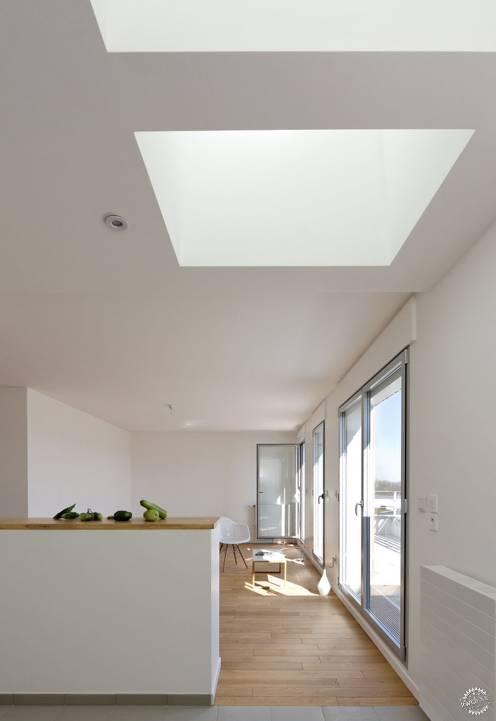

面向南边的大型公寓配备了具有生物气候特性的凉廊。每一个起居室都开向这些半室外空间,并且都拥有直接面向花园的景观视野。
这个具有生物气候特性的凉廊拥有一个双层防辐射装配式的玻璃顶,在夏天,这些玻璃顶能够被充分地开启。
拥有这样的凉廊的好处是,它能够在一年四季调节建筑小气候。
与此同时,作为一个温室,它们使得该公寓能够以较低的成本来获得舒适的热环境,并且也能够有效地减少取暖的费用。
安装百叶窗以及在花园中种植落叶植物同样也有助于凉廊在夏天控制室内的温度。
The large apartments facing south are equipped with bioclimatic loggias. Each living room open onto these semi outdoor spaces and on a bay giving directly on the garden.
The bioclimatic loggias are closed by a double low-emmissivity glazing wich can be generously opened in summer.
They have the benefit of being used as natural temperature regulator in winter as in summer.
Operating as a greenhouse, they allow the control at low cost of the thermal comfort of the flats and greatly reduce heating expenses.
The installation of blinds and deciduous trees in the garden also   control the temperature of these loggias in summer.
