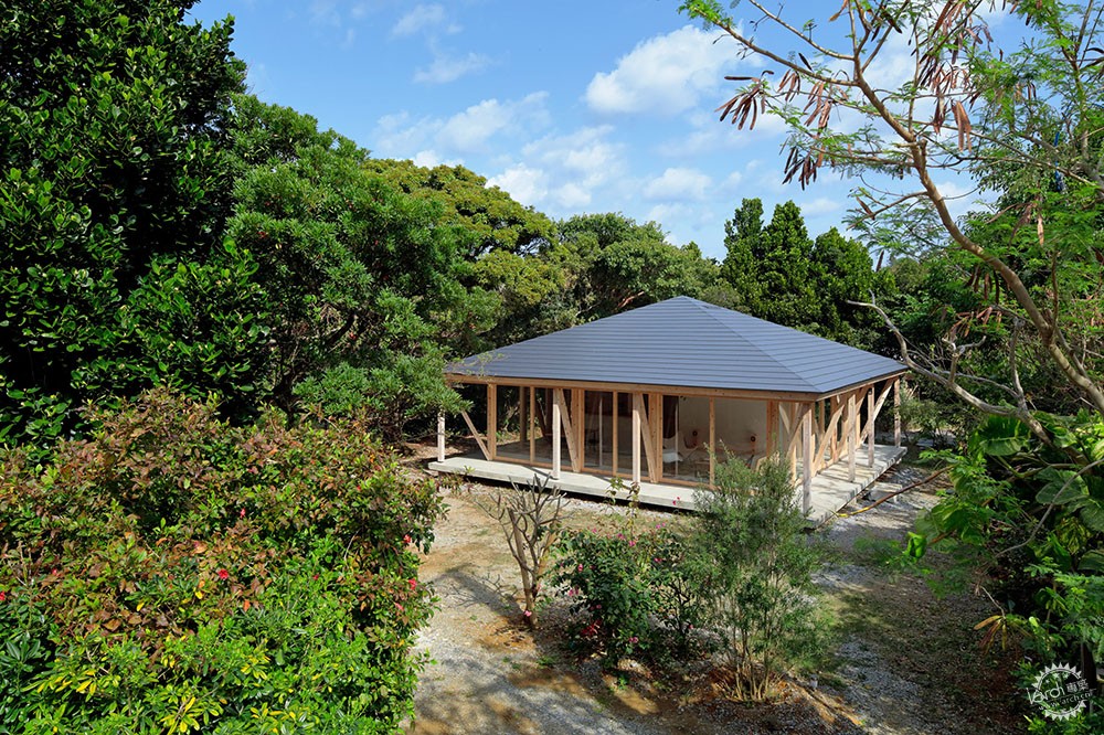

东京ISSHO建筑工作室设计了这座Shinminka住宅,项目位于冲绳岛北部的Motobu,一个被树木和植被环绕的地方。
建筑师力图拓展对冲绳传统住宅的当代解读,这种房屋通常具有支撑平屋顶的木结构,延伸到创造出遮阴的门廊。
Tokyo studio ISSHO Architects designed the Shinminka house for a plot surrounded by trees and vegetation in Motobu, on the northern part of Okinawa Island.
The architects sought to develop a contemporary interpretation of traditional Okinawan housing, which typically features a timber structure supporting a tiled roof that extends to create a shaded porch.

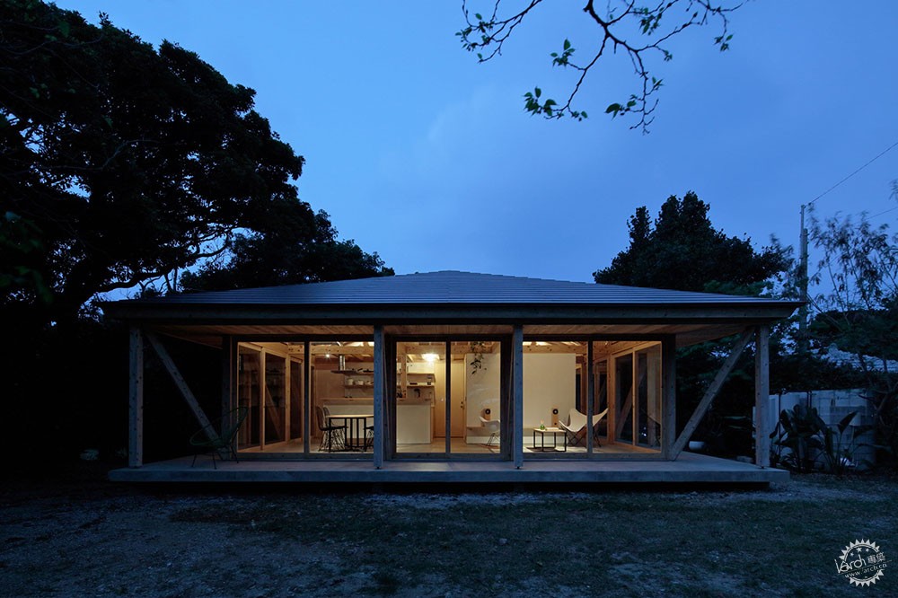

另一个重要考虑因素是岛上的热带气候,以及需要抵御冲绳定期发生的台风。
ISSHO建筑工作室设计了一种新的施工技术,提供必要的强度,同时使墙壁在结构上独立。
“通常要确保横向强度,支撑平行于墙壁放置,”Vera说。“但是这种设计会使通风和开放性受到限制。”
“我的想法是将支架径向向外,与建筑物的外柱连接。”
Another key consideration was the island's tropical climate and the need to withstand the typhoons that occur regularly in Okinawa.
ISSHO Architects devised a new construction technique that provides the necessary strength while enabling the walls to be structurally independent.
"Usually to ensure lateral strength, braces are placed parallel to the walls," said Vera. "But by designing this way ventilation and openness will be limited."
"My idea was to place braces radially toward the outside, connecting to outer columns of the building."

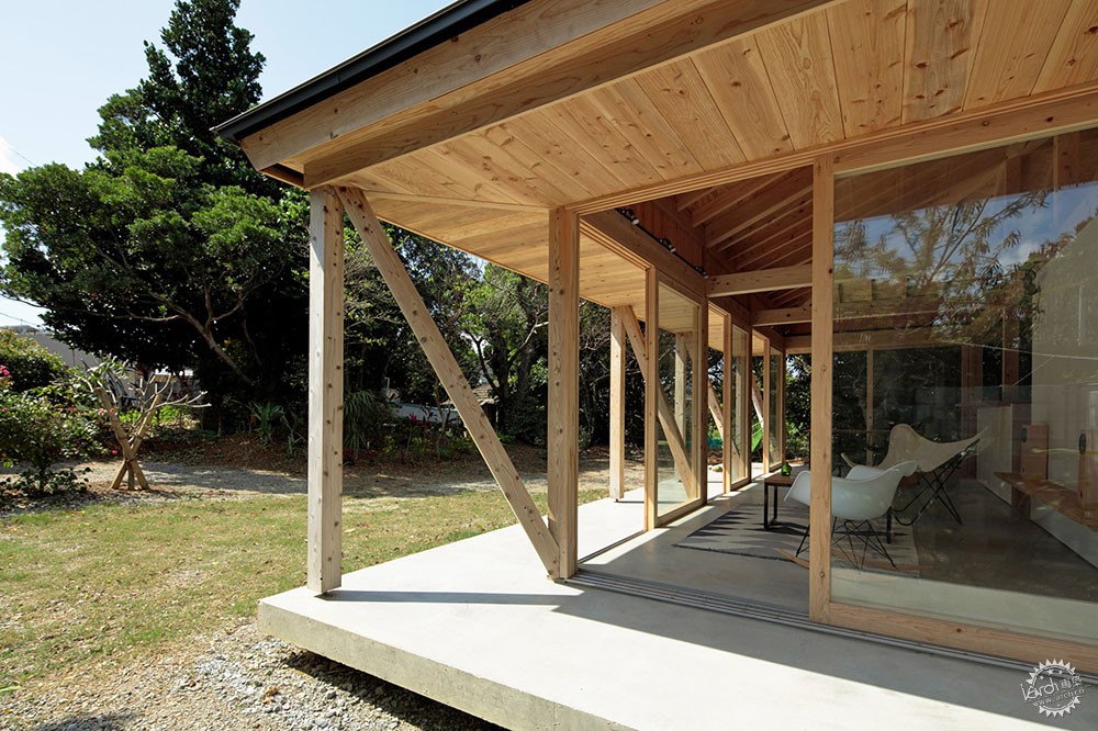

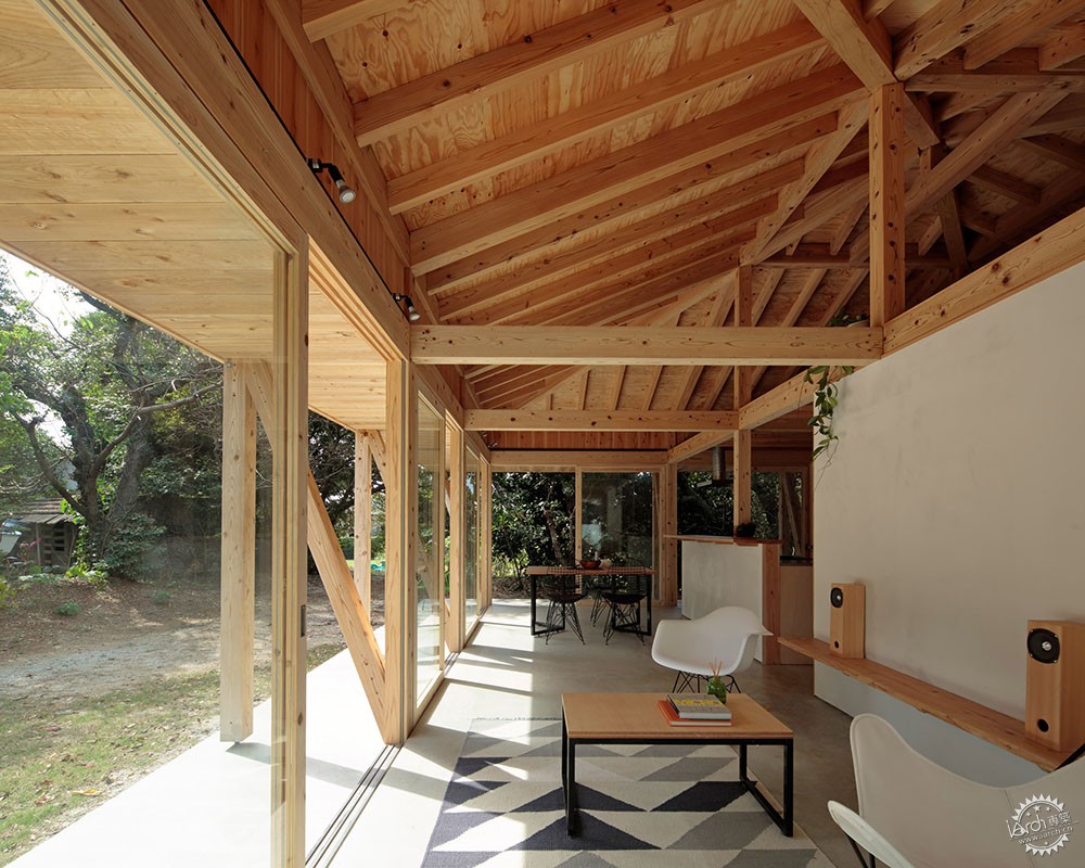

瞧瞧建筑师是怎样打破常规,用结构打败台风的|冲绳岛抗台风住宅第6张图片

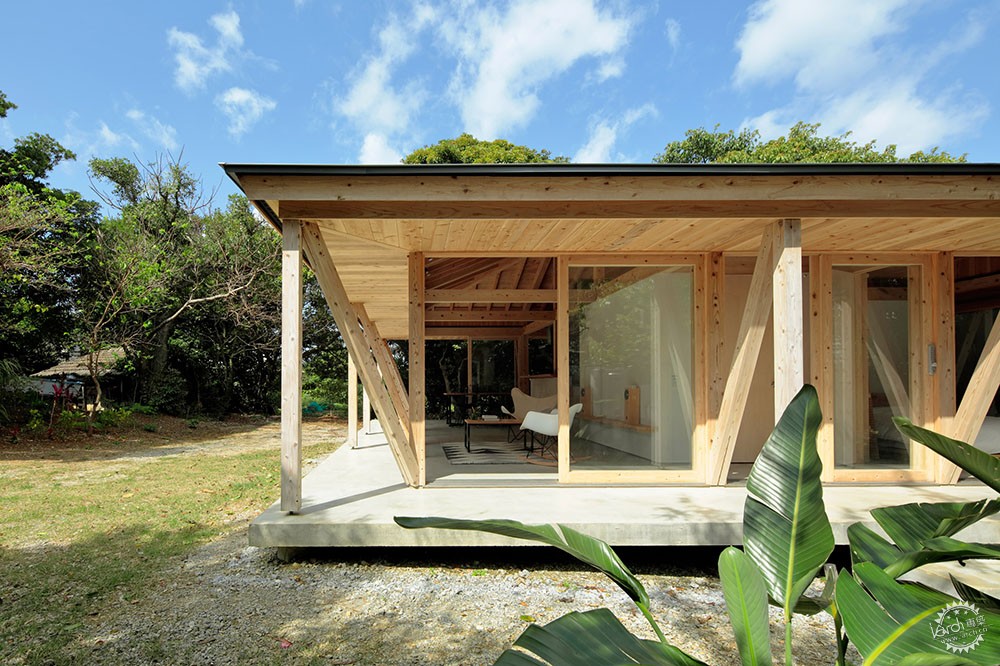

布置在建筑边缘的12个对角支撑梁和立柱形成一个坚固的木结构,能承受由台风引起的风荷载。
大屋檐延伸与房屋周边的柱子结合,提供保持内部空间凉爽所需的阴凉处。
The 12 diagonal bracing beams and columns arranged around the edges of the building form a robust wooden structure capable of withstanding the wind load inflicted by a typhoon.
Large eaves extend to meet the columns around the house's perimeter, providing the shade required to keep the interior spaces cool.
瞧瞧建筑师是怎样打破常规,用结构打败台风的|冲绳岛抗台风住宅第7张图片

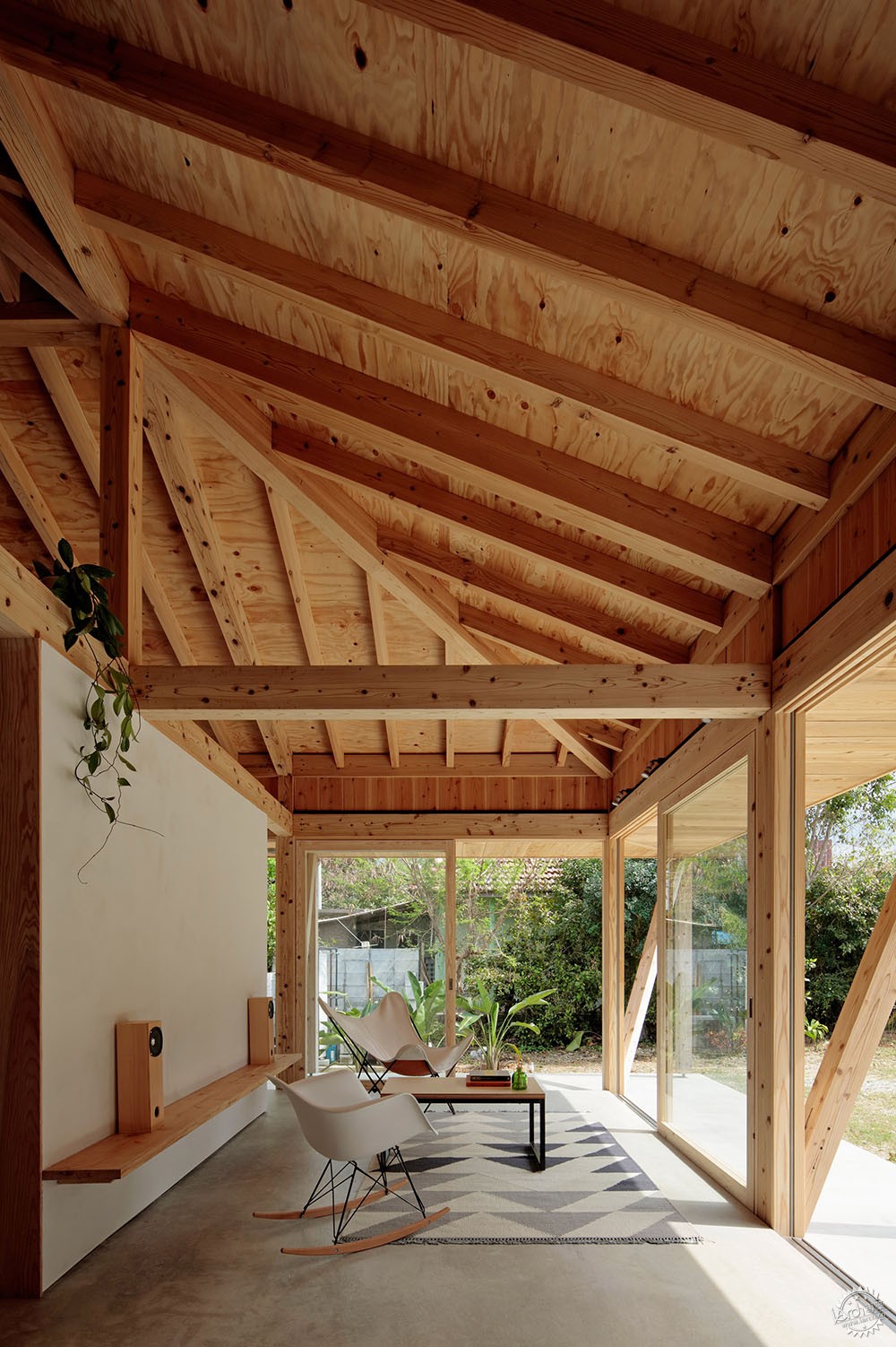

通过否定墙壁的结构要求,这些表面可以完全由玻璃组成,并提供充足地自然通风。
在每一侧垂直于墙壁的结构梁位置,可以促进房屋内任何地方对周围环境的直观观察。
By negating the structural requirements of the walls, these surfaces could be fully glazed and incorporate sliding sections that provide plenty of natural ventilation.
The positioning of the structural beams perpendicular to the walls on every side promotes direct views of the surroundings from anywhere inside the house.

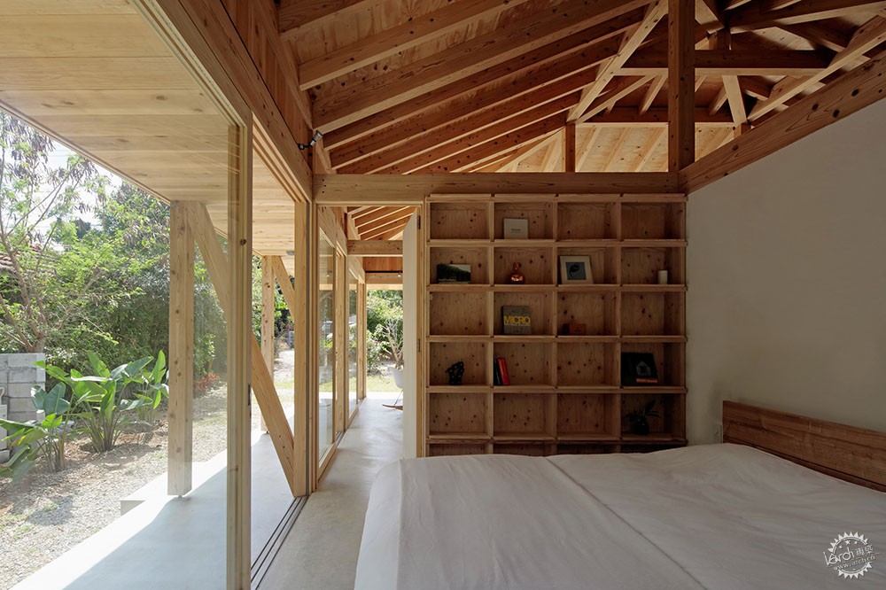

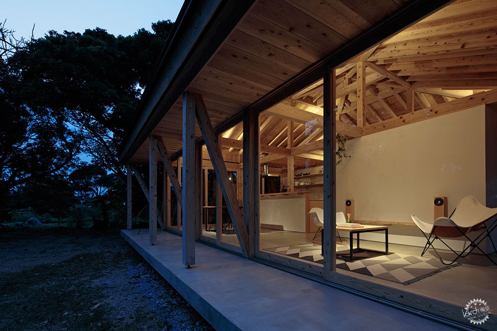

滑动的墙壁允许内部的生活区域朝建筑物周边遮阴的门廊开放。

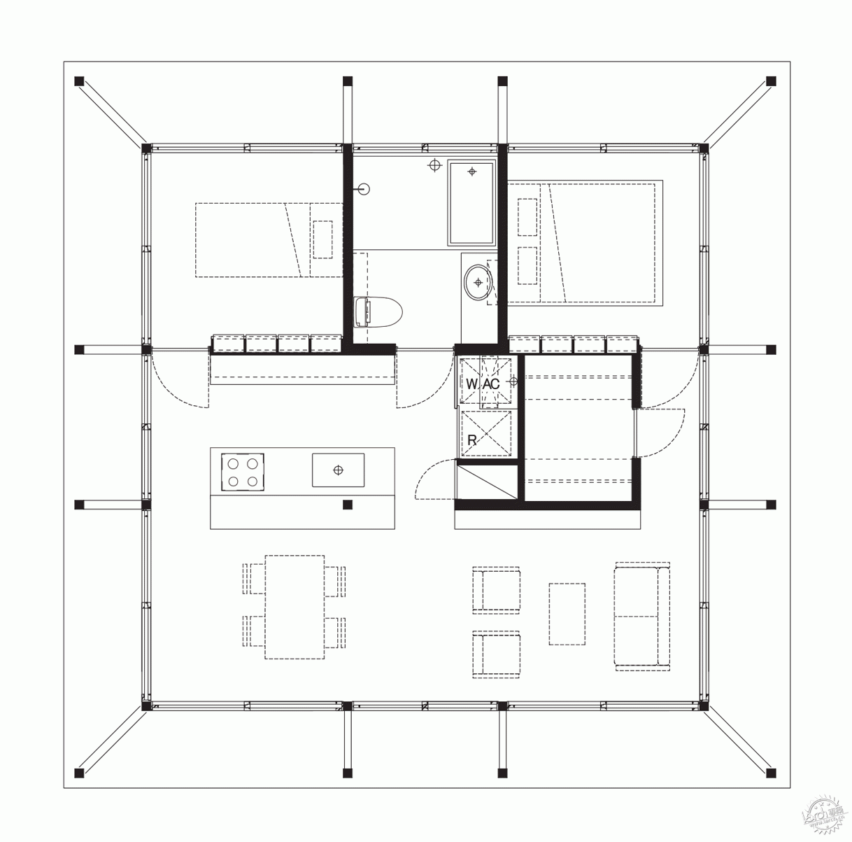

生活和用餐区沿着房子的一边延伸,一对卧室通向对面的门廊。
The sliding walls allow the internal living areas to be opened up to the shaded porches that line the perimeter of the building.
A living and dining area extends along one side of the house, with a pair of bedrooms opening onto the porch on the opposite side.

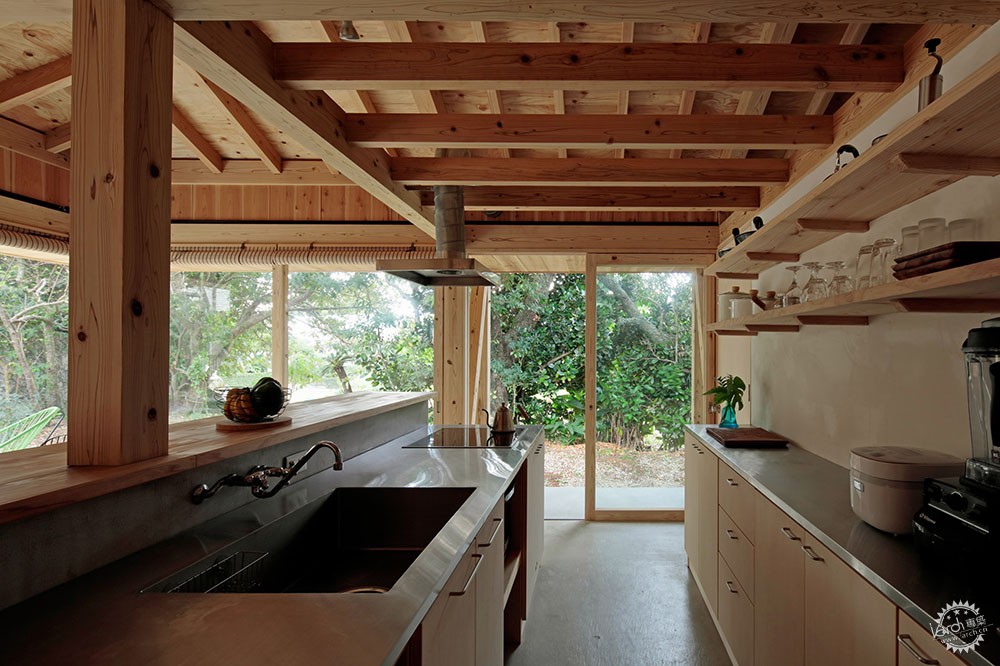

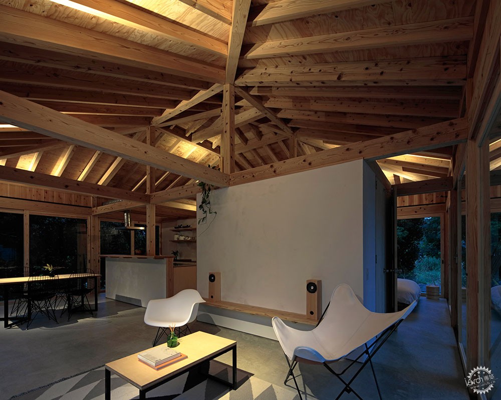

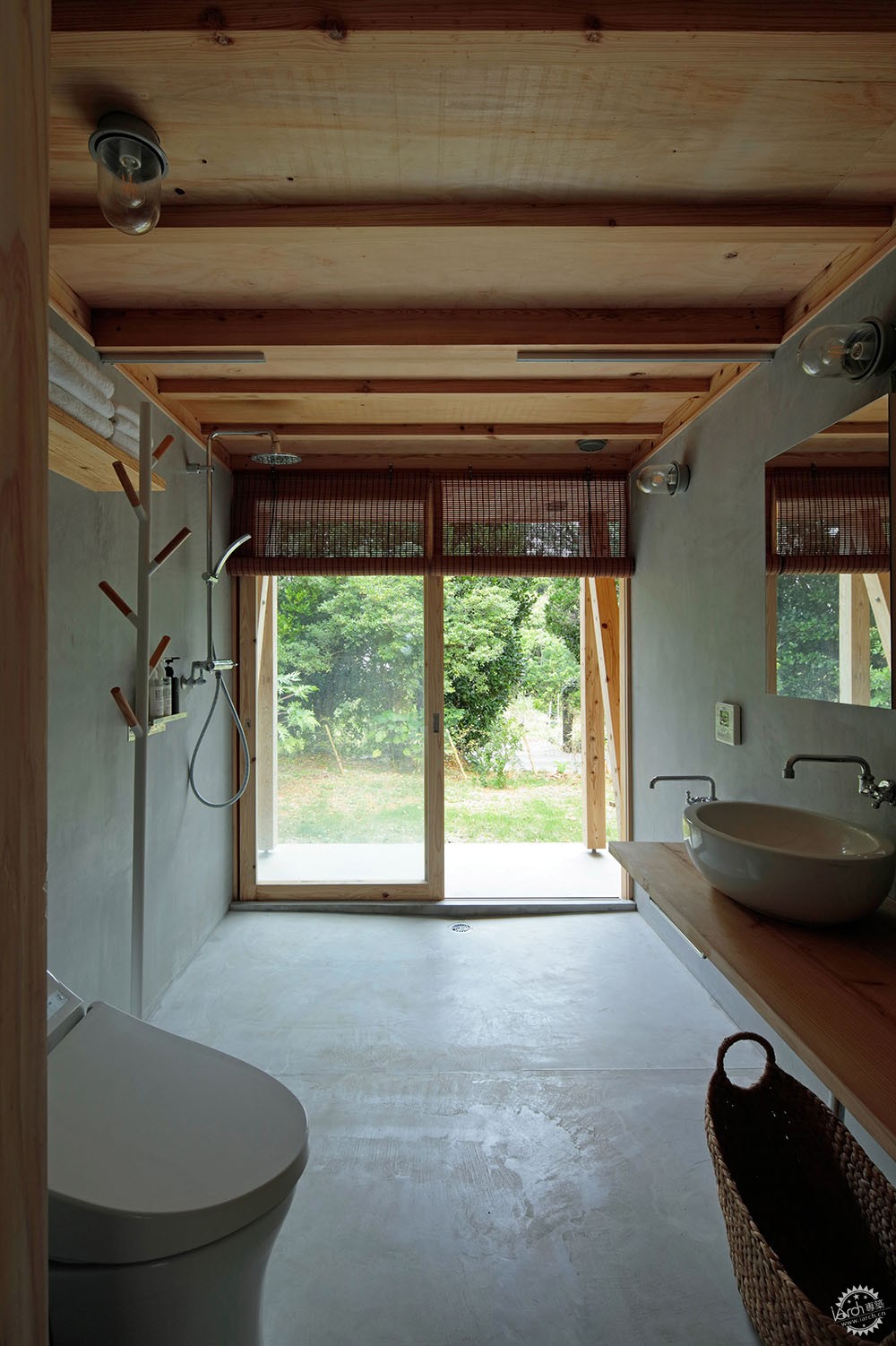

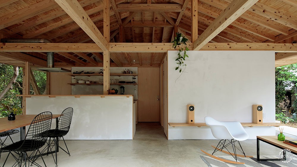

建筑中心是厨房和衣柜空间,两间卧室之间设有一个厕所和淋浴间。

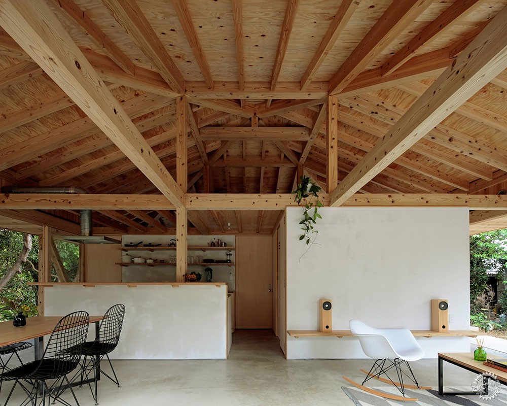

木框架和椽子裸露着,以强调建筑的优雅,增强内部空间的高度感。
摄影为Koichi Torimura。
At the centre is the kitchen and a closet space, with a toilet and shower room situated between the two bedrooms.
The timber framework and rafters are left exposed to emphasise the elegant construction and enhance the sense of height within the interior spaces.

平面图/plan

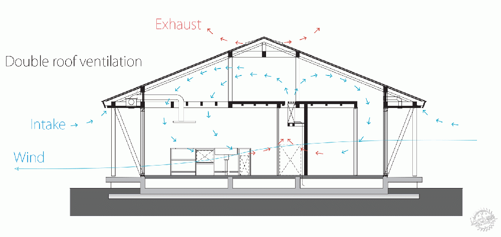

瞧瞧建筑师是怎样打破常规,用结构打败台风的|冲绳岛抗台风住宅第15张图片
剖面图/section
