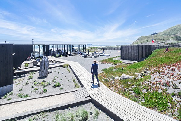

在画中才能见到的完美的休憩场地,我竟在现实看到了!第2张图片
© Sergio Pirrone

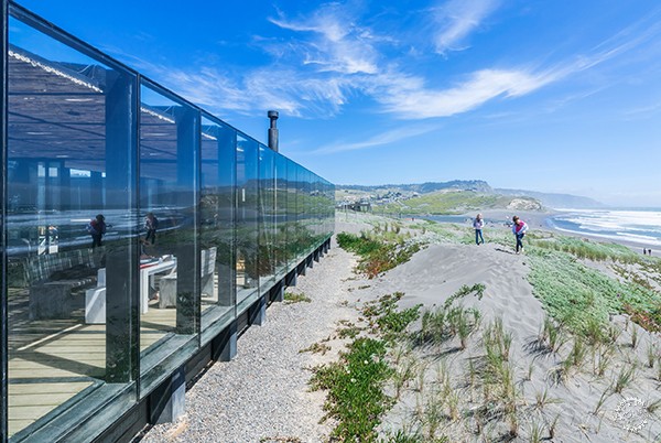

在画中才能见到的完美的休憩场地,我竟在现实看到了!第3张图片
© Sergio Pirrone
项目构思是在这个非常严峻和极端寒冷的环境中寻找一个遮蔽之处。该项目实现了三个气候条件:100%封闭的内部,额外的调节方式和开放的空间。
The idea seeks a shelter in this climate that is very austere, extreme, with strong, cold winds. The project achieved three climates: inside it is 100% closed, another intermediate and another open.

这是一个海滨休憩处,产生连接前面的后院,并且骨架状的结构允许居住。可以为陪同的人和那些不参加运动的人提供空间。
It is a waterfront retreat generating a backyard connected to the front thanks to the skeleton-like structure which allows shelter. Allowing to have a space for people who accompany and do not participate in the wind sport.
