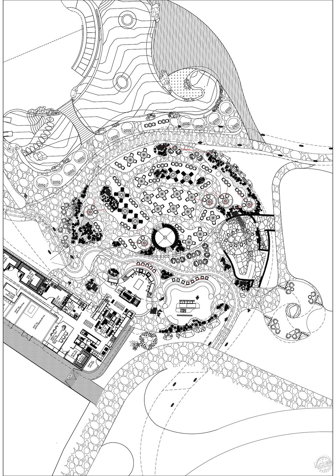

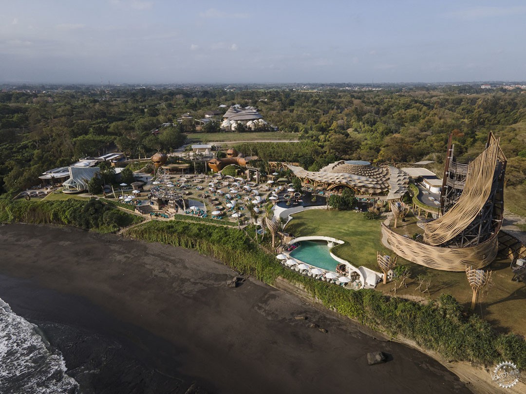

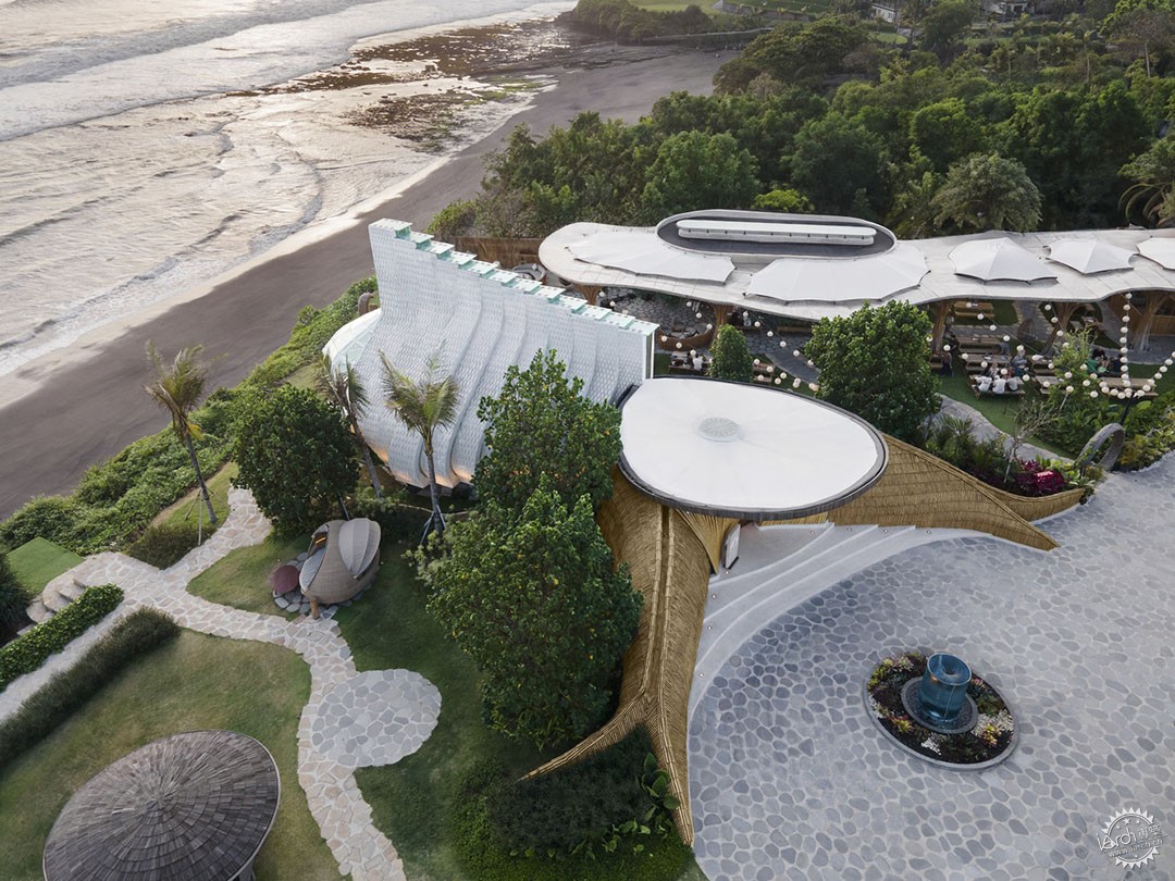

本案位于巴厘岛Nanyyi 海滩悬崖边。露娜海滩俱乐部(Luna Beach Club)打造了一个不一样的活动场所,该项目集活动、餐饮、艺术、所有享乐主义项目于一体,让人们拥有轻松的体验,这个独特的地标建筑俯瞰着大海。总体规划以一系列突破性的自然建筑为特色,按照斐波那契序列构思创建了活动场所,将整个场地的动线联系起来。
Sitting on the cliffside of Nyanyi Beach, Inside Nuanu Creative City, Tabanan, Bali. Luna Beach Club delivered on the opportunity to create a standout destination for events, dining, arts, and holistic hedonism combined with playful relaxation, where unique iconic architecture overlooks the ocean. The master plan features a series of groundbreaking naturally inspired buildings that create a hub of activity that is conceived according to Fibonacci sequences that connect flow and movement throughout the site.

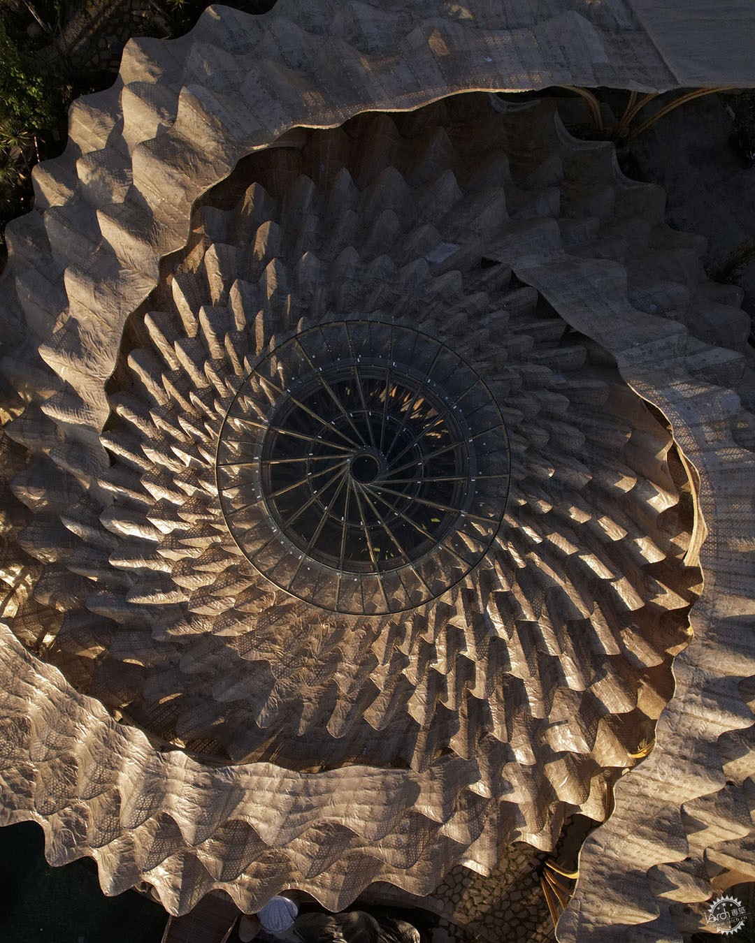

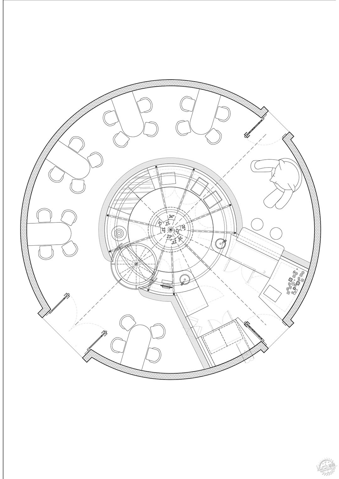

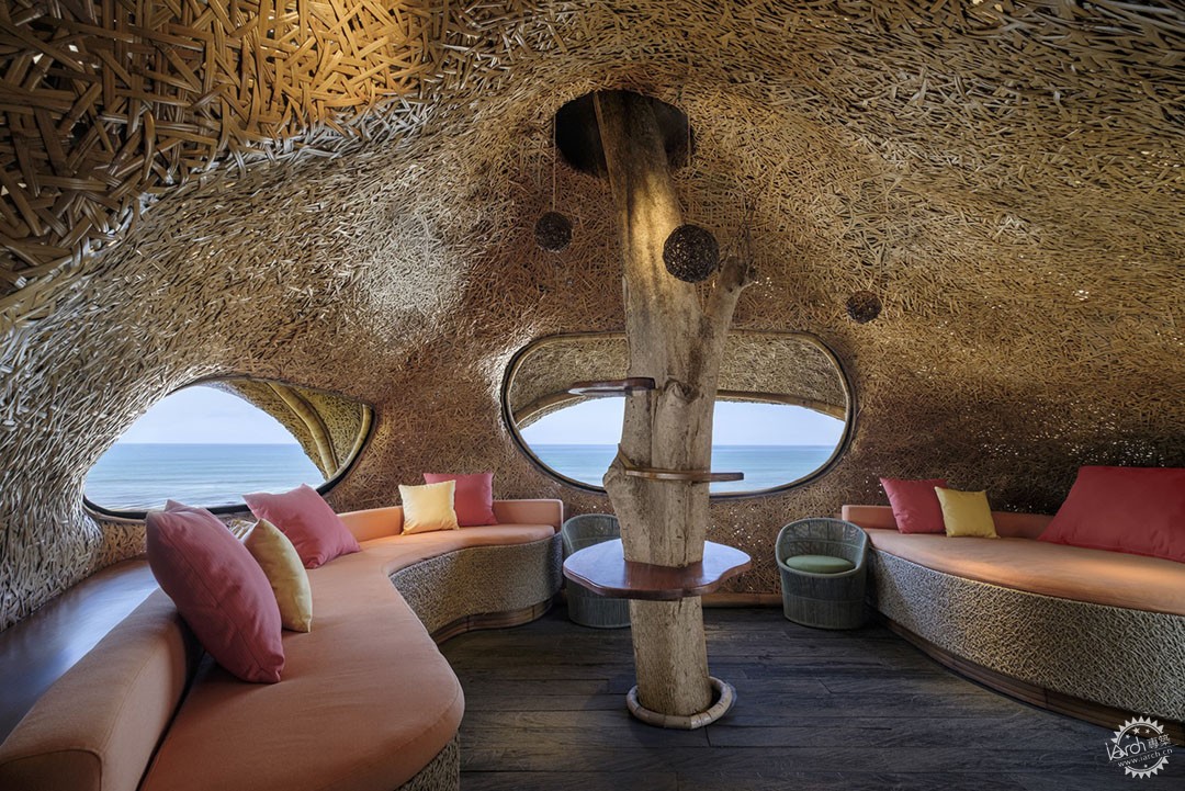

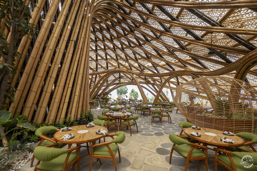

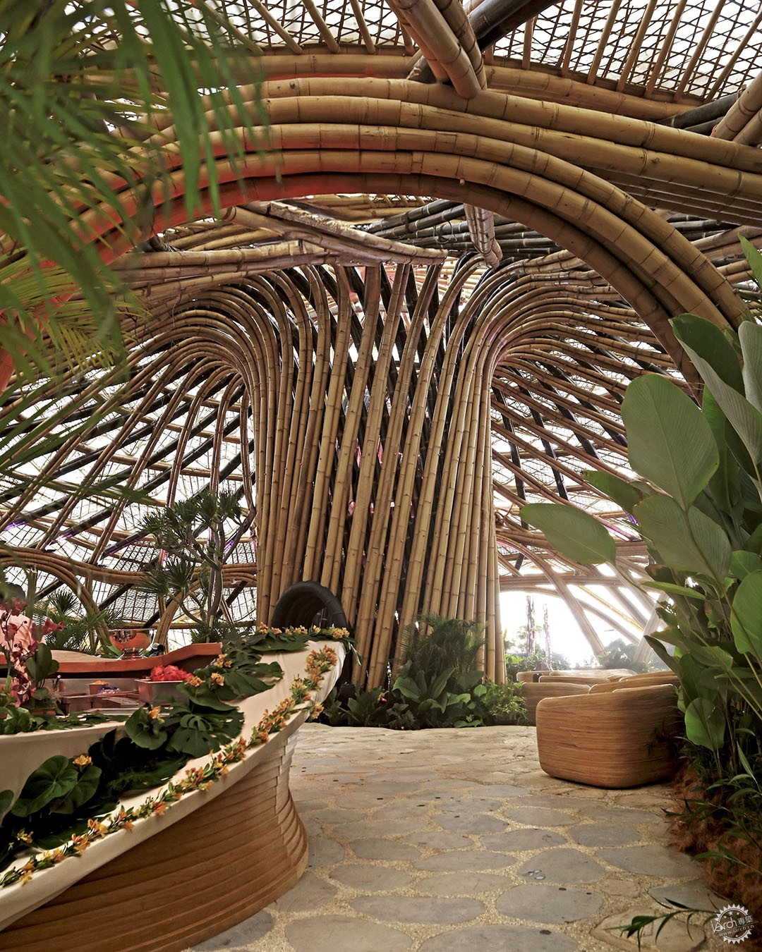

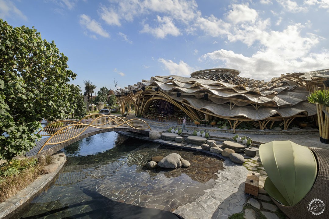

该项目的设计任务是打造一个极具标志性的海滩俱乐部和活动场所,能够激发人们的惊叹、灵感和冒险精神。综合体的核心是沙滩俱乐部,它的外观呈漩涡状,由竹子和玄武岩建造而成,是主要的就餐区域,上面覆盖着多层编织帘,使室内在白天明亮舒适,夜晚灯火通明。总体规划将阳刚(TWG 塔)和阴柔(主餐厅和餐厅中心)元素相结合,一个极具吸引力的开放空间,除此之外,还有一系列节点,比如仪式建筑、泻湖泳池、通往洞穴泳池的滑梯、俱乐部、带隧道的高架吊舱和糖果酒吧穹顶、魔法花园以及户外的饮品区和烧烤场。
The brief was to a highly iconic beach club and events destination that would create wonderment, inspiration, and a sense of adventure. Central to the complex is the main beach club which appears as a vortex-like structure, built of bamboo and basalt which serves as the main restaurant area, and is covered with layers of woven shades to keep the interior comfortably bright during the daytime and illuminated at night. The masterplan incorporated masculine (TWG tower) and feminine (main dining and restaurant hub) along with a main attractive open space, plus an array of other destinations within such as the ceremonial building, lagoon pool, and slide-down to a cave pool, and club, elevated pods with tunnels, platform nets and a candy bar dome, enchanted gardens, and an outdoor beverage garden and grill.

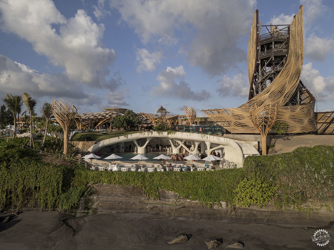

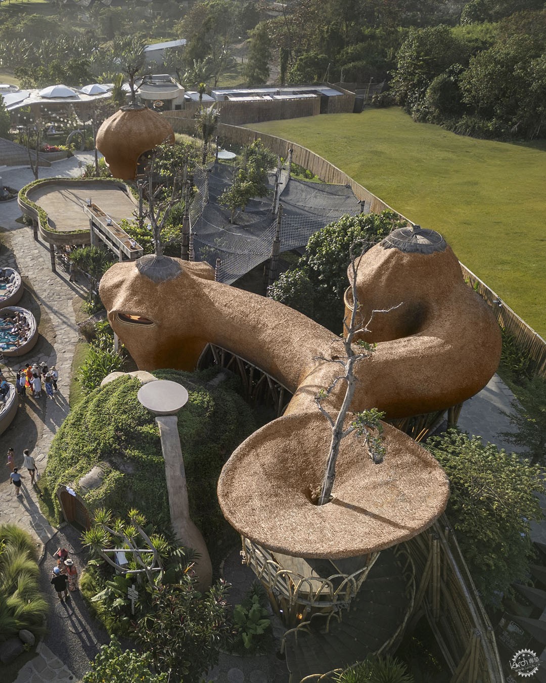

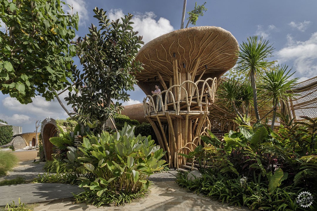

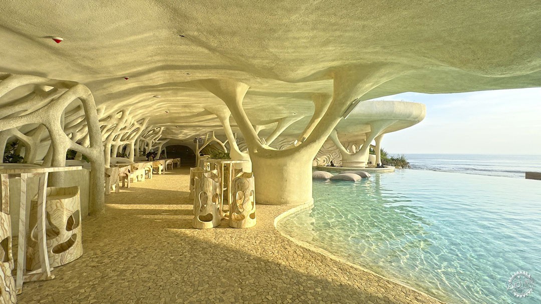

与餐厅相连的是一个面朝大海的泻湖式泳池,泳池通往地下的 “乌托邦洞穴俱乐部”,还有一条 11 米长的惊险滑道。在森林区域,由回收材料制成的高架吊舱,与树林交织在一起,构建了与周围的自然环境融合的有趣空间,设计师还设置了网、隧道和攀爬路线。“伊甸园”在一个僻静的角落,是举行冥想、婚礼和瑜伽等仪式活动的宁静空间。
Connected to the restaurant is a lagoon-style pool facing the sea, into an underground 'Utopia Cave Club' with a thrilling 11m river slide. Adjacent to this in the forest area, elevated pods made of recycled materials intertwine with the trees, offering playful spaces like nets, tunnels, and climbing routes that blend with the natural surroundings. 'Elysium' located in a secluded corner, serves as a serene space for ceremonial events such as meditation, weddings, and yoga.

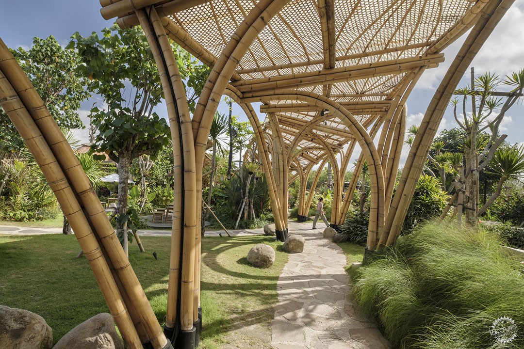

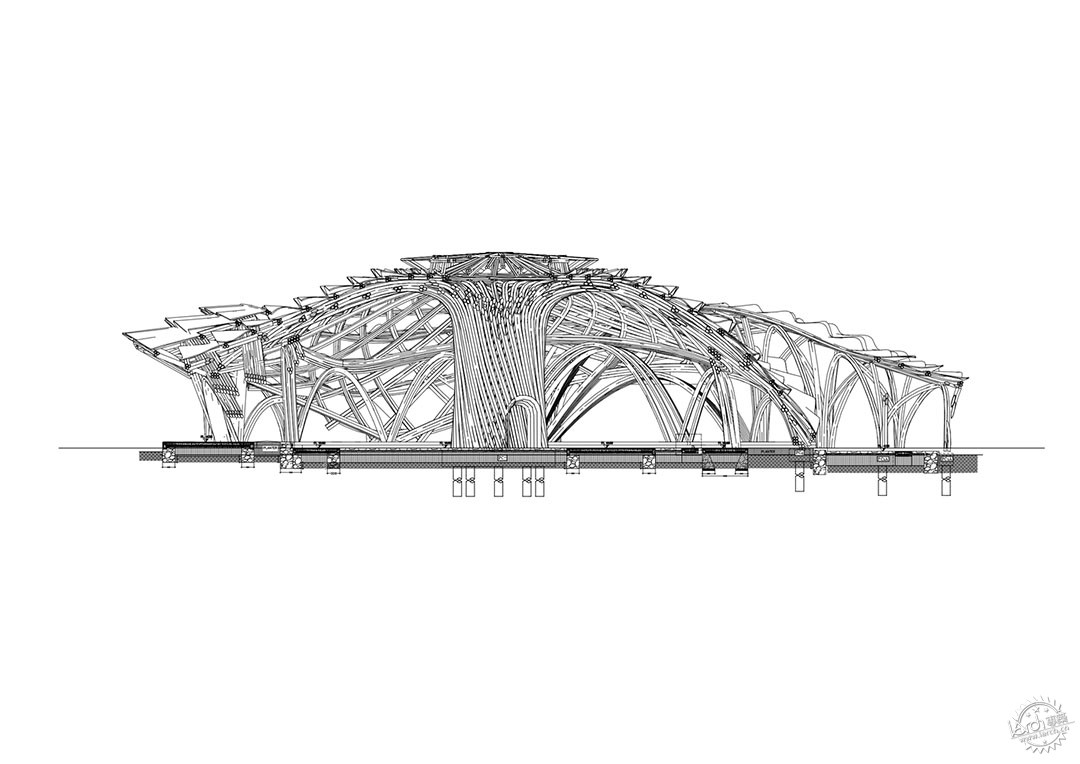

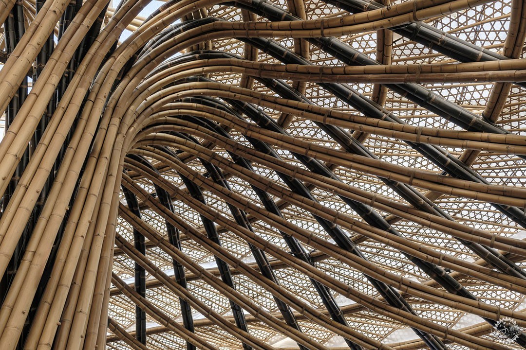

由于整个建筑采用了复杂的几何结构,还结合了具有前瞻性的生态友好型材料,因此必须进行大量的研究和设计工作。这就需要投入大量精力进行测试、原型设计、建立信心、培训施工团队,使他们能够学习新的建筑技术,进行必要的质量控制。通过一系列的工作,成功地创造了世界上第一座使用竹子和玄武岩组合结构系统的建筑。使这个系统在沙滩俱乐部的双曲面结构中得以体现,半透明屋顶材料也是首次作为膜系统广泛使用。
With such complex geometry used throughout combined with forward-thinking ecologically friendly materials, there was a huge degree of research and design that had to be explored. This requires a lot of energy in testing, prototyping, creating confidence, and training construction teams to be able to learn several new building techniques along with the quality control needed to be able to deliver this. In doing so it managed to create the world's first building to use a combined bamboo and basalt structural system. This can be seen in the beach club double curvature structure. The translucent roof material was also the first time used extensively as a membrane system.

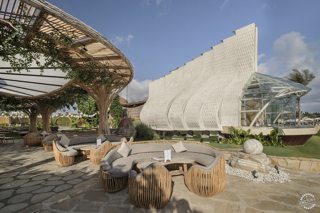

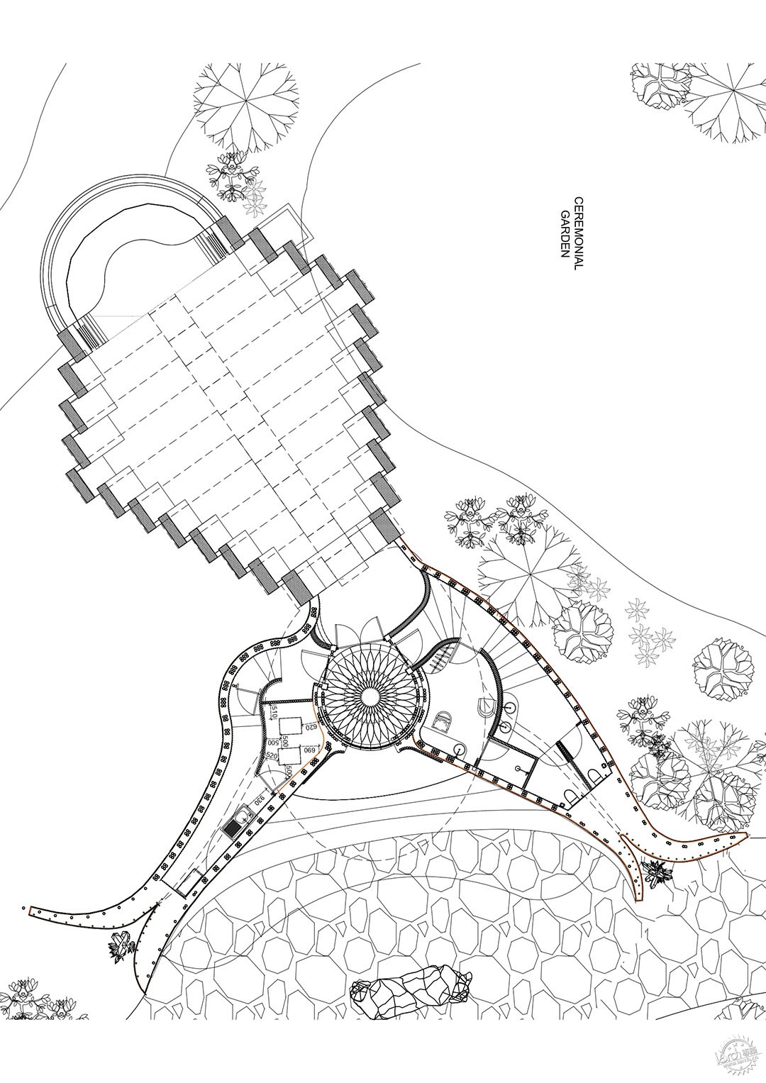

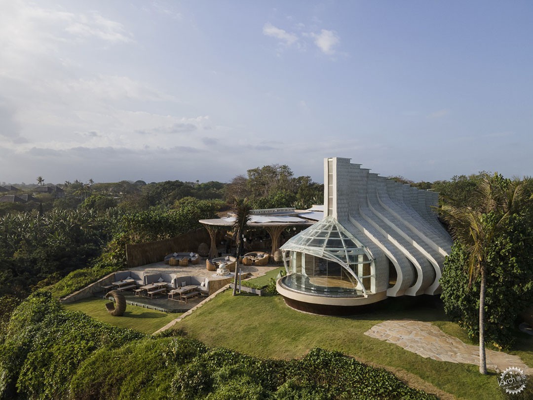

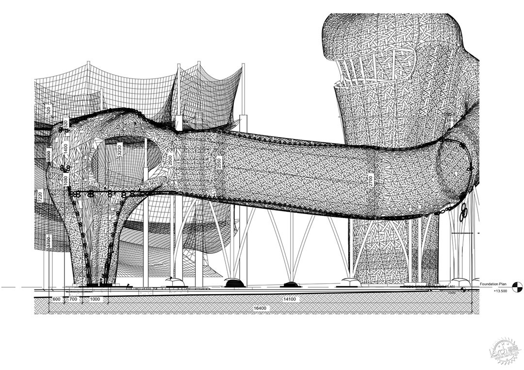

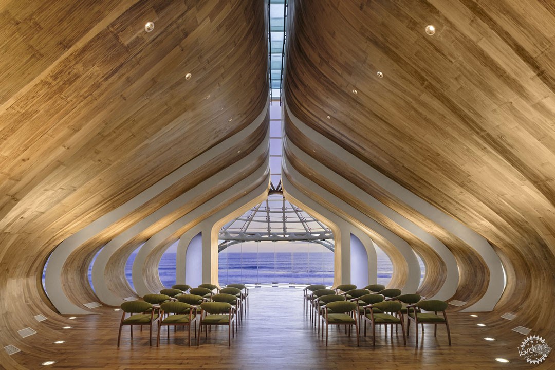

在其他地方,纪念性建筑和洞穴水池中使用了复合 SIP 板,这种方法在不使用混凝土的情况下可以创造出极具挑战性的造型。在 “极乐世界 ” 纪念性建筑中,建筑中间有一条长达 20 米的明显空隙,通过玻璃连接。这就需要进行大量的结构分析和严格的现场检查,以确保几何形状的正确表达,否则一旦建错,就会导致失败。
Elsewhere composite SIP panels were used in the ceremonial building and the cave pool as a way to create very challenging forms and also without the use of concrete. In the 'Elysium' ceremonial building, there is a clear unbroken 20m gap between the two halves of the building where the only connection is glass. This requires a great deal of structural analysis and stringent snagging on site to ensure the geometry is created correctly, otherwise resulting in possible failure if built incorrectly.
