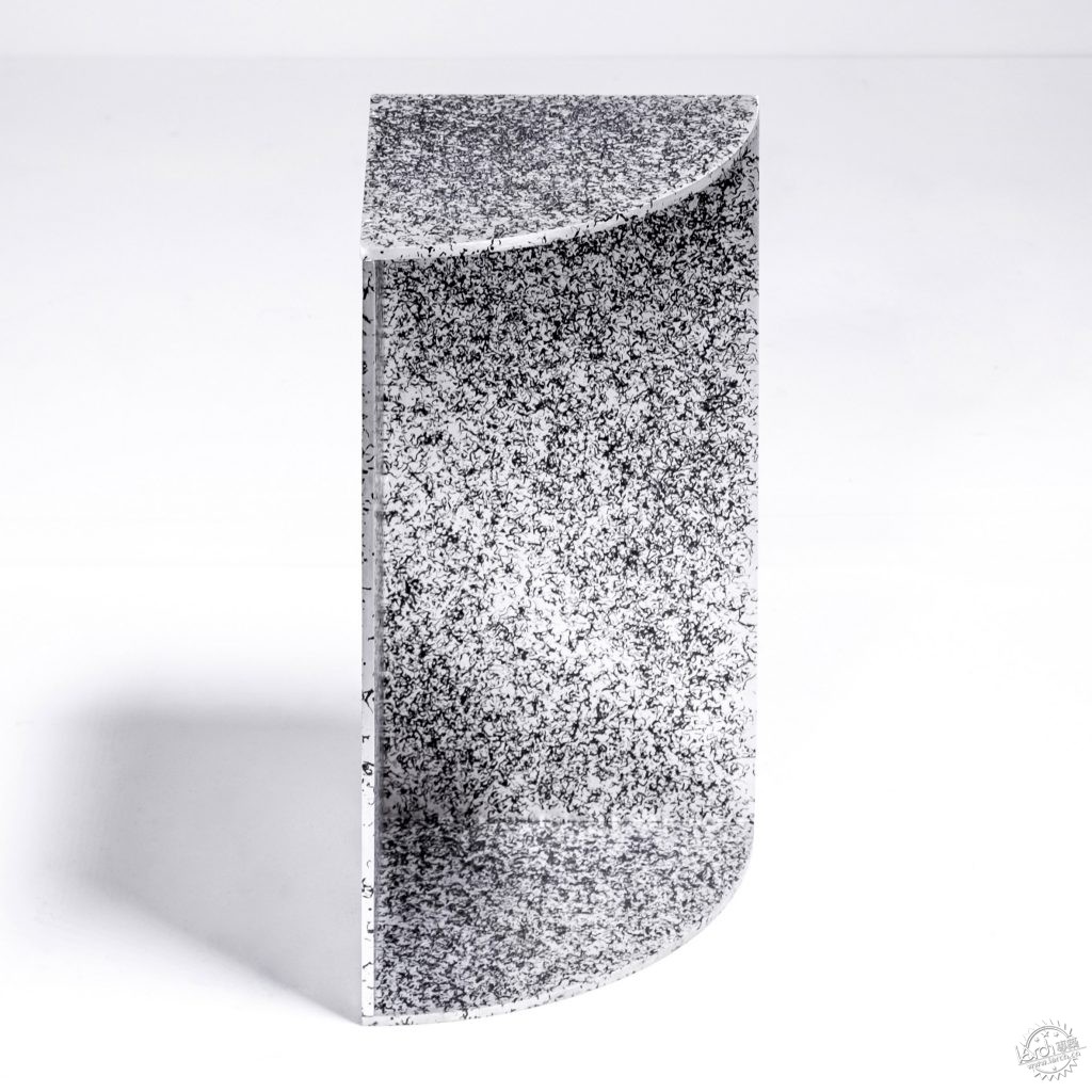

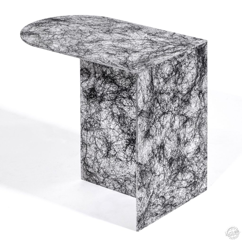

该凳子又称为头发的颜色,其特点是弯曲的水平边缘,以及从两边向下延伸的立柱。
在制造期间,所有这些部件被放置在重新配置的工业烧烤架内10分钟。
然后将头发放每个加热板上5至10秒,头发立即碳化,使得其用作与蚀刻和阳极氧化相似的油墨形式。然后,冲洗和冷却片材。
Called The Colour of Hair, the stools feature seats with curved edges, and uprights that extend down from two edges.
During manufacture, all of these parts are placed inside a reconfigured industrial barbecue grill for 10 minutes.
Hair is then applied to each of the heated panels for five to 10 seconds, carbonising instantly so that it acts as a form of ink that has similarities to etching and anodising. Afterwards, the sheets are rinsed and cooled.
美妙的图案,它却来自你的身体。你,要不要去看看......第4张图片
该反应由头发的主要蛋白质——角蛋白引起。该过程中的转变是永恒持久的。
“我们使用蛋白质作为印刷品,在实验中,我们一直使用头发,因为头发是一种蛋白质,这种蛋白质的最大部分是角蛋白,所以它功效更好,” Hendry解释说。
“我们加热铝五分钟,然后在这五分钟后,我们使用头发,当头发接触热表面碳化,这意味着它液化和渗透铝,留下一个印记,但在这种冲击下头发溶解,所以没有头发了”,他继续说。
The reaction is caused by the hair's main protein, keratin. The transformation during the process is permanent and durable.
"We use proteins as a printing matter, and in our case we've been using hair because hair is a protein and the largest part of this protein is keratin, so it works even better," Hendry explained.
"We heat up the aluminium for five minutes and then after these five minutes we apply hair onto it and when the hair touches the hot surface it carbonises, which means it sorts of liquifies and penetrates the aluminium and leaves an imprint, but the hair dissolves on this impact, so there's no hair there anymore," he continued.

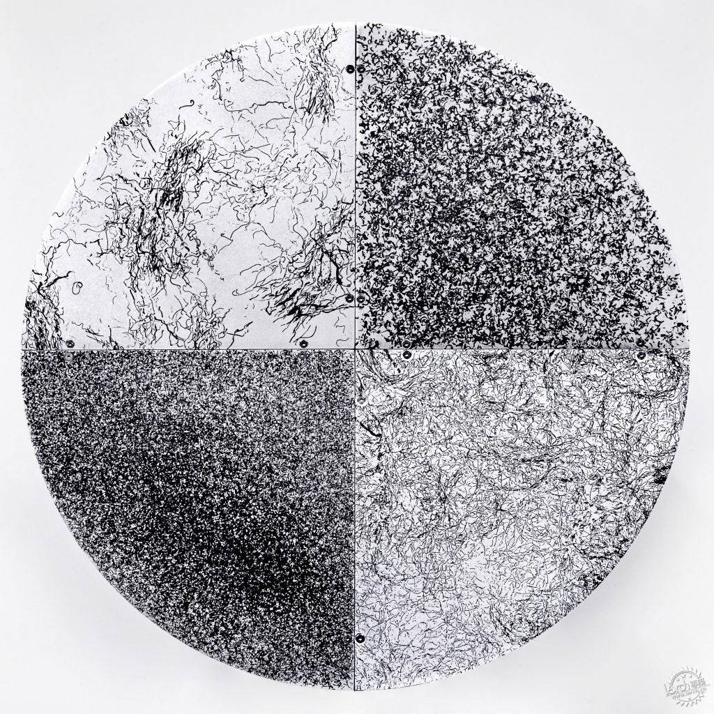

Hendry和Rigters开发了五种不同的技术,使用一系列的头发长度,以创建各种图案的凳子,以及柜台,货架和瓷砖。
一个关于用修剪的短发产生细粉。这被通过具有孔的片材推动,类似于丝网印刷,留下与模板相同的印记。
This is not the first time that leftover human hair has been recycled by designers. Zsofia Kollar used it to create a series of scented objects, including a wall hanging and a U-shaped necklace, while Ola Giertz stuffed clumps into plastic pouffes for padding.
Hendry and Rigters have developed five different techniques using a range of hair lengths to create a variety of patterns for the stools, as well as counters, shelves and tiles.
One involves trimming short hair to create a fine powder. This is pushed through a sheet material with holes, similar to screen-printing, leaving an imprint identical to the template.
美妙的图案,它却来自你的身体。你,要不要去看看......第6张图片
“我们将头发修剪成非常细的粉末,我们把这种粉末作为墨水处理”,Hendry解释说。“我们通过一个模具,得到图片的负片。”
“任何数字图像都可以转换为光栅化矢量或位图,然后可以通过激光切割,或用乳液转换到金属网格上,以制作模板。
"We trim the hair into very fine powder and this powder we treat as ink," Hendry explained. "We push through a stencil and we get a negative of the image."
"Any digital image can be transformed into a rasterised vector or bitmap, which can then be cut out by laser, or transformed with an emulsion onto metal-mesh in order to make the stencil."
美妙的图案,它却来自你的身体。你,要不要去看看......第7张图片

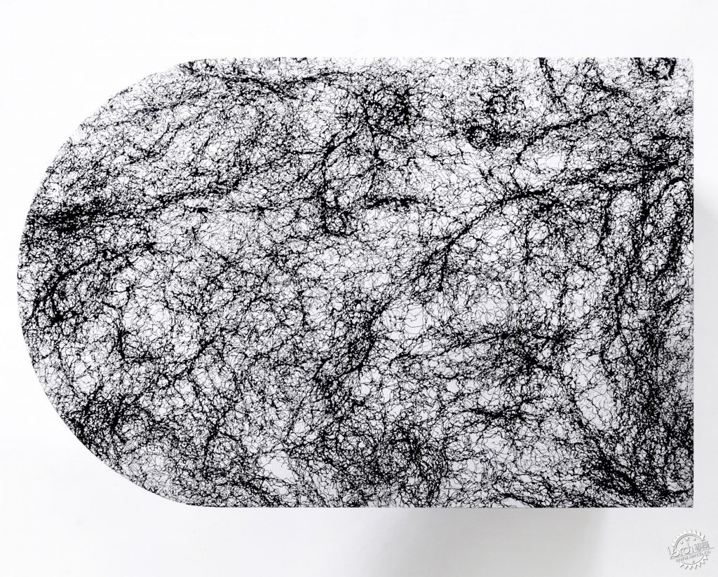

通过具有不同孔径的多个网格来直接筛分毛发纤维,头发削片得以应用。 喷洒越长,印刷品越深,允许不同的颜色梯度。
中等长度的头发可以用于创建大理石图案。 将毛发均匀地分布在背衬纸上,并用毛发凝胶和水的液体混合物喷洒。
Hair shavings are applied by directly sieving hair fibres through multiple meshes with different hole sizes. The longer the sprinkle, the darker the prints get, allowing for different colour gradients.
Medium length hair stands can be used to create a marble pattern. The hair is evenly distributed onto a backing paper and sprayed with a liquid mixture of hair-gel and water.
美妙的图案,它却来自你的身体。你,要不要去看看......第8张图片
然后在热压机中压制两分钟,形成平板。凝胶硬化并且水溶解,形成单个毛发纤维重叠的牢固接头。
头发分布越密集,印刷品变得更大。 由头发制成的织物大约是40×40厘米,称为毛发纸莎草。
在另一种技术中,较长的头发纤维被束成束,并附接到手柄上,以产生不同类型的刷子,每种刷子具有不同的笔画。宽刷可以绘制大的瓷砖并完全覆盖表面。
It is then pressed in a heat press for two minutes into a flat sheet. The gel hardens and the water dissolves, creating a strong joint where the single hair-fibres overlap.
The denser the distribution of hair, the more marbled the print becomes. The fabric made of hair is roughly 40-by-40 centimetres and called hair papyrus.
In another technique, longer hair fibres are tied as a bunch and attached to a handle to create different types of brush, each with different strokes. Wide brushes make it possible to paint large tiles and fully cover a surface.
美妙的图案,它却来自你的身体。你,要不要去看看......第9张图片
在这个过程中重要的是,动作必须相当快,头发纸莎草和发带那些,必须应用,这样可以产生令人震惊的大理石效果”,Hendry说。
锁定图案也可以从马尾辫的切割产生,其直接分布在金属表面上,留下球形贴片。
