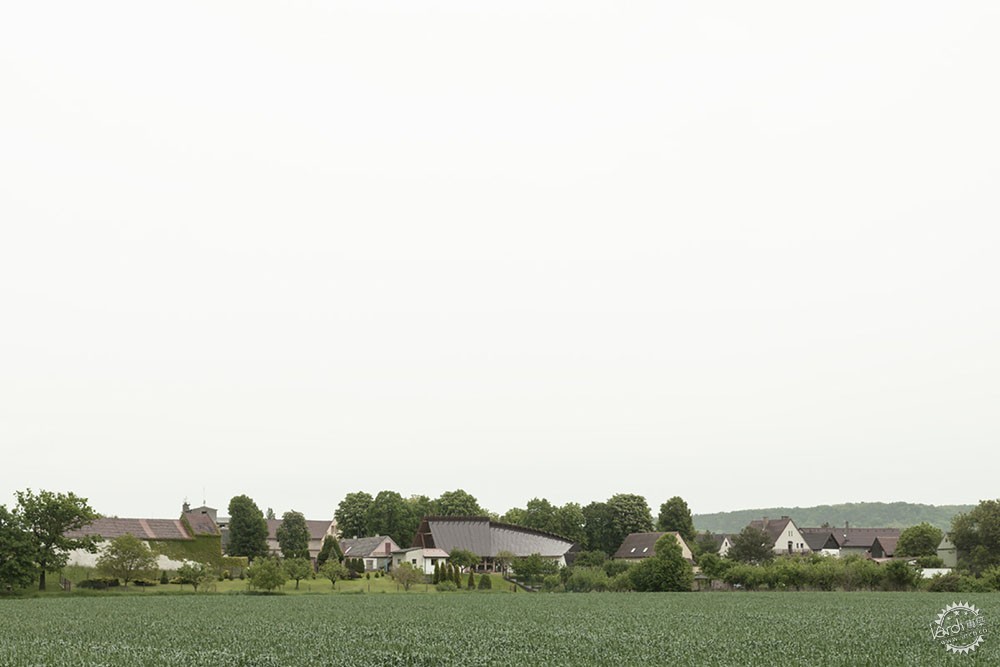

来自事务所的描述。社区决定将场地开发成为容纳30名儿童的幼儿园,是村里最好的一所幼儿园。它是古老村庄里的一块空地,能够看到河流和相应的花园。
From the architect. The site the community decided to develop for a kindergarten for 30 children is one of the nicest in the village. It is a vacant lot at the historical village green with a view to the river and a corresponding area for a garden.

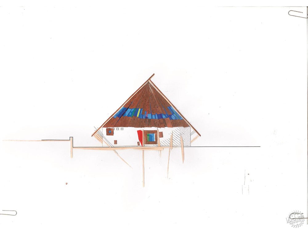

从抽象的方面来说,该建筑基于带有坡顶的经典乡村住宅的设计理念。乡土元素也用于富含雕塑的立面上,参考了当地传统建筑的装饰。雕塑师Jiri Vorel和对这个地点有个人情感。
In terms of abstraction, the building is based on the concept of a classic country house with a hip roof. Vernacular elements are also used on the façade that is rich with statuary referring to decorativeness of traditional architecture in the area. The sculptor is Jiri Vorel who has personal bond to this location.

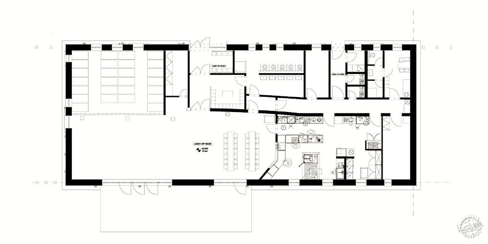

多布林幼儿园/ ATELIER 8000第6张图片
Floor Plan/楼层平面图

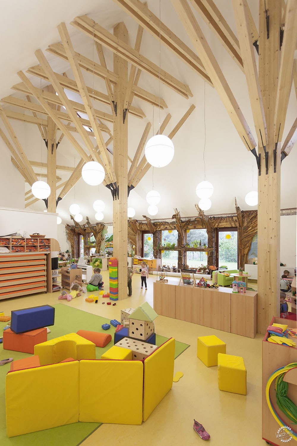

多布林幼儿园回归童话世界,回归儿童世界。它关心儿童的愿景和愿望。它应该类似小“屋”,提供和睦和温暖的感觉,能够很好嬉戏。室内布置的空间概念尽可能开放,将自身确定为不同于通常枯燥的捷克幼儿园。
The kindergarten in Dobrin is a return to the world of fairy-tales, to the world of children. It respects their visions and wishes; it should resemble a small ′cottage′ that provides a harmony, warmth, and possibility to have a good romp. The spatial concept of the interior layout works with openness as much as possible and identifies itself as different compared with usually sterile Czech kindergartens.

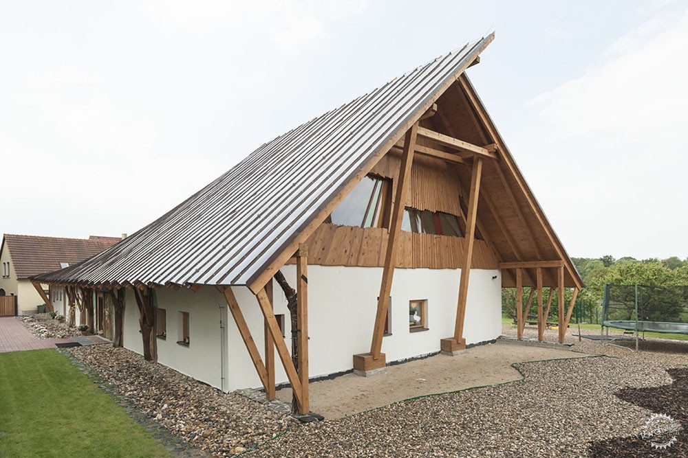

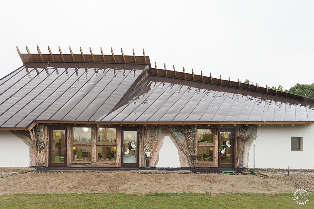

幼儿园被花园包围,花园的果树和场地东边平行。它是一层的方形建筑,屋顶是与众不同的建筑和识别元素。北侧有古典的坡顶,倾斜35度;南侧缓慢朝一面墙下斜。
The kindergarten is surrounded by a garden with fruit trees positioned parallel with the east border of the lot. It is a one-story building of a rectangular footprint. The roof is a distinguished architectural and identifying element. At the north side, it is a classical hip roof with a pitch 35°; towards the south, it slowly pitches down towards one wall.

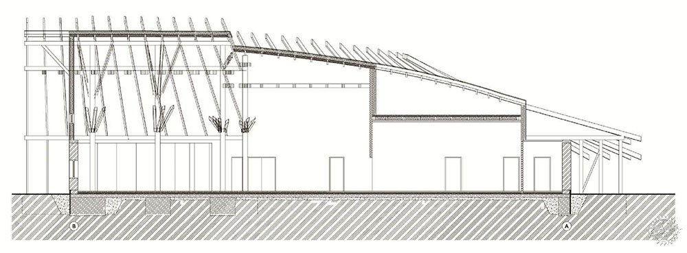

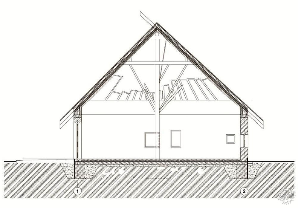

多布林幼儿园/ ATELIER 8000第11张图片
Section 1/剖面图1

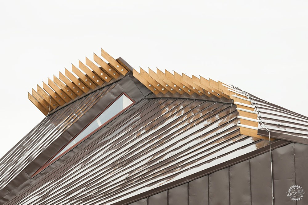

橼是木制的,结构反映了跨度。从北山墙将近8米,倾斜突然改变,这样建立了天窗,让南向日光照入儿童游戏室。在可能的情况下,室内敞向橼下的阁楼。其它阁楼的屋顶经过装饰。
Rafters are timber; the structure reflects the span. Approximately 8 m from the north gable the pitch abruptly changes establishing a clerestory window letting southern daylight in the children’s playroom. Where possible, the interior opens up to the attic below the rafters.  The roof is decked elsewhere in the attic.

垂直墙壁上开有窗和门,设计来抵御洪水,易于用新的替换。屋顶是铜色铝板。
Window and door openings in vertical walls are designed to resist flooding or allowing for easy replacement for new ones. Roofing is copper colour aluminium sheet.

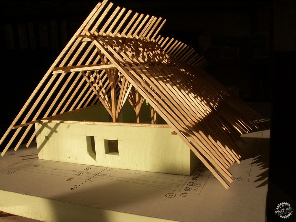

多布林幼儿园/ ATELIER 8000第20张图片
Model 1/模型1
多布林幼儿园/ ATELIER 8000第21张图片
Model 2/模型2
