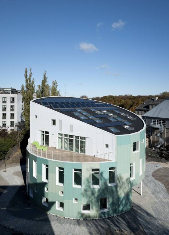

绿色灯塔/Christensen & Co Architects事务所/Green Lighthou......第2张图片
以下内容来自建筑事务所。绿色灯塔是丹麦第一家中和二氧化碳的公众建筑,同时它还是哥本哈根大学科学院教职人员的居住地。建筑环绕式的形态和立面调整型的百叶窗反应了太阳运动的轨迹。太阳,作为能量的主要来源,是这座新建筑背后设计概念的重中之重。绿色灯塔的设计建立在一系列的能源概念的实验基础之上,包括了一些供给的组合,有区域的热量,光电,太阳能还有冷流和季节性的能量储藏。70%的能源减耗量是直接来自于建筑设计的合理。“太阳是能源的主要来源,建筑环绕式的形态和立面调整型的百叶窗反应了太阳运动的轨迹。”建筑师迈克尔•克里斯滕森,同时也是Christensen & Co. architects事务所的创立者如是向我们解说这座新建筑的设计理念。
From the architect. Green Lighthouse is Denmark’s first CO2 neutral public building and home to the Faculty of Science at the University of Copenhagen. The building’s circular shape and the adjustable louvers of the façade mirror the course of the sun. The sun being the predominant source of energy is the overriding design concept behind the new building. Green Lighthouse is based on a whole new experiment with an energy concept, consisting of a supply combination of district heating, photo voltaic, solar heating and – cooling and seasonal storage. 70% of the reduction of the energy consumption is the direct consequence of architectural design. “With the sun as the predominant source of energy, the building’s round shape and the adjustable louvers of the facade mirror the course of the sun around the building.” This is how Michael Christensen, architect, director and founder of Christensen & Co. architects explains the overriding design concept of the new building.

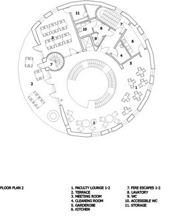

Plan平面
