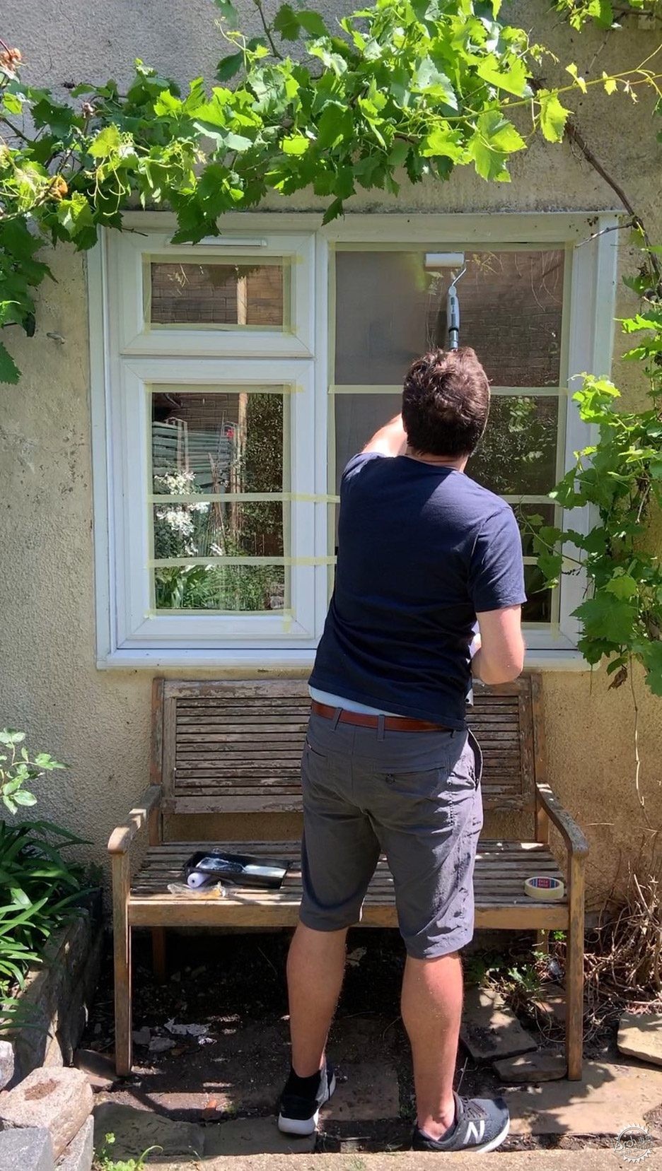

炎炎夏日,英国工程师 Tom Greenhill构思了一个建议低成本、低能耗的降温方案——在窗户外侧涂抹酸奶,目的是在高温期间使家居保持凉爽。
用滚筒涂抹,酸奶干得快,能形成类似磨砂玻璃的效果。Greenhill说,这种涂层应该能像其他节能窗涂层产品一样反射光和热。
Greenhill承认,这看起来可能是一个“完全古怪的想法”。但根据实验,他还没有看到这个策略的任何缺点。
British engineer Tom Greenhill is proposing painting the outside of windows with yoghurt as a low-cost, low-energy solution to keep UK homes cool during heatwaves.
Painted on with a roller, yoghurt dries quickly and creates a fritted glass-like effect that Greenhill says should reflect light and heat in much the same way as other energy-efficient window coating products.
Greenhill admits that this may seem like a "totally eccentric idea". But based on his own experiments, he is yet to see a downside to the strategy.

他说,酸奶容易涂抹,没有气味,不会吸引昆虫,除非遇到大雨,否则不会分解。热浪过后,只需用布和水轻轻一擦即可清除。

He says the yoghurt is easy to apply, doesn't smell, doesn't attract insects, doesn't degrade unless there's heavy rain and can be washed off simply with a cloth and water once the heatwave is over.

在自己家里试用时,这位工程师发现用刷子效果不佳,但用滚筒涂抹酸奶能形成薄薄的一层,质感让人联想到陶瓷釉料——“这是我在建筑项目中用来限制太阳能增益的产品”。
他测试了多种酸奶——包括乳制品和燕麦酸奶——发现它们的效果都差不多,每扇窗只需约一汤匙,低脂酸奶能产生更透明的效果。

Applying any coating to the exterior of the window is more effective for cooling, Greenhill said, as it stops the sun's rays from breaching the thermal envelope and getting trapped inside the house.
For a test run on his own home, the engineer found that using a brush was unsuccessful but applying the yoghurt with a roller gave a thin coating with a texture reminiscent of ceramic frit – "a product I've specified on building projects to limit solar gains".
He tested a variety of yoghurts – including dairy and oat – and found they all worked much the same, with only about a tablespoon of product required per window and lower fat yoghurts giving a more translucent effect.
