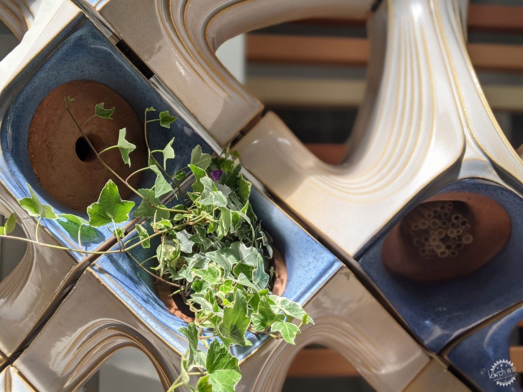

每个单独的模块都有一个雕塑般的箭头形状,由三个尖头和圆形开口组成,可以安装嵌套豆荚,为野生动物提供立面下方的可居住空间。
陶瓷模块以蓝色和白色的色调上釉,并覆盖有装饰性的脊状表面,当它们以镶嵌形式固定在一起时,在建筑物的正面形成波纹和纹理图案。
Each individual module has a sculptural, arrow-like shape comprised of three prongs and circular openings that can be fitted with nesting pods to provide wildlife with inhabitable space beneath the surface of the facade.
The ceramic modules were glazed in hues of blue and white and covered in decorative ridged surfaces to create rippling and textural patterns across facades of buildings when fixed together in their tessellating formation.

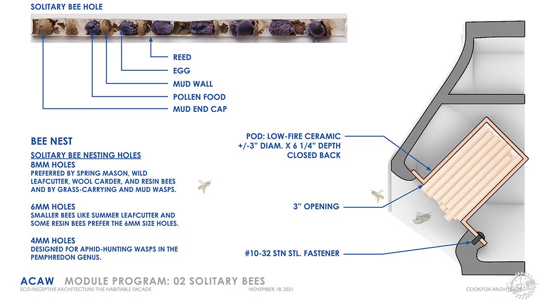

三个不同的吊舱空间得以设计,目的是容纳植物、蜜蜂,以及一些鸟类,它们可以用螺栓固定在赤土陶器系统的底部。

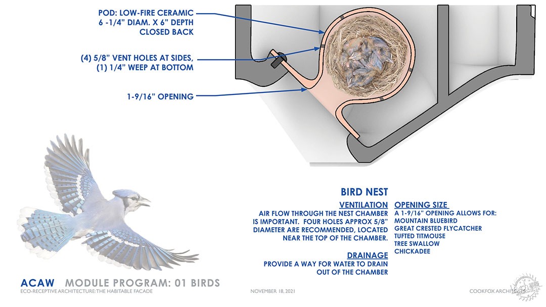

专门用于鸟类的吊舱有大约 2 厘米宽的开口,内部呈圆形,深度充足,可为鸟类提供舒适的筑巢空间。四个通风孔贯穿豆荚的侧面,为巢穴内部提供气流。
燕窝的尺寸刚好用于安置山蓝鸟、大冠鹟、簇绒山雀、树燕和山雀。
芦苇被装在带有 7 厘米宽开口的豆荚中,这些开口足以容纳授粉蜜蜂,并为众多物种筑巢和繁殖创造空间。
4 毫米宽的巢穴为蚜虫狩猎黄蜂提供空间,6 毫米宽的巢穴服务于夏季切叶蜂和较小的树脂蜜蜂,而8 毫米宽的巢穴则适用于诸如树脂蜜蜂和泥草黄蜂等其他昆虫。

Pods dedicated to birds have approximately two-centimetre-wide openings with a rounded interior and ample depth to provide birds with comfortable nesting space. Four vent holes punctuate the sides of the pod to provide airflow to the interior of the nest.
The measurements of the bird's nest pods were considered specifically to house Mountain Bluebirds, Great Crested Flycatcher, Tufted Titmouse, Tree Swallow, and Chickadees.
Reeds were packed within pods with seven-centimetre-wide openings that were designed to house pollinating bees and create spaces for numerous species to nest and populate.
Four-millimetre-wide nesting holes provide space for aphid-hunting wasps, six-millimetre for summer leafcutter and smaller resin bees and eight-millimetre-wide holes for other insects like resin bees and mud and grass-carrying wasps.

▲ 立面系统由镶嵌模块组成
The facade system comprised of tessellating modules

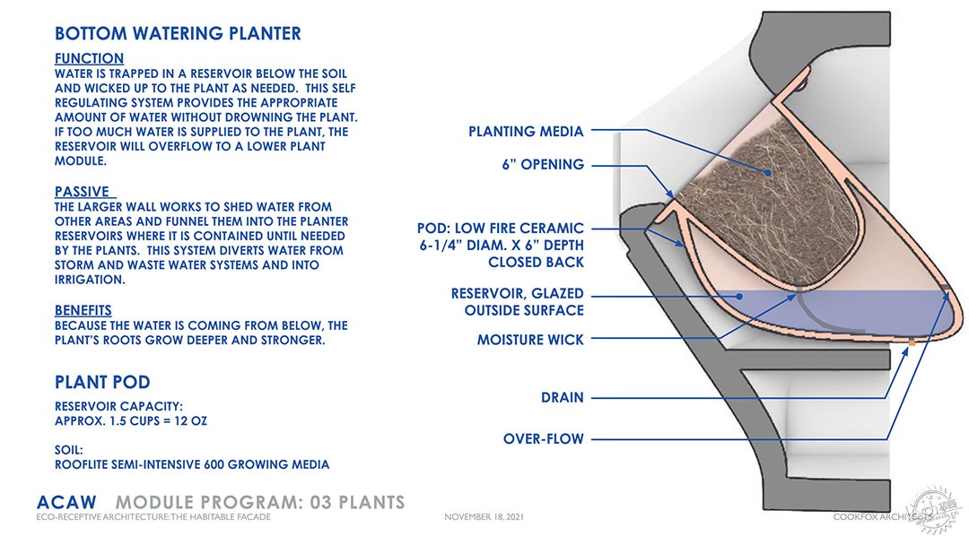

植物荚原型具有用于种植的底座,以及设置在土壤袋下方的水库,它们通过灯芯连接,满足绿色植物的灌溉需求, 由于含水量高,该吊舱设计有釉面,确保水不会被材料吸收。
