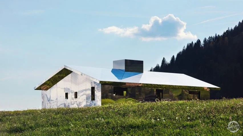

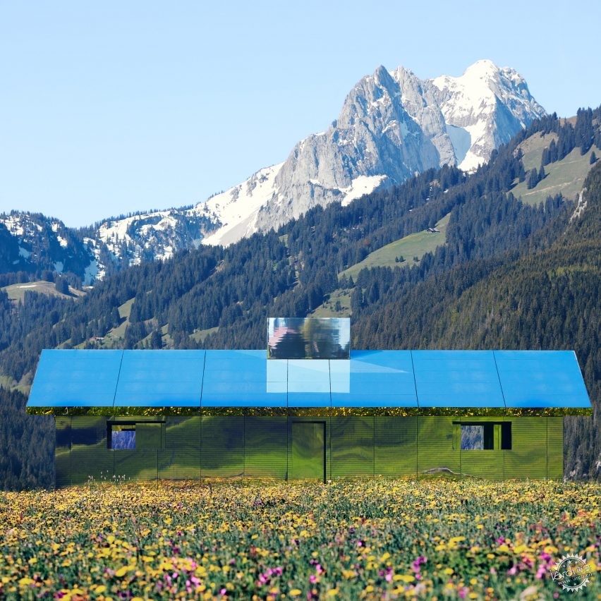

贴膜玻璃幕墙
贴膜玻璃幕墙应用于建筑外立面的内外表面,帮助鸟类看到建筑物反光表面的方法正变得越来越普遍。这种薄膜通常以窄小的水平条纹的形式出现,肉眼几乎看不见。
艺术家Doug Aitken在Gstaad的镜面展馆Mirage 1049(如上图所示)的立面上使用了贴膜玻璃幕墙。Aitken说,依据瑞士鸟类保护协会的指导,水平黑线的距离间隔为3厘米,“以抵消反射表面造成的干扰”等。
Window films
Applicable to inside and outside surfaces, window films are becoming an increasingly common way to help birds see reflective surfaces on buildings. The films typically take the form of narrow, horizontal stripes that are barely visible to the human eye.
Artist Doug Aitken used window films on the facades of Mirage 1049 (above), a mirrored pavilion in Gstaad. Following guidance from the Swiss Bird Protection Society, the horizontal black lines were positioned three centimetres apart "to counter the distraction from the reflective surfaces", Aitken said.

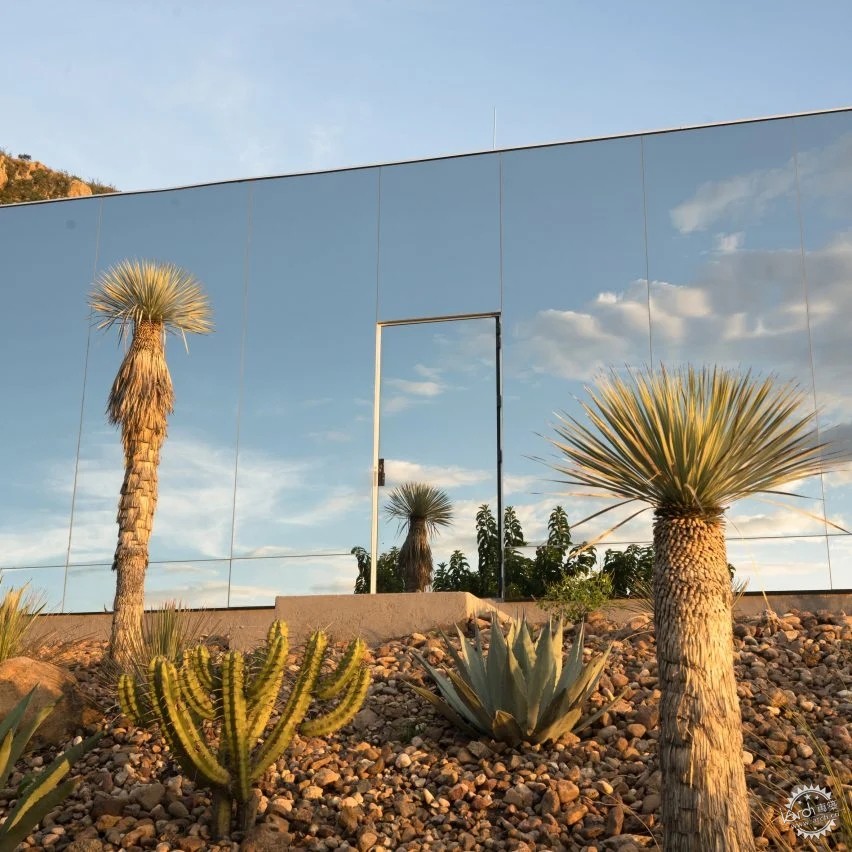

防紫外线玻璃
玻璃窗户和反光表面也可以让一些鸟类看到紫外线(UV)的纹理或者涂层。这是因为鸟类可以看到紫外线光谱。
这种技术对人类来说是不可行的,但通常被用于反射周围环境的镜像建筑上。例如Prashant Ashoka在墨西哥设计的Casa Etérea(如上图所示)和Peter Pichler在意大利设计的一系列宾馆等。
然而,防紫外线玻璃是实现鸟类友好型建筑的较为昂贵的选择,因此一般不推荐使用,因为某些鸟类对紫外线的光谱并不敏感。
UV-patterned glass
Windows and reflective surfaces can also be made visible to some birds using ultraviolet (UV) patterns or coatings. This is because avian species can see into the UV spectrum of light.
The technology, which is not visible to humans, is commonly used on mirrored buildings that are designed to reflect their environments. Examples include Casa Etérea in Mexico by Prashant Ashoka (above) and a series of guesthouses by Peter Pichler in Italy.
However, UV patterns are one of the most expensive options for achieving bird-friendly buildings and are often not recommended as certain birds are less sensitive to UV light.

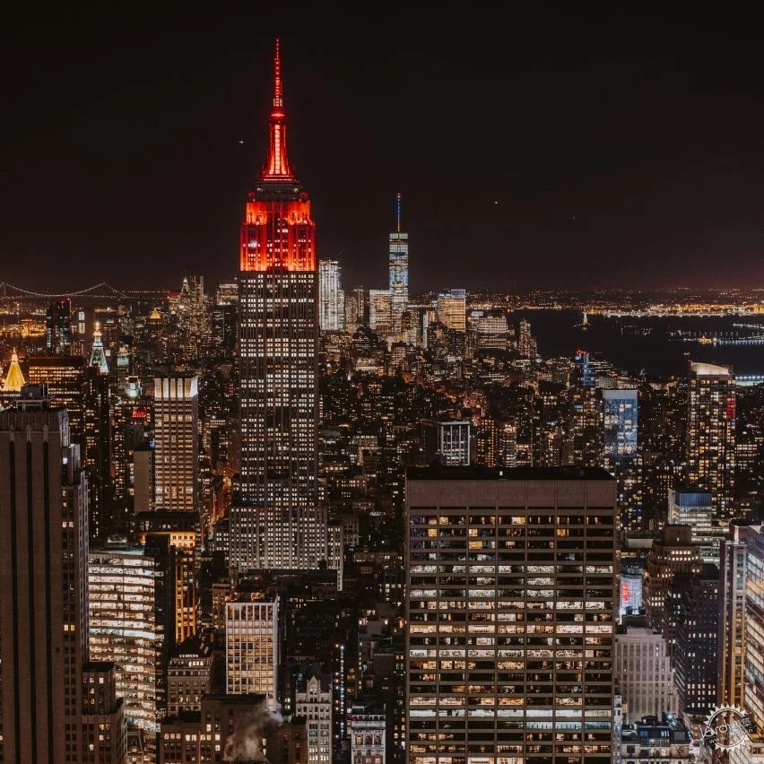

熄灯计划
除了尽量降低建筑物上的玻璃外墙和镜面反射外,减少鸟类撞击的最简单的方法之一就是在夜间熄灯。
这是在美国和加拿大等地区开展的许多“熄灯”项目的目的。梅丽莎·布雷耶是纽约市野生动物慈善机构NYC Audobon的志愿者,她呼吁更多的建筑业主参与到去年纽约大规模鸟类撞击玻璃死亡的事件中来。布雷耶说,这些情况在春季和秋季鸟类迁徙期间尤为重要。
Lights Out programs
Alongside minimising the reflectively of glass and mirrors on buildings, one of the easiest ways to decrease bird collisions is by simply turning off lights in buildings at night.
This is the goal of many "Lights Out" programs launched across the USA and Canada. Melissa Breyer, a volunteer for New York City wildlife charity NYC Audobon, demanded that more building owners and occupants took part in these following the mass-bird death in New York last year. Breyer said these programs are particularly important during spring and autumn bird migrations.
