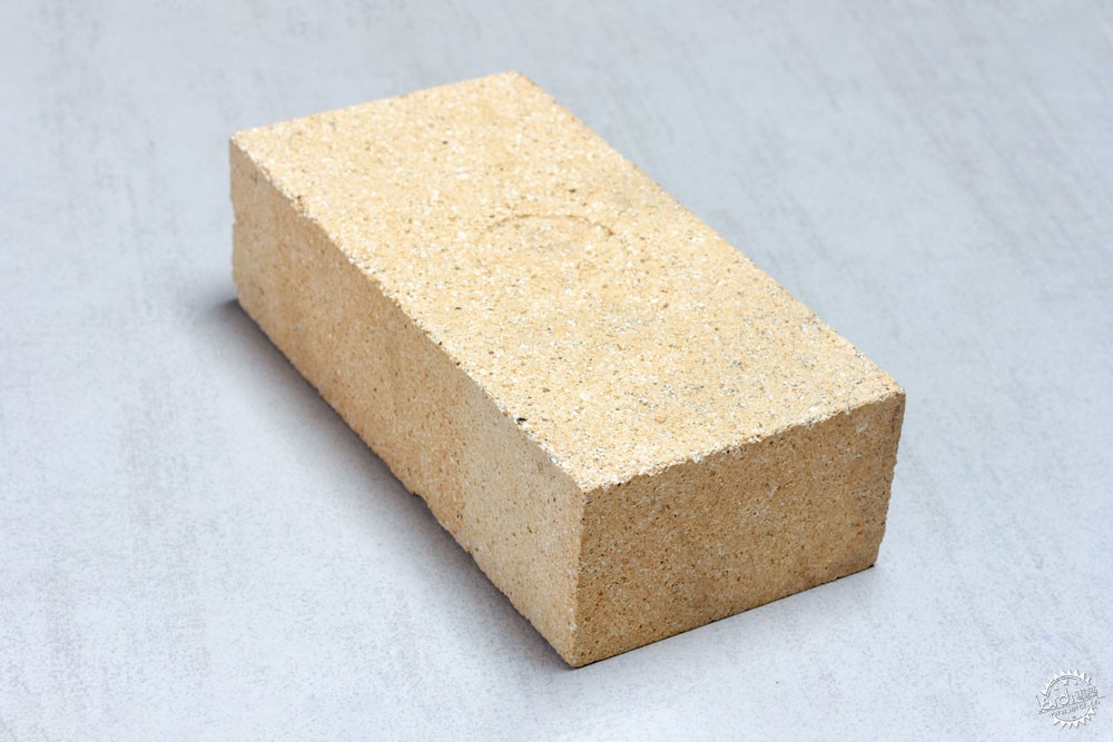

看似矛盾的是,在1000℃以上的烤箱中烧过的材料不能承受高温,其实,主要问题是热冲击。当普通砖与热源接触时,会迅速膨胀,当热源停止时(比如火熄灭),材料就会收缩。这些温度的突然变化会影响结构的稳定性,会形成裂缝等严重问题。耐火材料是指那些能够承受高温而不被高温破坏其结构、电阻或导热性的材料。就砖材料而言,耐火砖的化学成分与普通砖不同,这会影响其颜色和导热系数。
It may seem contradictory that a material that has been burned in ovens at temperatures of more than 1000° C cannot withstand high temperatures. In fact, the main problem is thermal shock. When the common brick comes into contact with a heat source, it expands quickly. When the source ceases (the fire extinguishes, for example), the material contracts. These sudden changes in temperature affect the stability of the structure and can form cracks and other serious problems. Refractory materials are those that can withstand high temperatures without the heat damaging their structure, resistance, or thermal conductivity. In the case of bricks, the chemical composition of refractories is different from that of regular bricks, which also influences their color and thermal conductivity.

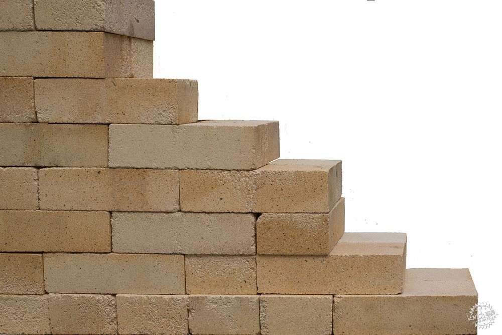

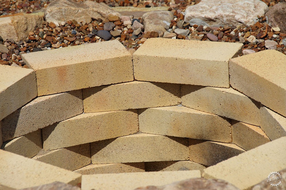

对于家庭用途,如烤箱、烧烤炉和壁炉,使用的耐火砖通常由粘土组成,主要含有氧化铝和二氧化硅,这些元素能够承受高温。氧化铝具有反射性,而二氧化硅则是一种优良的绝缘体。混合物中存在的氧化铝越多,砖所能承受的温度就越高(这是工业用途的重要考虑因素),砖的价格也就越高。硅石的颜色比较灰暗,而氧化铝的外观比较黄。
For domestic uses, such as ovens, barbecue grills and fireplaces, the refractory bricks used are usually composed of clay containing mainly alumina and silica, elements capable of withstanding high temperatures. While alumina has reflective qualities, silica is an excellent insulator. The more alumina present in the mixture, the higher the temperature that the brick will endure (an essential consideration for industrial uses) and the more expensive the piece will be. Silica has a more grayish tint, while alumina has a more yellowish appearance.

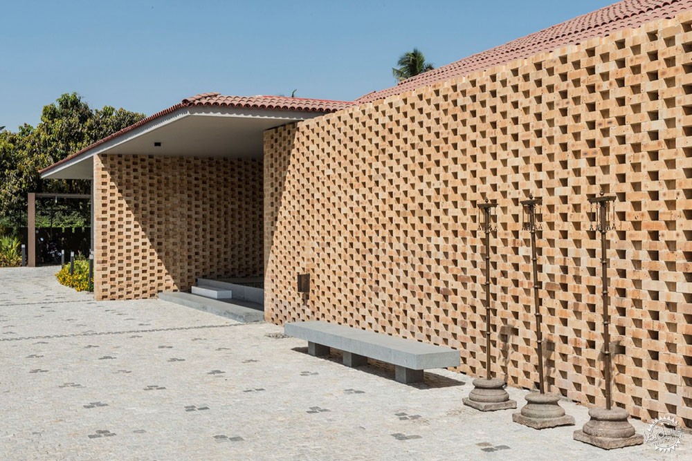

除了技术功能外,还有建筑师使用外露的耐火砖来建造和装饰表面。在设计工作小组开发的“热带之家Urveel”项目中,耐火砖有多种使用方式,有时呈现出像“Indian jali”一样的多孔形式,有时不透明且有纹理,有时形成天井,有时作为背景,这些砖可以应用在整个房子里。
In addition to the technical function, there are architects who use exposed refractory bricks to build and coat surfaces. In the Tropical House Urveel project, developed by Design Work Group, refractory bricks were used in several ways. Sometimes porous like an "Indian jali," sometimes opaque and textured, sometimes forming a patio and sometimes acting as a background, these bricks were seen throughout the house.
