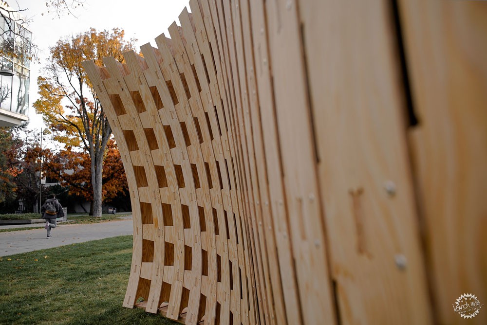

最近,位于温哥华的不列颠哥伦比亚大学校园里安装了一座雕塑,雕塑上搭接的弯曲木板条由机器人完成切割。
Robots sliced the interlocking, curved wooden slats that form this sculptural bench, which is currently installed on the campus of the Vancouver's University of British Columbia.

学生们在最后的设计中,将两排木板条的形状不断调整,形成了结构的轮廓。外部为一座圆形外壳,让里面的公共长凳若隐若现。
为了在木材中创造出有机形状,研究小组设计了这个结构的数字3D模型。然后将其分成各个部件,最后使用机器人将其切割制造。
In the final design, two rows of wooden slats steadily change in shape to create the structure's outline, which curves to a peak. The exterior forms a rounded shell, partially enclosing a public bench inside.
To create this organic shape in wood, the team created a digital 3D model of the structure. This was then segmented into the individual sections that were cut using robotically controlled tools.
