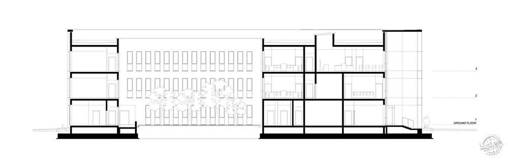

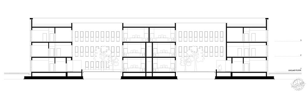

这座法院建筑综合体位于Nowe Siedlce区Kazimierzowska街31A号的一块大型矩形地块上。由于地下水位较高,原地块的高度提高了约1米。建筑平台和相邻街道保持水平,作为新的代表性建筑的基础。三层高的地地区法院主楼被设计成一个单一的部分,立面由重复性的立柱定义,成为前广场公共停车场的水平隔板,也成为通往主入口的大型门廊。在主楼内,提供了两个可以从员工停车场进入的内部庭院。
The Regional Court building complex is situated on a large, rectangular plot, within the area of Nowe Siedlce, at 31A Kazimierzowska Street. The original level of the plot was elevated by approximately 1m, due to a high level of the groundwater table. The platform obtained, meeting the level of the adjacent streets, serves as a basis for the new representative building. Three-story high Regional Court main building was designed as a single block with facades defined by a vertical rhythm of repeating columns turning smoothly into horizontal divisions of the front square dedicated to a public parking lot. Main entrance area was designed as a high corner porch leading to the main entrance. Within the block, two internal courtyards, accessible from the employees' parking lot at the back of the main building, were provided.

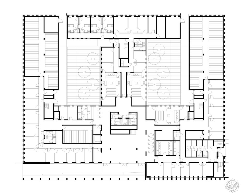

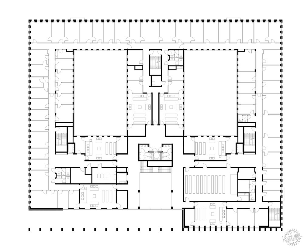

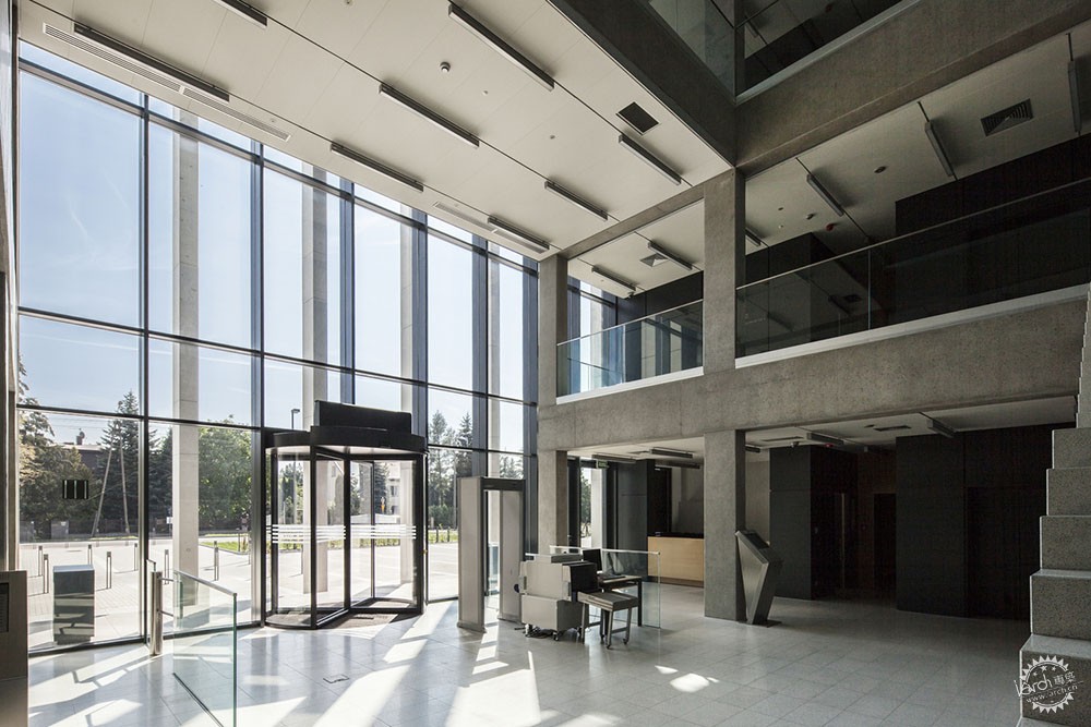

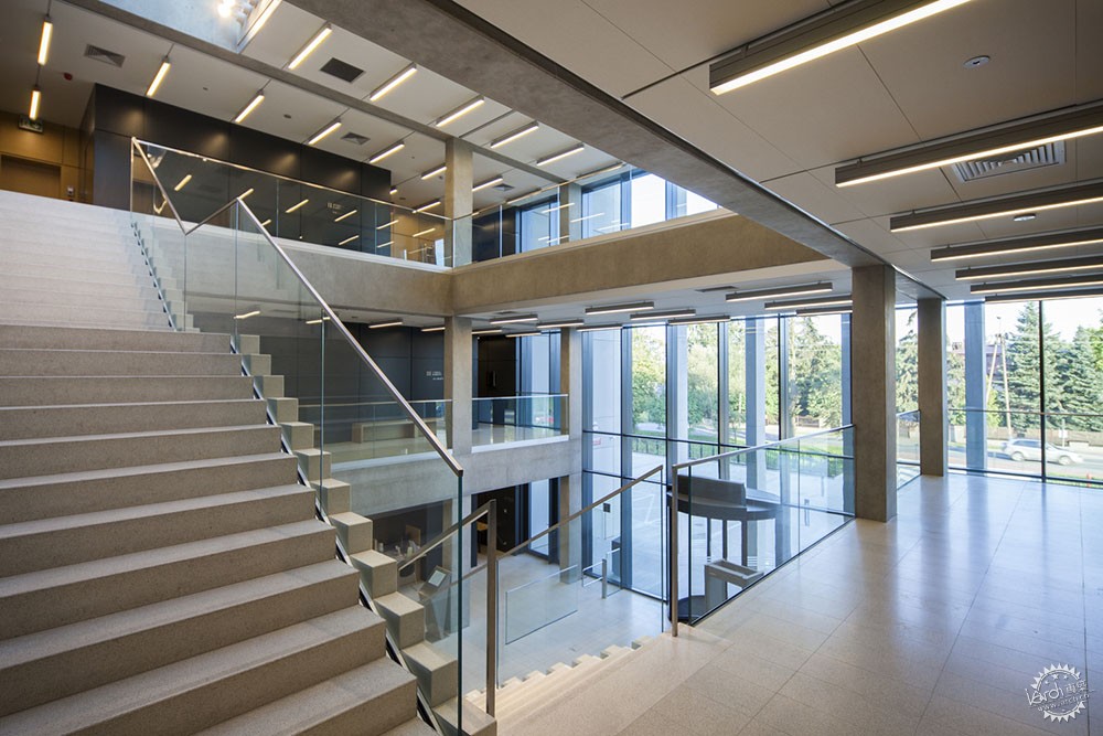

法院主楼的功能安排与安保部门划分的不同出入级别的区域相对应,专门用于公共用途的房间,如法庭、阅览室、土地登记处被设计成主要的流通空间,位于开放的三层楼高的主大厅内。办公室和行政区设置了门禁系统,并与主大厅相连,但主要从位于主楼后的员工区进入。
A functional arrangement of the Regional Court main building corresponds with a security division into zones with varying access levels. Rooms dedicated to public use, such as courtrooms, reading rooms, land registers were designed as accessible from the open, three-story high main lobby, is also the main circulation space. Office and administrative rooms, covered by an access control system, were designed as connected with the main lobby but primarily accessible from an employees’ area, situated at the back of the main building.

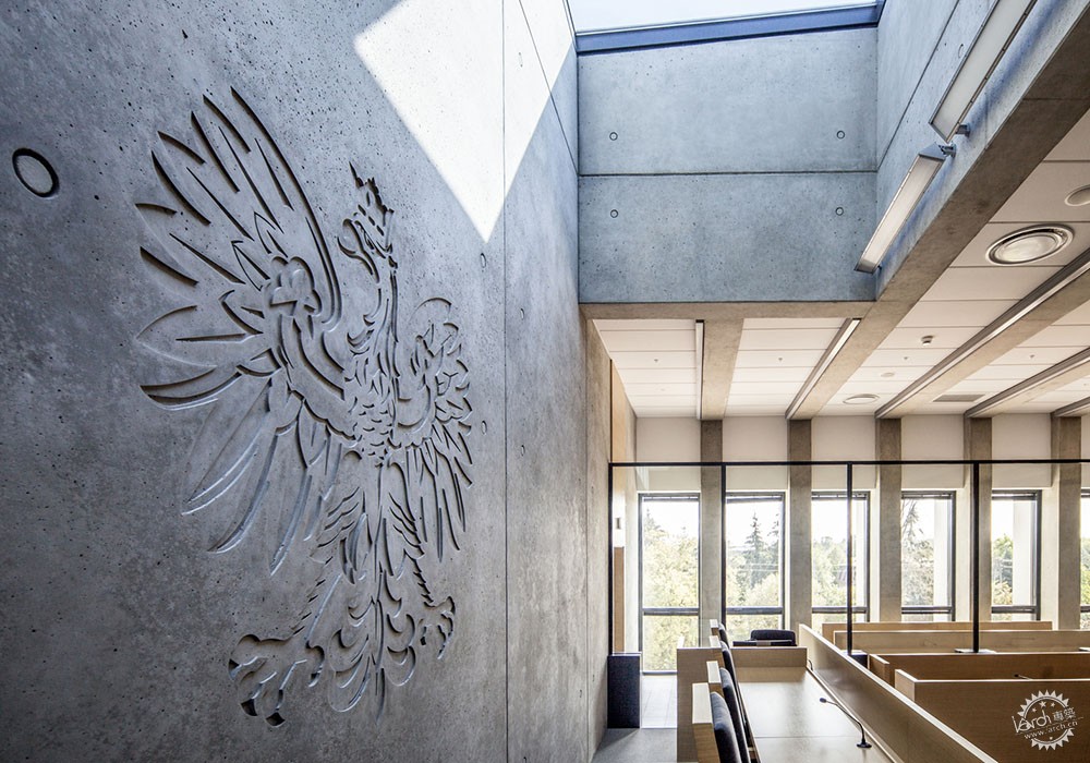

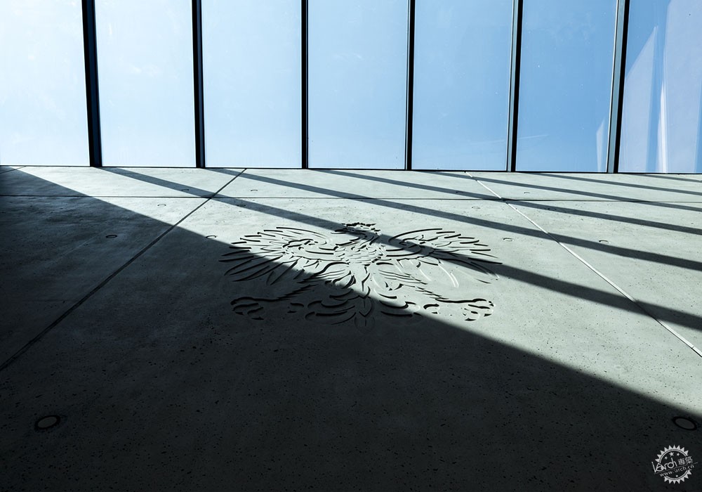

在我们看来,以下的建筑元素是值得被特别关注的:主入口门廊,由细长的预制建筑混凝土柱支撑的建筑混凝土板覆盖,充分展现了现浇和预制混凝土表面的效果。项目模型基于RECKLI弹性形式,完全由我们团队设计,从草图到3D模型转换为CNC-mill文件。
In our opinion, following building elements are worth paying special attention – light main entrance porch, designed as covered by precast architectural concrete slabs supported by slender precast architectural concrete columns, the national emblem reproduction both within cast in situ and precast architectural concrete surfaces. The national emblem reproduction, based on RECKLI elastic form, was fully designed by our team, starting with draft drawings and ending on 3D model transferred into the file for a CNC-mill.
