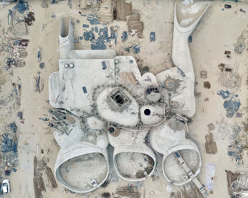

5. Box Crib: Think of this as the final steps of a game of Jenga, but without the anxiety of a collapse. Instead, box cribs are temporary elements used to reinforce and add additional support to heavy objects during construction.The material used to create box cribs are often wooden bars. Due to their practicality, box crib forms are also used in film productions for stabilizing platforms and dolly tracks.
6. Building Engineer: The MVPs of construction. They know it all, and are responsible for most of what goes on during construction. Building engineers differ from one country to another, but are mainly the experts of construction, technology, design, assessment, and maintenance, all at once.

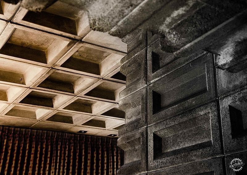

10. Concrete Slab: One of the few construction elements that is used in the vast majority of all structures, a concrete slab is the thick (average of 10-40 cm) horizontal concrete platform which is created to construct the floor or ceiling. There are several slab designs (corrugated, ribbed, waffle, one-way) and each one corresponds to the design or endurance required.

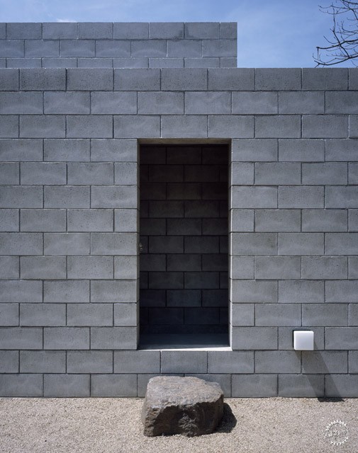

11、课程(建筑):这与在建筑学院所学的课程不同,这个术语主要用来描述连续的砌体。无论是石材、砖块、混凝土砌块,它们都有不同的砌筑方向和类型。

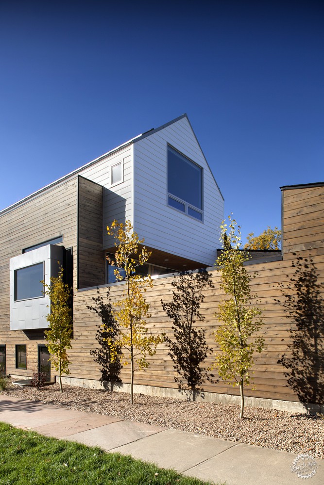

11. Course (Architecture): Other than the class you take in architecture school, a course is the term used to describe a continuous row of masonry. Whether it’s stones, bricks, or concrete blocks, a course can have several orientations and types.

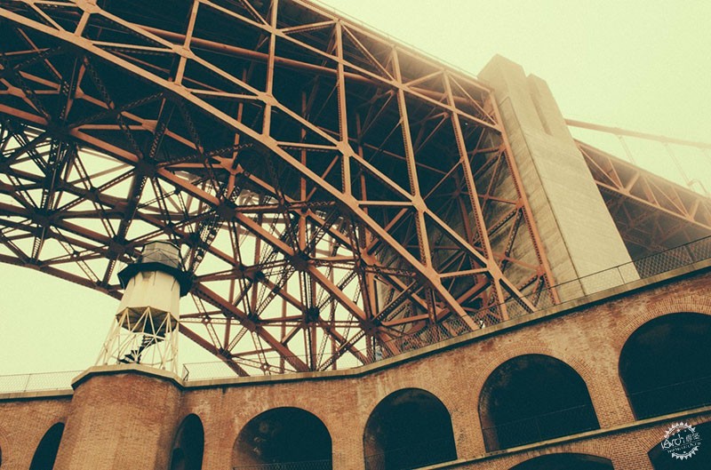

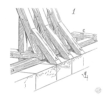

12. Cross Bracing: Cross bracing is a structural component used to improve the endurance of a structure. The X-shaped reinforcement can prevent a building from collapsing completely in case of earthquakes, or a wooden chair from falling apart.

16、对角线网格:这个术语顾名思义,就是对角线和网格的意思。例如斜向交叉的钢梁,也可以是木梁或混凝土梁,这能够减少传统钢框架中的钢材数量。

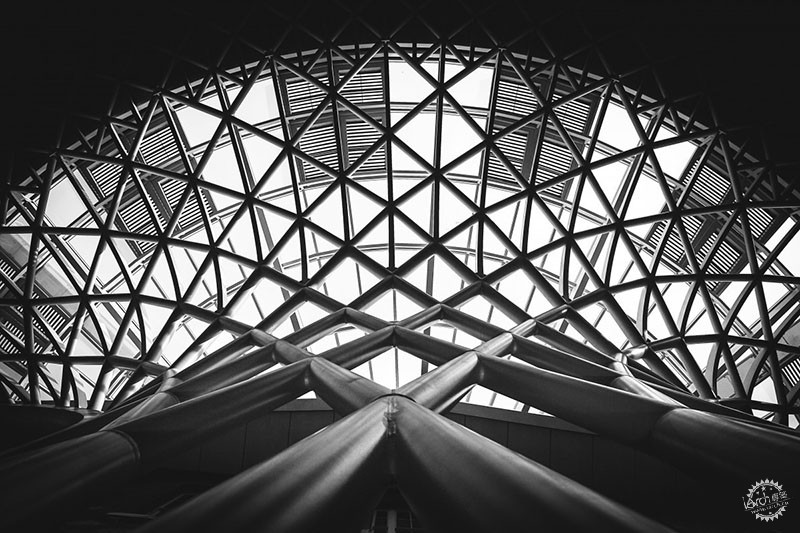

16. Diagrid: The idea behind “diagrid” is pretty simple: diagonal + grid. Diagrids are diagonally intersecting steel beams (occasionally wooden or concrete), which help reduce the amount of steel used in traditional steel framing.

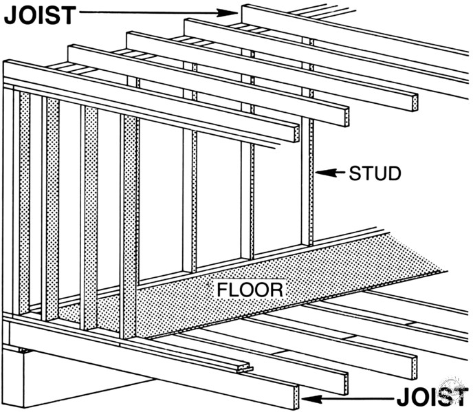

21、托梁:这是大跨度结构的关键构件,因为它能够将荷载从梁传递至支柱,这些构件垂直于梁水平放置,并且与地面的柱子相连接。

21. Joist: Joists are crucial components of a wide-span structure, as they help transfer the load from the beams to the vertical columns and studs. These horizontal elements are connected perpendicularly to the beams (horizontally) and joined (vertically) to the columns.

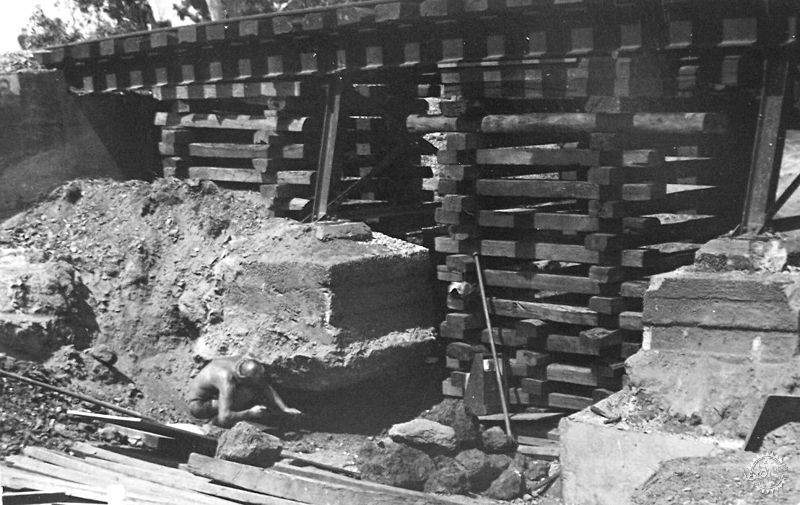

35. Shoring: Temporarily installed on site, shoring is the method in which metal or timber props are assembled to support the structure during construction. Shores can be installed vertically, horizontally, or diagonally, depending on the support needed.

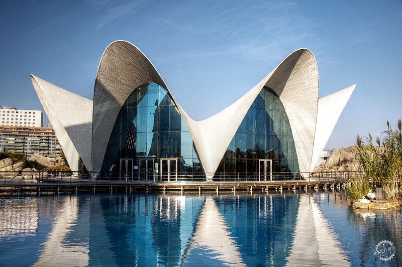

39、薄壳结构:该结构系统常常运用于现代建筑之中,薄壳结构是轻质混凝土构件,一般用于屋面。另外,这种结构系统可以利用结构的性能来减少其厚度,而一般呈现为弯曲形态。

39. Thin-Shell Structure: Frequently used in modern-day architecture, thin-shell structures are lightweight concrete elements, typically used on roofs. These large elements are usually curved, making use of the structural performance of certain forms to allow reduced material thickness.
