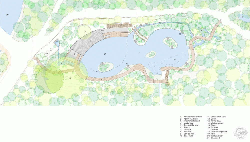

Picchio游客中心和溜冰场是Hoshinoya酒店综合体的一部分,它位于鸟类保护区旁边,曾经是一个废弃的冰球场,而现在是蜻蜓的繁殖地。
在夏季和秋季,建筑作为一个自然信息中心,游客可以在鸟类保护区附近远足。在冬天,它变成了一个会所的溜冰场。
The Picchio Visitors Centre and Ice Rink is part of the Hoshinoya Hotel complex, which is situated next to a bird sanctuary and a disused ice-hockey rink that is now a breeding ground for dragonflies.
In the summer and autumn, the structure functions as a nature and information centre from which visitors can depart on hikes around the bird sanctuary. In winter, it transforms into a clubhouse for the ice rink.

Klein Dytham建筑公司在一份声明中说:“Picchio项目围绕加强现有的所有现场设施。“新的溜冰场根据现场地形自然景观而设计,会所将场地的景色聚集在一起。”
该建筑物设有一对沿着溜冰场周边的弯曲墙壁,并参考冰上滑冰运动员形成的弧线创建了这条曲线。
"The Picchio project revolves around enhancing all of the existing site facilities," said Klein Dytham Architecture in a statement. "The new ice rink is naturally landscaped according to the site topography and the clubhouse brings together the site's dual purpose."
The building features a pair of curving walls that follow the perimeter of the rink and create sweeping lines intended to reference the arcs made by skaters on the ice.

离俱乐部会所最近的一个球场采用了冷却水管,有助于冰的结冰,使人们能够在赛季初滑冰。
人工冷却的区域用临时栏杆围起来,一旦池塘的其他部分结冰,就会被拆除。
The central bench also offers an ideal perch for looking out at the surrounding nature in summer, or lacing up skates and watching people on the ice in the winter. A widening of the floorplan towards one end of the building creates space for small informal events.
A section of the rink closest to the clubhouse incorporates cooling pipes that aid the freezing of the ice, making it possible to skate early in the season.
The artificially cooled area is lined with temporary railings, which are removed once the rest of the pond freezes naturally.

Klein Dytham Architecture说:“我们相信这是世界溜冰场的首例,结合了辅助冷冻和天然冰。建筑物、梯田、人行道和景观美化的形式是基于通过现场的自然水流。人们习惯于尊重现存的大自然,在池塘里建立了深冬池,这样鱼和其他生物就有地方生活,而那里的冰不会完全结冰。
"We believe this is the first time in the world an ice rink has combined both assisted freezing and natural ice," said Klein Dytham Architecture.
The forms of the building, terraces, walkways and landscaping are based on the natural flow of water through the site. Care was taken to respect the existing nature, with deep wintering pools created in the pond so fish and other creatures have somewhere to live where the ice doesn't freeze entirely.
