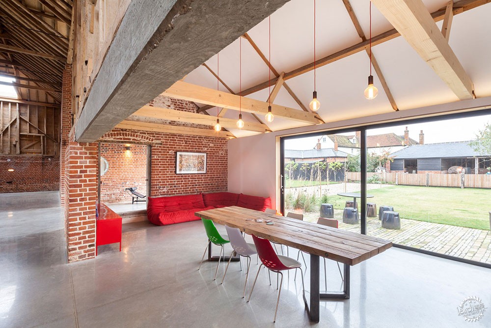

在原仓库立面开口处用镶嵌在方正木框内的玻璃进行填充,包括一组连接的餐厅空间与露台的滑动门。
建筑中央的人字形屋顶门廊目前配置了大玻璃推拉门,通过玻璃门可以直接看到从庭院到建筑后方的景色。
Original openings in the barn's facades are filled with glazing set back inside boxy wooden frames, including a set of sliding doors that connect the dining space with a terrace.
The hipped gable porches at the centre of the building now accommodate large glazed sliding doors that provide a view straight through from the entrance courtyard to the fields at the rear.

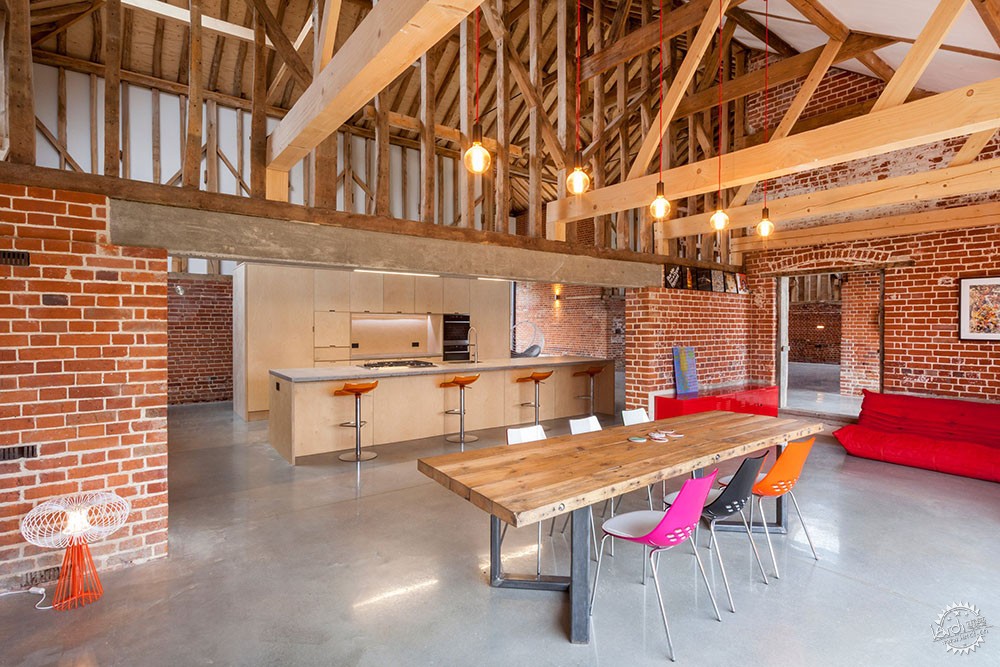

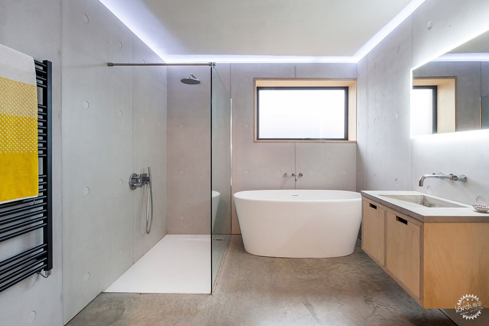

室内保持较大的开放性,以提高建筑的令人印象深刻的规模。增加了包括厨房单元、卧室和浴室在内的功能,这是由桦木贴面胶合板建造而成的。
The interior has been kept largely open plan to enhance the building's impressive scale. Additions including the kitchen units, bedrooms and bathrooms are constructed from birch-faced plywood.
砖结构仓库向宽敞住宅的改变/ David Nossiter Architects第14张图片
建筑师说:“保持空间尽可能开放的计划是在设计初期决定的。在必要时,分区和屏幕被设计为大型的独立家具。”
"It was decided early on during the design process to keep the spaces as open plan as possible," said the architects. "Where necessary, partitions and screens are designed as over-scaled freestanding furniture."

整个空间采用了光滑的混凝土地板,创建出连续的表面,只有中断设置对齐的主要空间在一条直线上留有10毫米缝隙。
混凝土进行了抛光,能反射一些通过窗户和设置在屋顶上的三个大天窗进入的日光。
A smooth concrete floor employed throughout the spaces creates a consistent surface interrupted only by 10-millimetre seams that are positioned in alignment with the main spatial features.
The concrete has a polished finish that reflects some of the daylight entering through the windows and three large skylights set into the roof.

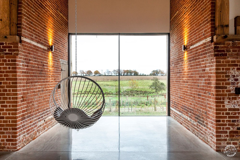

原有的开关盒用于操作新的照明系统,对结构进行集成照明和定向照明。在新结构的内部,内置在细木中的灯也能达到类似的效果。
Existing switch boxes are used to operate the new lighting systems, which are integrated into and directed to illuminate the structure. In new parts of the interior, the lights are built into the joinery to achieve a similar effect.
