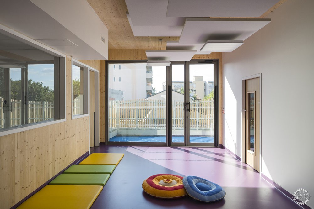

站在街道上看,这个设计就像一个立方体的游戏,托儿所颇有趣味的造型就好像用很多体块堆积起来一样,这些体块有着不同的材质和颜色。建筑和花园之间微妙的互动是用来转移城市建设规范所带来的约束。其场地的设计就好像一个从街道到地块中心的行走小道,小道旁有着一个接一个形式各样的花园和儿童生活空间。因此,托儿所是由两个要素组成:景观(从外部空间引进的光线、空气、植被、水)和建设项目。这两个元素之间相互重叠并且相互作用,以此来保持内外空间的不断流动。室内空间和花园空间的设计符合孩子的尺度:“对于我们这些成年人来说,我们所看到的草叶在孩子眼里就是一片森林。”
Designed like a game of cubes, seen from the street, the crèche asserts is playful character by the stacking up and setting of volumes of different materials and colors. A subtle play between the building and gardens is used to divert the constraints of the town planning regulations for the benefit of the building. The program is developed like a walking path from the street to the heart of the block, punctuated by a succession of different gardens and living spaces for children. Thus, the crèche is composed of two elements: the landscape (outside space bringing in light, air, vegetation, water) and the building containing the program. These two elements overlap and interact to maintain a constant flow between the outside and the inside. The interiors and gardens are designed at the scale of the child: "what we, adults, perceive as blades of grass, children perceive as the forest floor canopey”.

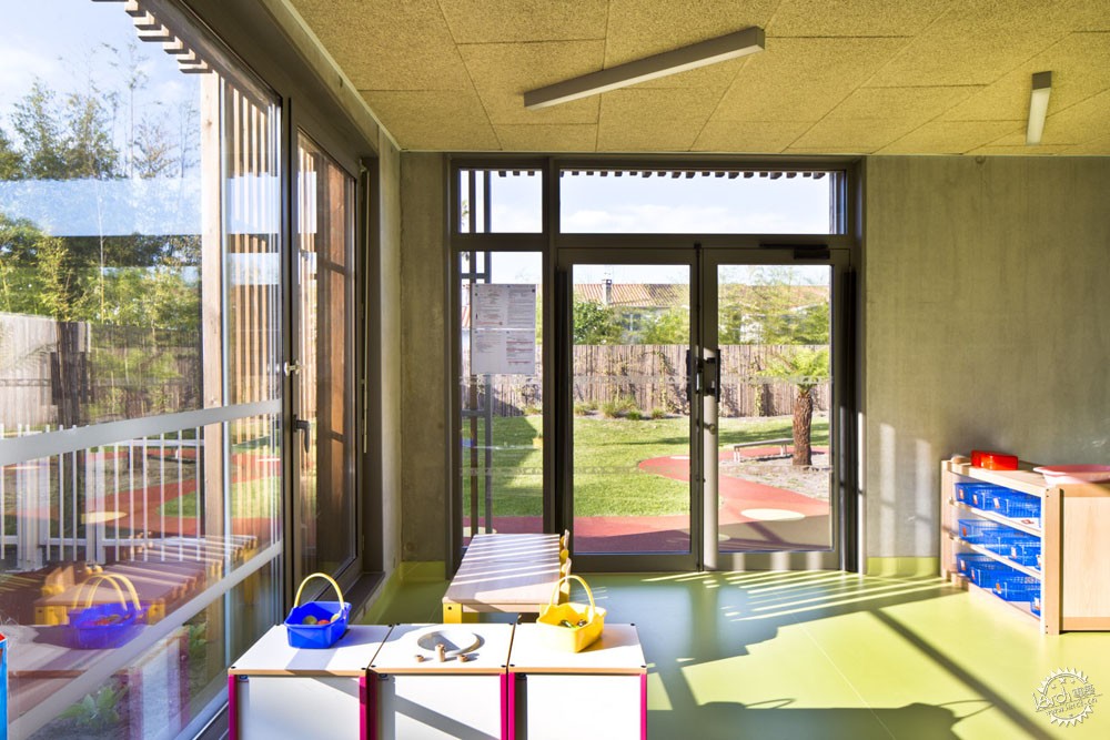

我们的灵感是基于以下几点:
——项目的位置和背景:附近的社区以住宅为主,那么创建一个识别性强的公共建筑就非常重要。但是,我们也想为孩子们创造一个“茧”,并且不让他们暴露在街上。这就是为什么我们将所有的技术用房和办公室布置在街道一侧,并且立面是相对封闭的。我们将建筑在室内一侧和花园处进行打开。
Our inspiration is based on several factors:
-The situation and the context of the project: the neighborhood is primarily residential, it seemed important to create a building that is identifiable as a public building. But we also wanted to create a “cocoon” for children and do not exposed them on the street. That’s why we have made the choice to position all the technical premises and offices one the street side, that’s why the facade is relatively closed. We opened the building on the interior side and the garden.
