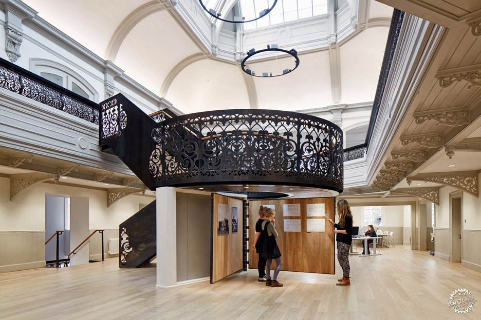

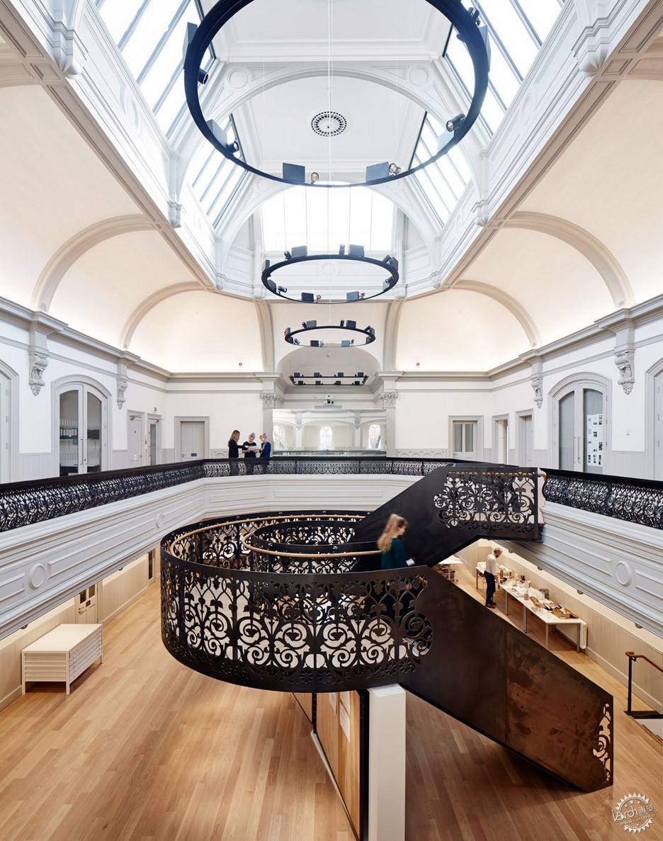

教学空间围绕着通高的中庭,被画廊包围。
明亮的中心空间和它的拱形天花板,参考其历史细节来鼓励当代元素的添加,包括圆形的像烛台一样悬挂的灯具和雕塑感的楼梯。
The teaching spaces are organised around a double-height atrium encircled by a gallery.
This bright central space, with its vaulted ceiling, inspired contemporary additions that reference its historical details, including circular candelabra-like suspended light fittings and the sculptural staircase.

楼梯在建筑的两层之间提供了方便的中心连接工作,与走廊的装饰栏杆交叉。
它错综复杂的蚀刻表面使用水射流切割,辅以橡木实木踏板和弯曲的木扶手。
The staircase provides a convenient central connection between the building's two upper levels and intersects with the gallery's ornamental balustrade.
Its intricately etched surfaces, which were cut using a water jet, are complemented by solid oak treads and a curving wooden handrail.
新诺维奇建筑学院的装饰楼梯/Hudson Architects第5张图片
“这已经是一个非常有趣的建筑,有一个很大的中庭空间,我们想为该学校的建筑保留,”建筑师Russell Canham告诉Dezeen。
“对中庭的主要干预是一个简单的铁楼梯,有高压水射流切割的栏杆,参考了现有的19世纪铸铁详图和复制了它的精神,但不能直接应用。”
"It was already quite an interesting building with a large atrium space that we wanted to keep for the school of architecture," architect Russell Canham told Dezeen.
"The main intervention in the atrium is a simple steel stair with a water jet-cut balustrade that picks up on existing 19th-century cast iron detailing and copies it in spirit, but not in direct application."

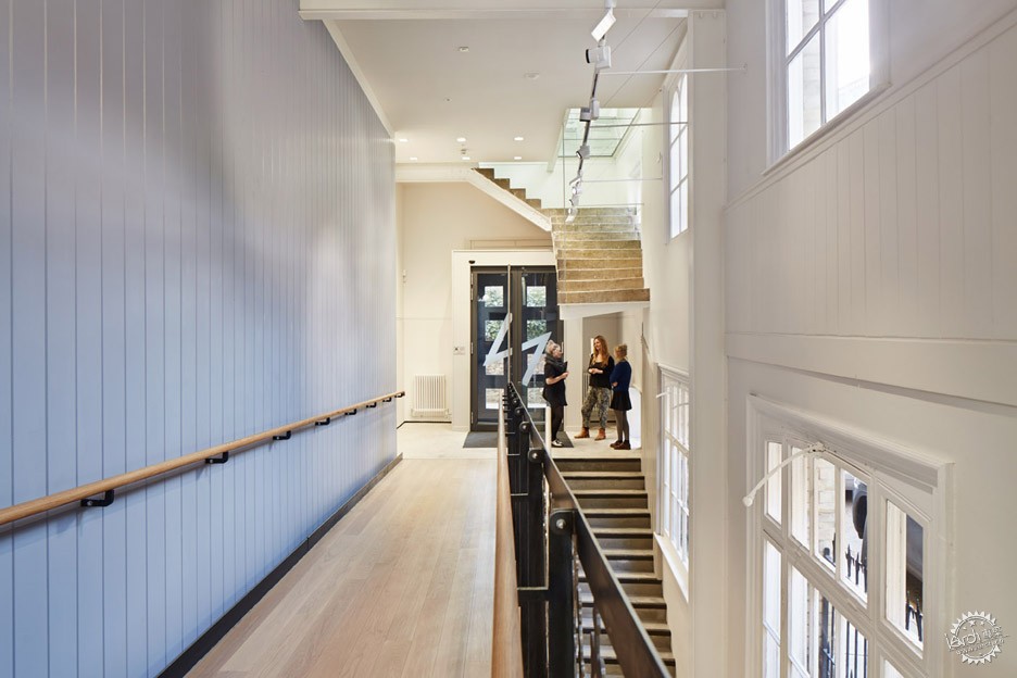

新诺维奇建筑学院的装饰楼梯/Hudson Architects第9张图片
其他保存的细节包括新的主入口上面原始楼梯的一部分,从楼梯到地下室,加强这个空间的作为流通领域的概念。
楼梯已经在之前的装修中变得多余,部分被拆除,为电梯提供空间。它的存在,结合相邻的玻璃天花板,有助于唤起原始空间的高度感。
Other preserved details include part of an original staircase above the new main entrance, which projects over the stairs down to the basement to reinforce the notion of this space's original purpose as a circulation area.
The staircase had become redundant during previous renovations and was partly dismantled to make room for a lift shaft. Its presence, combined with an adjacent glass ceiling, helps to evoke the original space's sense of height.

入口旁边的一个画廊可以用来展示学生的作品,而一套旋转显示板位于大厅的旋转楼梯底部,为演示文稿提供空间。

A gallery next to the entrance can be used to present students' work, while a set of pivoting display boards slotted beneath the circular staircase in the main hall provides space for pinning up presentations.

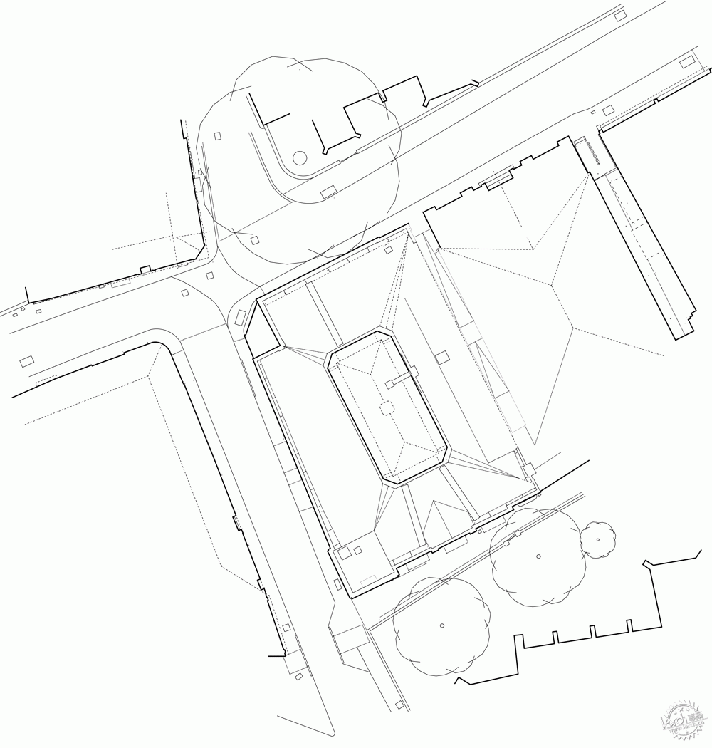

Site plan/场地平面图
