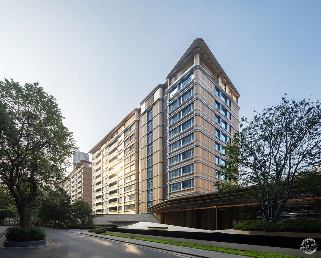

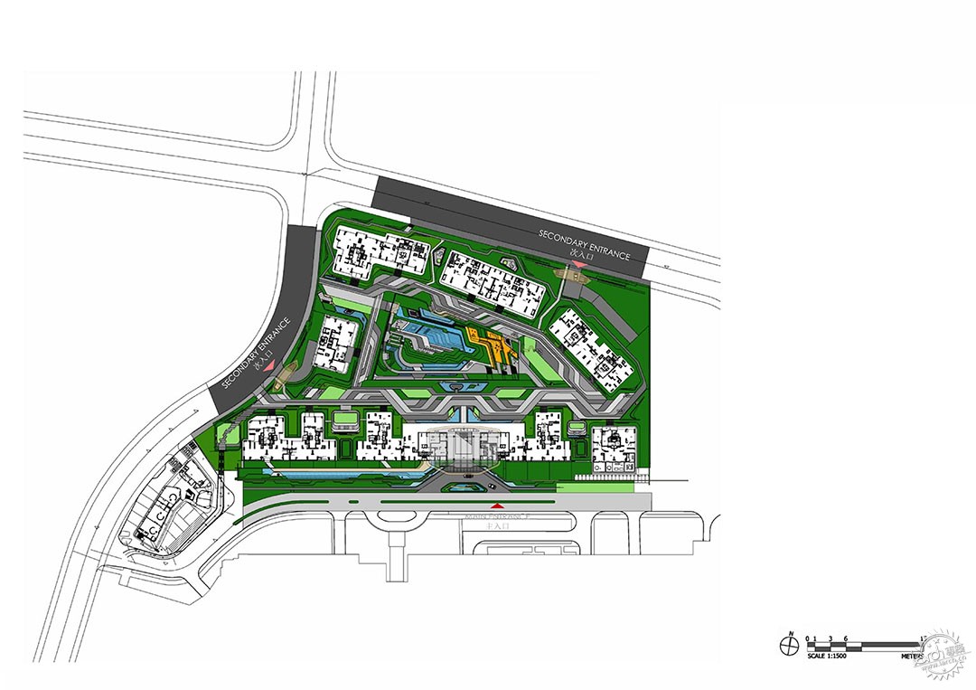

01 项目概况
项目位于广州的一处隐秘腹地,是2km景观绿轴的终点。设计者将建筑想象为都汇秘林,在车水马龙的城中打造隐于市的一方桃源。作为社区景观廊道的延续,项目顺应地势,打造了1.3万㎡的下沉式三层立体园林。这组由14座42m高的小高层建筑围合成的群落,是一组带有未来式宣言的建筑。在限定的408户样本中,建筑与设备自成体系,拥有自适应的冷热循环及先进的通风系统,被誉为“会呼吸的建筑”。
01 Overview
Located in the most secluded hinterland in Guangzhou, The Peakview is the endpoint of the 2km green axis. Imagined as a secret forest gathering point in the bustling city, the project was built as a hidden paradise. As a continuation of the green line of the community, the project utilises the terrain and creates a sunken garden of 13,000sqm. This low-density cluster, consisting of 14 structures with a height of 42m, is making a futuristic declaration. Among the limited sample of 408 households, architecture and equipment are self-contained as a complete system, with adaptive cold-and-hot cycles and an advanced ventilation system, which is known as the ‘breathing building’.

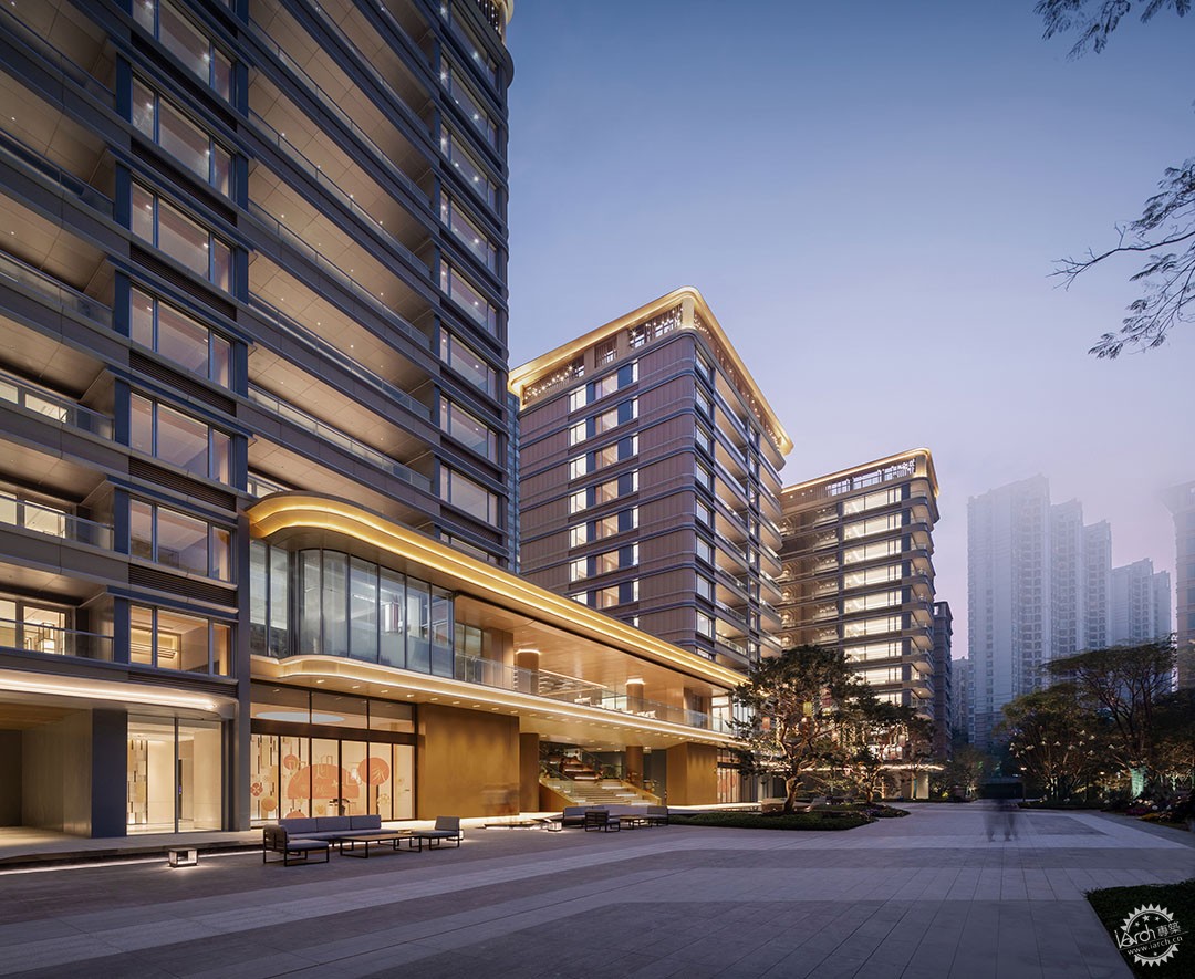

E3实验住宅:“设备即建筑”的新型范式探索第2张图片
▲立面细部, Details ©是然建筑摄影

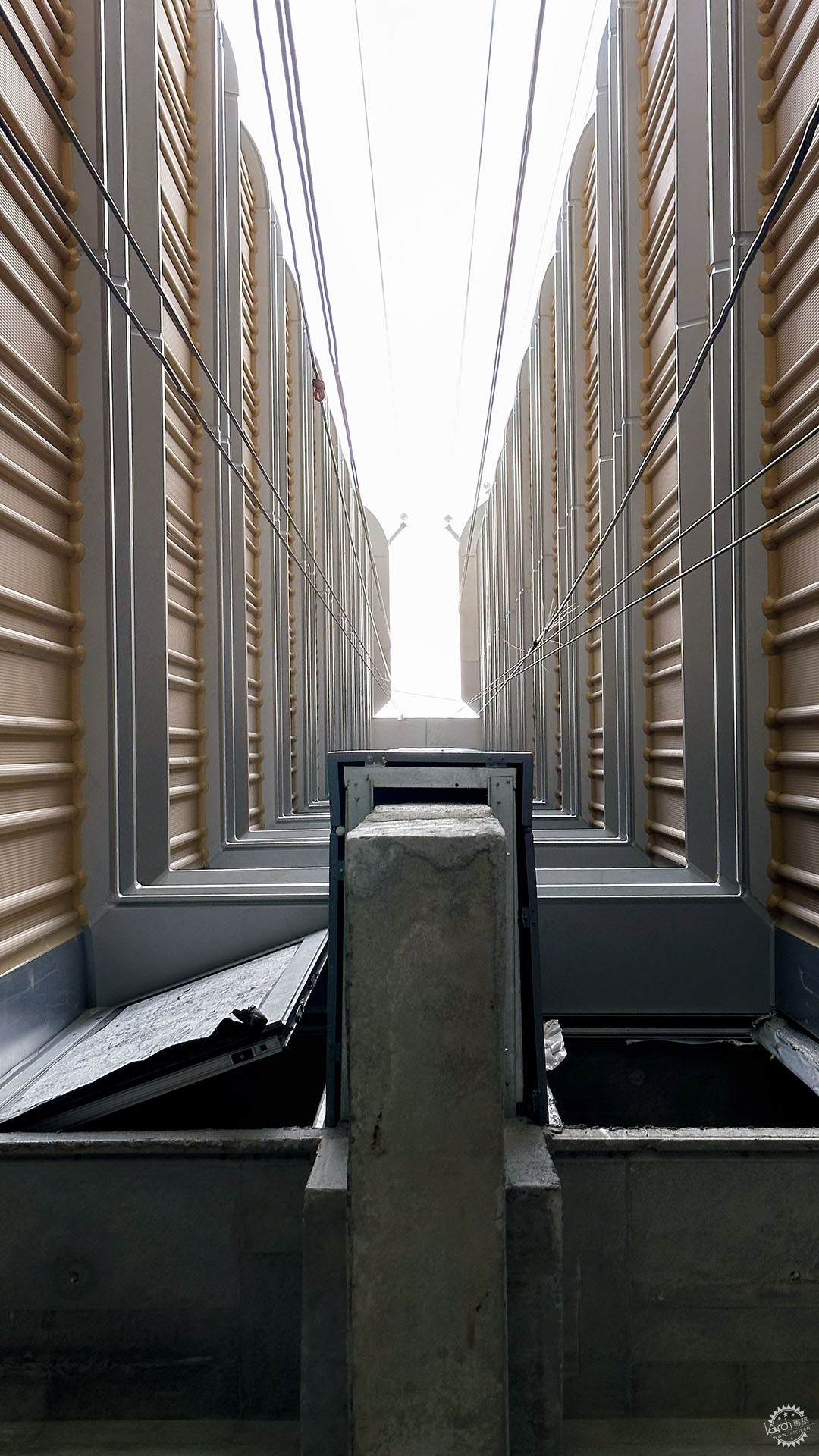

02 设备建筑一体化

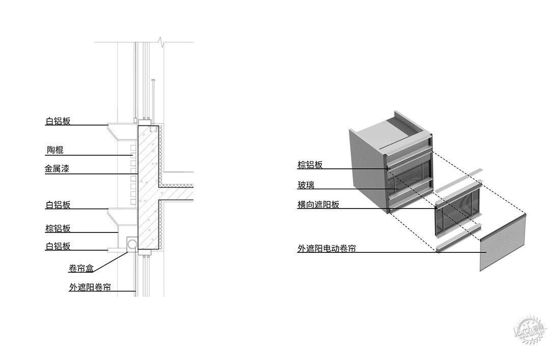

得益于“恒适系统”的赋能,建筑可自主完成供暖、制冷和通风。“恒适系统”是一种比传统空调舒适度更高的空气调节系统,在高保温隔热的外围护基础上,采用毛细辐射对室内进行制冷或采暖。这是通过由陶瓷面板、铝板、断热铝合金双面Low-E镀银玻璃与外遮阳电动卷帘组成的体系实现的。设计能够有效地隔绝热气,减少建筑的冷却负荷,增强建筑的韧性。当需要供暖或制冷时,从每楼栋地下设备房汲取的水源通过内嵌入墙的毛细辐射管道循环流动,而达到控温的目的。
02 Equipment-building integration
Empowered by the 'Constant System', the heating, cooling, and ventilation inside these buildings can be independently managed. The ‘Constant System’ is an air conditioning system with higher level of comfort than traditional ones, which adopts capillary radiation to cool or heat the indoor environment based on insulation and heat preservation. This is achieved through a system composed of ceramic panels, aluminium panels, insulated aluminium alloy double-sided Low-E silver plated glass, and the external sunshade electric roller blinds. Such design can effectively isolate the exterior heat and reducing the cooling load of the structure, which ultimately enhances the general resilience of the project. When heating or cooling is required, water that drawn from equipment rooms under each building respectively circulates through capillary radiation pipes embedded in the walls to achieve temperature control.

E3实验住宅:“设备即建筑”的新型范式探索第8张图片
▲“恒适系统”外立面大样分析, Analysis Diagram of Façade © spdg

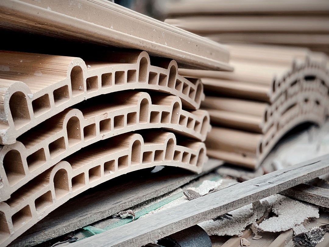

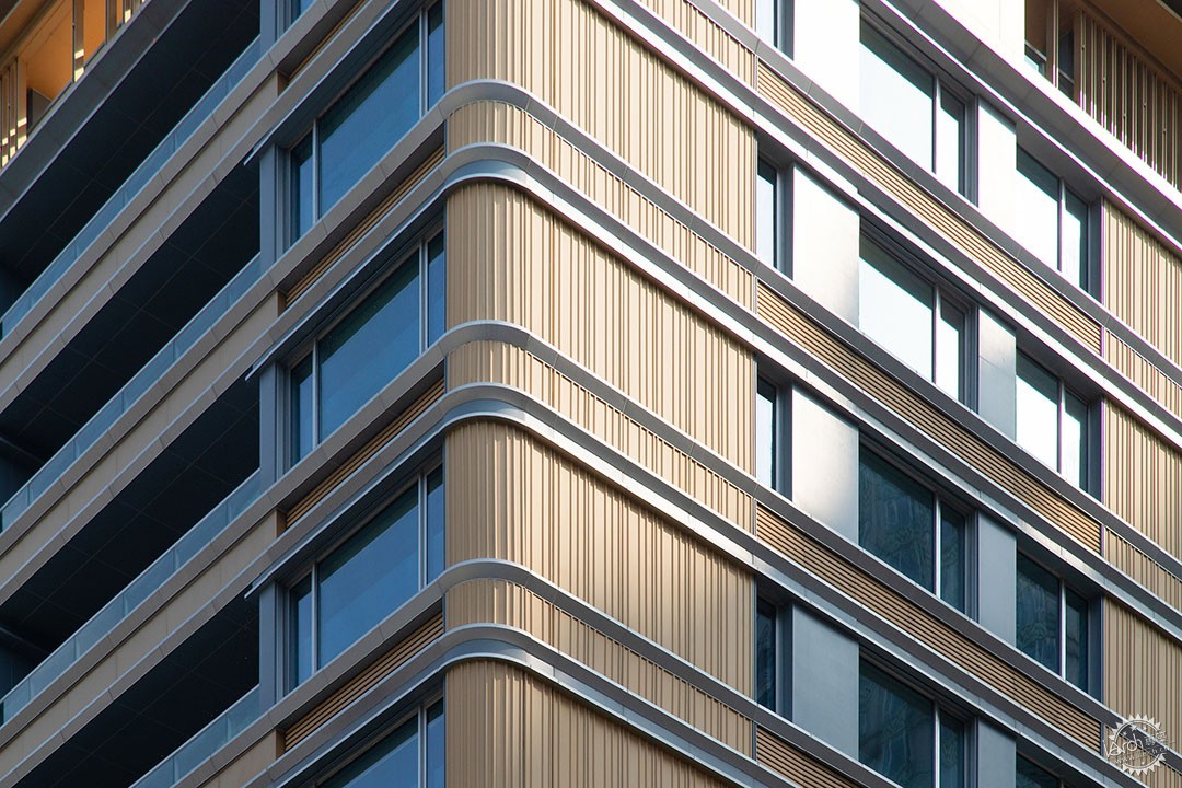

03 高-低技结合

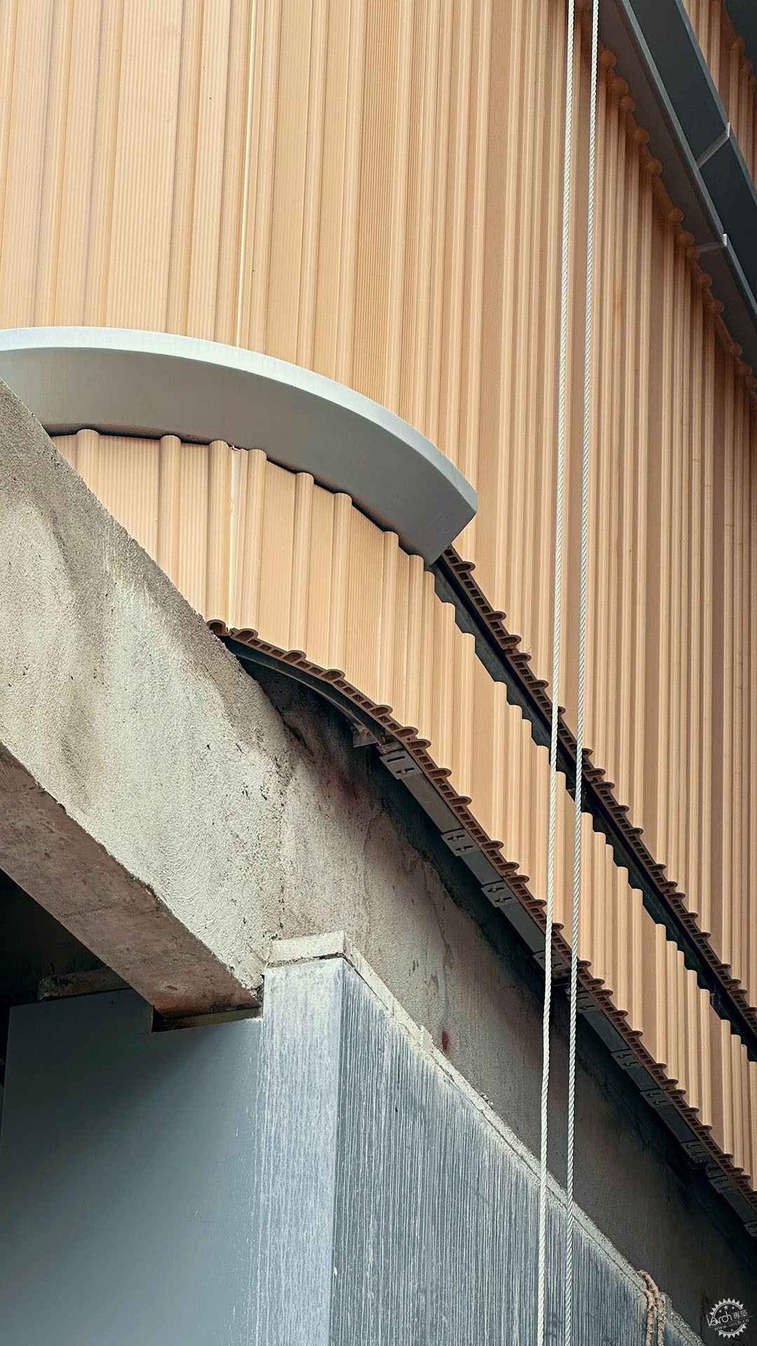

建筑立面采用陶板,是以建筑科学的角度再诠释传统的可再生材料。以黏土为基础材料,挤压成型,具有优异的耐久性,低技术生产的陶板完全覆盖建筑物的表面,为建筑提供了必要的遮阳,其独特的中空设计不但减轻了自身的重量,更促进了建筑表皮的空气流动。在夏日有助于隔热,在冬天能减缓释放热能的速度,有效降低建筑内外热传导,尽可能使建筑在全年保持恒温状态。与玻璃幕墙体系不同,陶材料表面满布孔隙,这种多孔结构可吸收部分声波,减少北侧和东侧快速路的噪音干扰。
03 Integration of High-Low Techs
Adopting a façade of ceramic panels, the project interprets traditional renewable materials from the perspective of Building Science. With clay as the basic material and extruded into shape, making it has excellent durability, the surface of building is fully covered with the low-tech produced ceramic panels. In addition to providing necessary shading for the building, such a unique hollow design reduces its weight, while improving air flow on the surface. Theoretically, the façade does help with insulation in summer and slows down the heat release in winter, ensuring the whole building at a stably and comfortable temperature range throughout the year. Unlike glass curtain wall systems, the material of ceramic is covered with pores, which can absorb sound waves and limit noise interference from expressways.

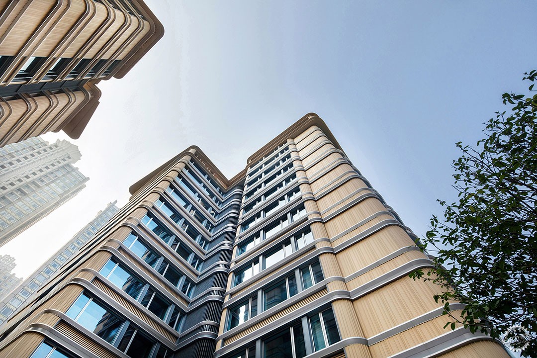

E3实验住宅:“设备即建筑”的新型范式探索第11张图片
▲陶瓷材质立面, façade made of ceramic©是然建筑摄影

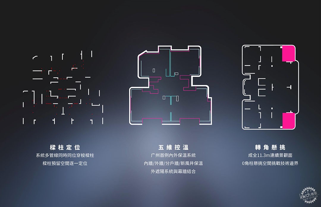

E3实验住宅:“设备即建筑”的新型范式探索第12张图片
▲“恒适系统”分析, Analysis Diagram of‘Constant System’© spdg
建筑造型趋向于有机形态,刻意保留圆角与弧形,除了来自大自然的灵感,更重要的是弧形有利于气流循环,使建筑的热增益分布更均匀。为维持恒适系统运行效率最大化,建筑结构采用了五重保温隔热设计,对建筑不同墙体结构使用定制化的保温材料和策略。经能耗测算,全套技术体系的应用能使建筑达到70%-90%节能标准,比参照样本节约30%。
The style of architectural form tends to organic, deliberately retaining rounded corners and arcs. In addition to drawing inspiration from the nature, even more important though is the fact that arcs and rounded corners facilitate airflow circulation and delivering a more mild distribution of thermal gains. To maintain the maximum operational efficiency of the system, the structure adopts a five-fold heat-preservation design, and tailoring insulation materials and strategies for different components of the building. According to the energy consumption analysis, the application of a complete set of system enables buildings to achieve 70%-90% energy saving, reducing 30% compared to reference samples.

E3实验住宅:“设备即建筑”的新型范式探索第17张图片
▲建造中的幕墙细部, Details of Curtain Wall under Construction © spdg
E3实验住宅:“设备即建筑”的新型范式探索第18张图片
▲陶瓷幕墙构件, Components of Ceramic Curtain Wall © spdg
