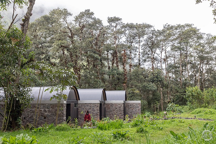

Guango旅馆中的Las Pajareras项目由3个建筑模块组成,每个模块都可灵活布局,且都设计有卧室、浴室以及门廊,在门廊中可以欣赏Papallacta河的美景。设计师还预留了公共活动区域、室外小型浴池以及更衣区域,方便以后扩建。在该项目设计过程中,因石油管道地役权的原因,建设用地被规划在峡谷周边的狭长地带,设计师为了使得建筑与自然环境相互融合,将建筑定位进行了偏移,使其更加巧妙地融入到自然环境中去。
在该项目的设计过程中,首先要考虑的是建筑的可持续发展性。因此,设计团队在建造材料上主选当地材料,还为建筑设计了一个废水处理厂。建筑采用了由农业废弃物制成的BIOM热隔音材料,利于环境保护。
Las Pajareras at Guango Lodge consists of three guest modules, each offering a flexible room layout, private bathroom, and a porch with stunning views of the Papallacta River. A future phase includes a communal area with a small outdoor hot pool and changing facilities. Due to an oil pipeline easement, construction was limited to a narrow strip of land along the ravine. The architects responded with a design that respects the surroundings. The three modules, with their slightly offset positioning, subtly integrate into the landscape.
Sustainability was a key consideration. The design team makes use of local materials and incorporates a wastewater treatment plant for the entire lodge. The innovative use of BIOM thermo-acoustic insulation, made from agricultural waste, further reduces the environmental footprint.

▲ Las Pajareras项目由三个建筑模块组成,每个模块均设计有卧室、浴室和观看河景的门廊
Las Pajareras features three guest modules with flexible layouts, private bathrooms, and porches with river views
