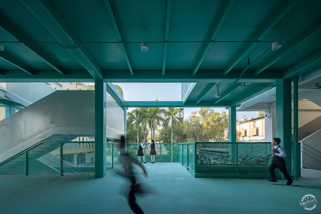

Building Energy Saving Retrofit in Liu Lian Primary School / FORWARD STUDIO. Image © Tianpei Zeng

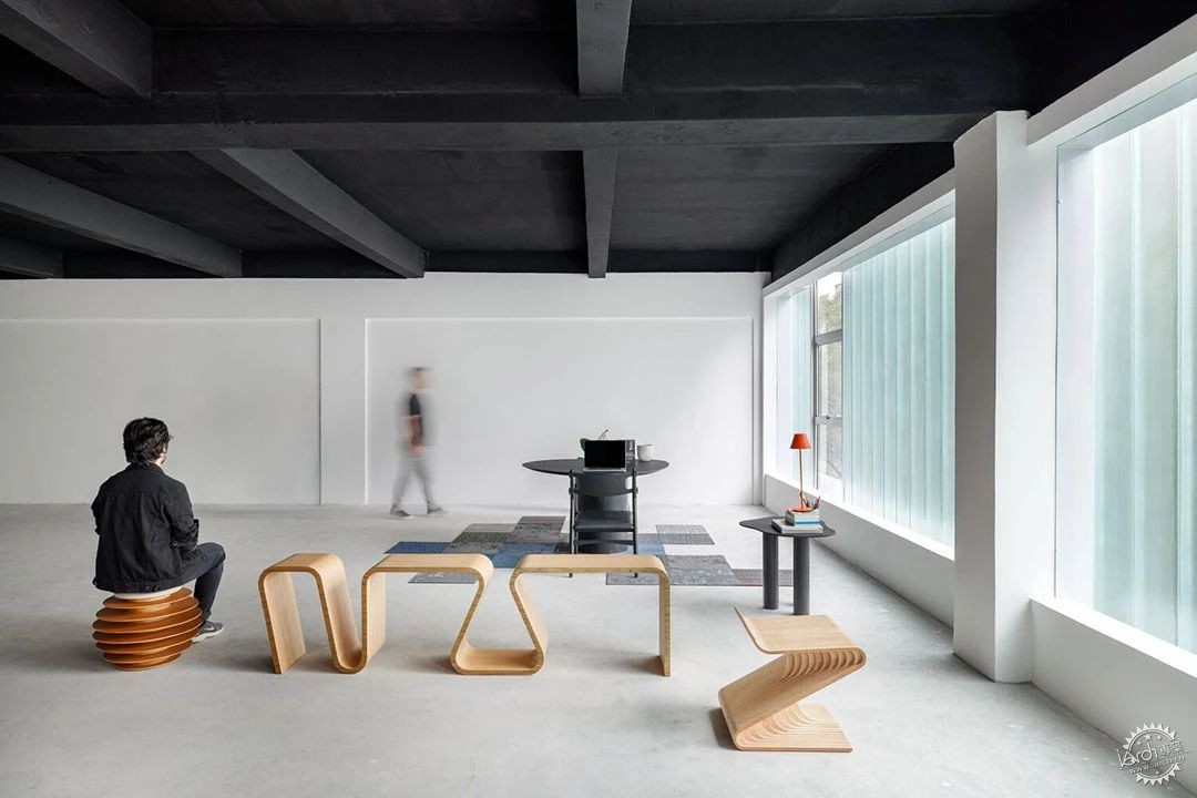

Timber Adaptive Reuse Theater / CO Adaptive. Image Courtesy of CO Adaptive Architecture

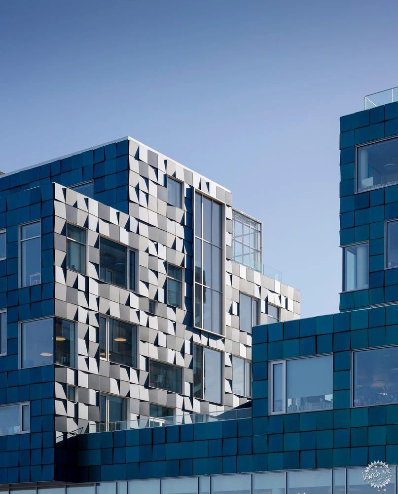

Copenhagen International School Nordhavn / C.F. Møller. Image © Adam Mørk

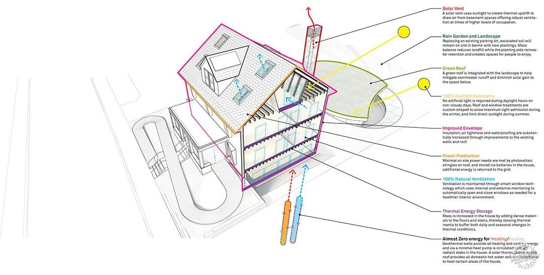

Despite its environmental provisions, ZeroHouse also places an emphasis on user-friendly design. Image Courtesy of Snøhetta and Plompmozes

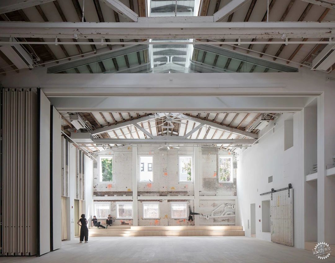

Retrofit Brigadeiro / Coletivo de Arquitetos. Image © Max Fahrer
