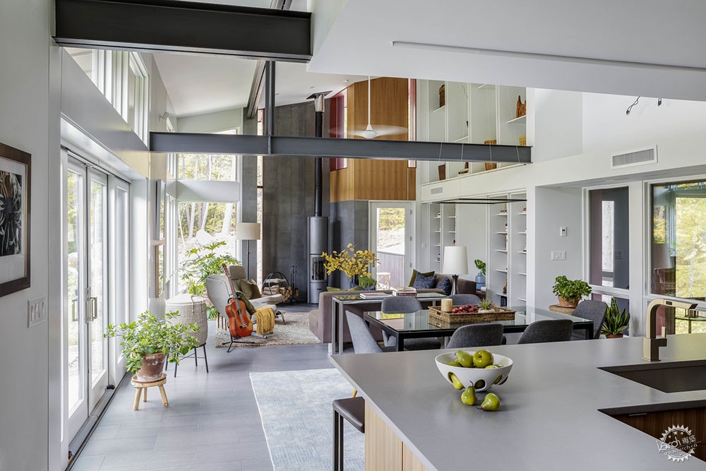

来自大自然的馈赠。Jenson-DeLeeuw之家将充满光亮的舒适生活空间与自然融为一体。它的选址和角度都经过精心设计,位于乡村风景中的平缓高地上,为居住者提供了宜人的自然风景,同时通过可再生能源技术利用太阳的路径进行发电。清洁能源系统(光伏+电池)生产能源并节约能耗。
Drawing from Nature, The Jenson-DeLeeuw House combines light-filled, comfortable living spaces, integrated into nature. It is carefully sited and angled on a gentle elevation amid a rustic rural landscape. This gives its occupants pleasant natural scenery while harnessing the sun’s path for electricity generation through renewable-energy technologies. The clean-energy systems (PV + Batteries)  generate and conserve energy.

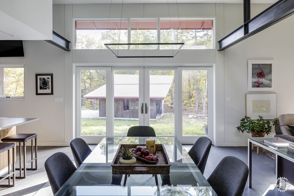

被动式太阳能设计。南向墙面的宽大窗户使室内充满自然光,同时在冬季也能保持明亮。屋顶出挑使房间免于过度暴露和暴晒。开放式平面和较高的天花板使自然通风和空气流动贯穿始终。在冬季,三层玻璃窗、隔热墙(R43)和低渗透的细节设计优化了内部的温度,起居室-餐厅-厨房空间的木制火炉可以在最冷的日子里提供补充性的热源。
Passive Solar Design. The southern wall’s expansive windows flood the interiors with natural light and wintertime heat. Deep roof overhangs shield rooms from overexposure and overheating. Open-floor plans and high ceilings enable natural ventilation and airflow throughout. In winter, triple-glazed windows, insulated walls (R 43), and low-infiltration detailing optimize solar warmth. A wood stove in the living-dining-kitchen space provides supplemental heating on the coldest days.
