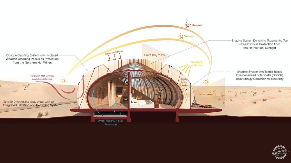

居住舱径向遮阳板设计的主要想法是通过自遮阳来提高建筑的环境热工性能。该设计的灵感来自大自然和沙漠仙人掌物种的例子,它们的特点是具有厚的表皮、折叠表皮能够散热和减小太阳辐射角度,径向遮阳板是通过部署60个铰接遮阳板而实现的,它们创造了一个被密集格子遮蔽的小屋。
Sustainability.The main idea behind the radial shading panels dressing the cabin is to improve the environmental performance of the building through self-shading. The design is inspired by nature and several examples of desertic cacti species that feature thick outer skins, folding, and fins that diffuse heat and solar radiation. This is materialized through the deployment of sixty articulated shading panels which create a dense lattice sheltering the cabin.
“沙漠之花”——居住舱仿生节能设计第5张图片
© AIDIA STUDIO
为了适应居住舱的曲率,面板向顶部聚集,这样做增加了折板的反射能力,以应对严酷的垂直太阳辐射。由于阿拉伯半岛RUB AL KHALI沙漠,人称“空白之地”,不缺乏阳光,该设计建议将高度灵活的高敏化太阳能电池(DSSCs)染料整合到遮阳织物中,通过将纺织电极缝制到遮阳织物中来生产。
To adapt to the curvature of the pod, the panels densify towards the crown and in doing so augmenting their reflective capability from the harsh vertical sun radiation. As the Empty Quarter has no shortage of sunlight, the design proposed to incorporate highly flexible dye-sensitized solar cells (DSSCs) which would be produced by sewing textile electrodes into the shading fabric.
“沙漠之花”——居住舱仿生节能设计第6张图片
© AIDIA STUDIO
由于纺织品的大覆盖范围和DSSC电池产生光伏电力的能力,即使在低亮度照明下,产生的电力也足以支持每个舱室的需求。该居住舱还将配备一个水箱,其中包括一个过滤废水和回收净水的系统。
Due to the large coverage of the textile and the ability of the DSSC cells to produce photovoltaic electric power, even in low-level lighting, the power produced should be sufficient for supporting the needs of each cabin. The pod will additionally be equipped with a water tank which includes a filtration and recycling system of grey waters.

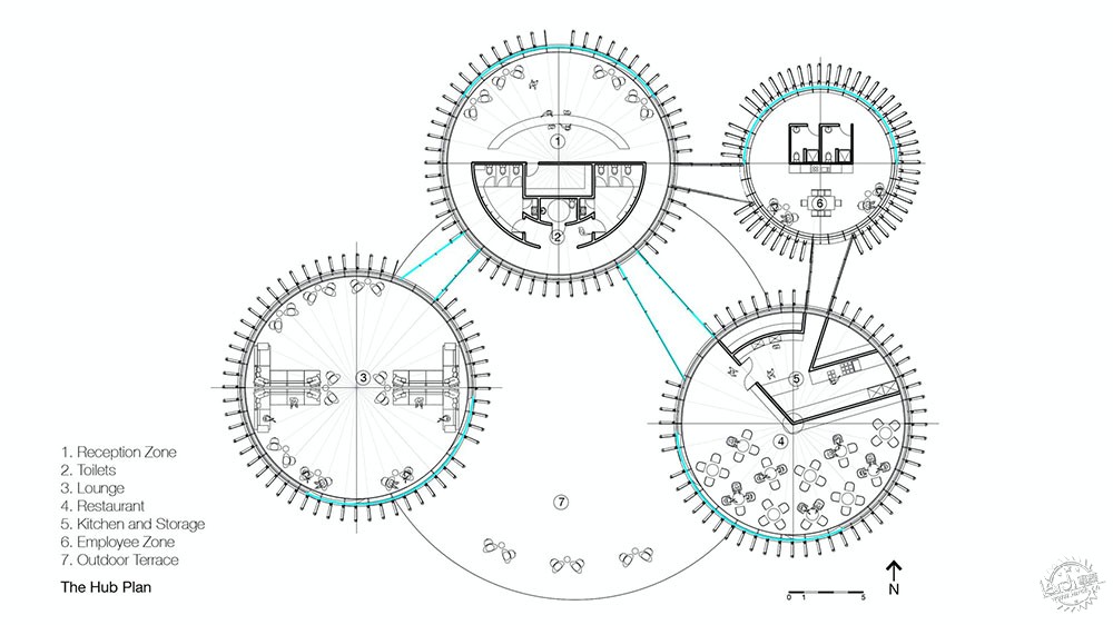

平面的中心分为四个独立建筑,每个建筑都拥有不同的功能,包括接待和客人厕所,接待休息室、餐厅和厨房,以及员工附属功能。所有舱室都通过过渡套节点相互连接,并由一个升高的室外平台连接在一起。接待休息室的内部采用了自然材料,将视线焦点放在远处的沙丘上。
The hub is divided into four independent buildings, each hosting a different function: reception and guest toilets, reception lounge, restaurant and kitchen, and staff functions. All pods are interconnected via transition sleeves and held together by an elevated outdoor deck. The interiors of the reception lounge are fitted with natural materials bringing the focus to the dunes beyond.
“沙漠之花”——居住舱仿生节能设计第13张图片
© AIDIA STUDIO
悬挂在天花板上的轻质织物装置的灵感来自于游牧帐篷结构,为舱室中心的主要区域带来了柔性屋面和优质的声学性能。总面积达到3500平方米,25个舱室,标准层面积50平方米,VIP室 80平方米。整体材料、模块化木肋系统集成双层玻璃与太阳能控制涂层、绝缘木包层模块化遮阳系统、滑动开轨与纺织染料敏化太阳能电池(DSSCS)。由AIDIA建筑事务所设计,该作品荣获国际公开竞赛第二名。
A light, fabric installation hanging from the ceiling is inspired by nomadic tent structures and brings softness and acoustic performance to the main zone of the hub.Total Area: 3500 sqm, 25 cabins, Standard: 50sqm, VIP: 80 sqmMaterials: – Modular Wooden Rib System with Integrated Double Glazing with Solar Control Coating or Insulated Wooden Cladding- Modular Shading System Sliding Open on Rails with Textile-Based Dye-Sensitized Solar Cells (DSSCs)Design: AIDIA STUDIOTeam: Natalia Wrzask, Rolando Rodriguez LealAwards: 2nd Prize in the International Open Competition by Beebreeders and the Environment Agency Abu Dhabi.
