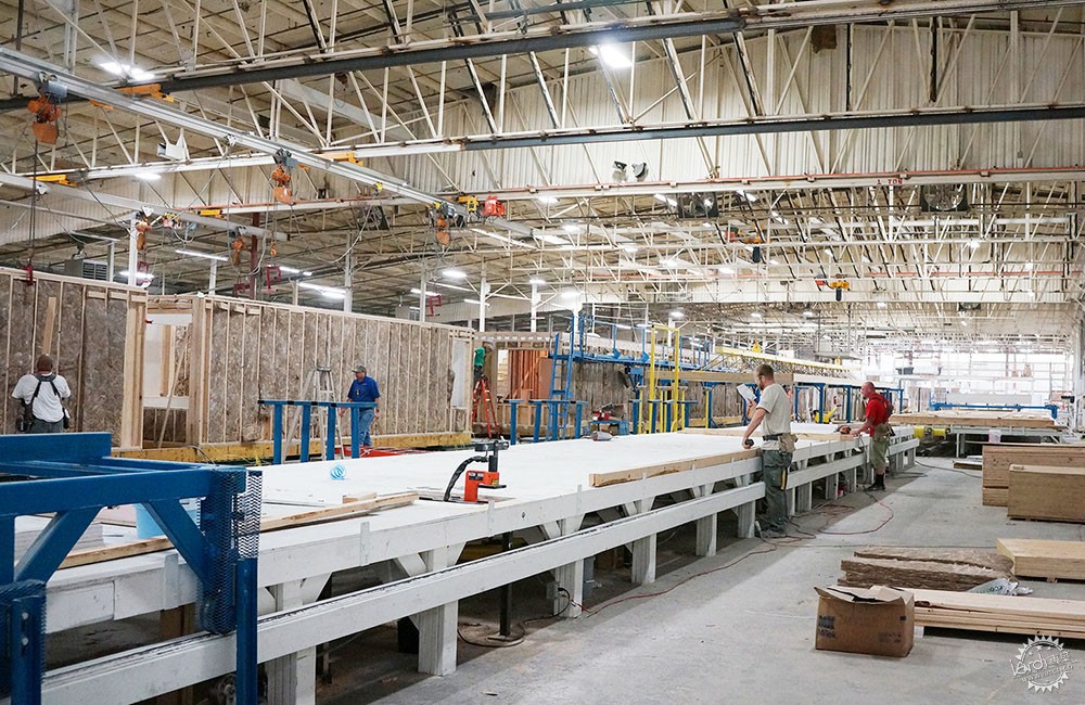

模块化建筑到底是什么?
模块化建筑研究所是这一主题的最重要的资源,根据该研究所的说法:“模块化建筑是一个过程,在这一过程中,建筑是在非现场且受控的工厂条件下建造的,使用相同的材料,并按照与传统建筑设施相同的规范和标准进行设计,但只需一半的时间”。模块化建筑也有点像一个总称,它包括了几种不同类型的建筑。
  • 体积式模块化建筑(模块化建筑协会的首选)是一个过程,在这个过程中,整个房间或部分房间——包括墙壁、地板和天花板,都在工厂环境中建造,然后运输到最终地点进行组装。这种类型的建筑既适用于永久性的模块化项目,也适用于可移动的模块化项目,其中包括不能移动的建筑与可以移动的建筑;如酒店与临时教室。
  • 板式建筑是指在工厂环境中建造内墙/外墙板,然后运输到建筑工地并在工地上布置的过程。建筑物的其余部分在现场建造。
What does 'modular construction' mean exactly?
Per the Modular Building Institute, the foremost resource on the topic, “modular construction is a process in which a building is constructed off-site, under controlled plant conditions, using the same materials and designing to the same codes and standards as conventionally built facilities – but in about half the time." Modular construction is also a bit of an umbrella term that includes a couple of different types of construction:
  • Volumetric modular construction (preferred by the Modular Building Institute) is a process in which entire rooms or sections of rooms—complete with walls, floors, and ceilings—are built in a factory setting and then transported to a final site for assembly. This type of construction is used for both permanent and relocatable modular projects (buildings that aren’t designed to be moved versus those that are; think a hotel versus a temporary classroom).
  • Panelized construction is a process in which interior and/or exterior wall panels are built in a factory setting and then transported to and arranged on the building site. The rest of the building is constructed on-site.

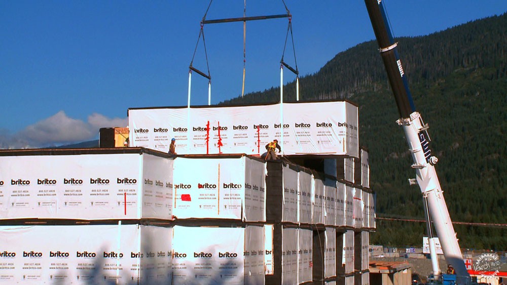

它可以用于任何类型的建筑吗?在哪些情况下选择模块化建筑比传统方法更方便?
任何类型的建筑都可以用模块化方式建造。但要做到这一点,必须对建筑进行这样的构思和设计。在时间紧迫或空间有限的情况下,往往会选择模块化建筑。例如,在欧洲,城市地段往往受到道路和其他建筑物的限制,因此传统的建筑方式(将材料和工人长时间运到现场)可能会非常困难。而采用模块化建筑,你只需要一台起重机和较少的人员,就可以在更短的时间内把建筑搭建起来。而且,在狭窄的城市中,减少噪音污染也是一大优势。
Can it be used for any type of building? In which cases is it convenient to choose modular construction rather than traditional methods?
Any type of building can be built modularly. But to do so, the building has to be conceived of and designed as such. Modular construction is often chosen when time is of the essence or space is at a premium. For example, in Europe, urban lots are very often constrained by roads and other buildings, so building traditionally (bringing materials and workers onsite for an extended period of time) can be prohibitive. With modular construction, you need a crane and far less personnel to erect the building in less time. And, in tight urban locations, the reduction of noise pollution is an added benefit.
