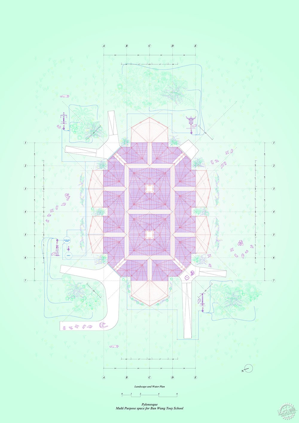

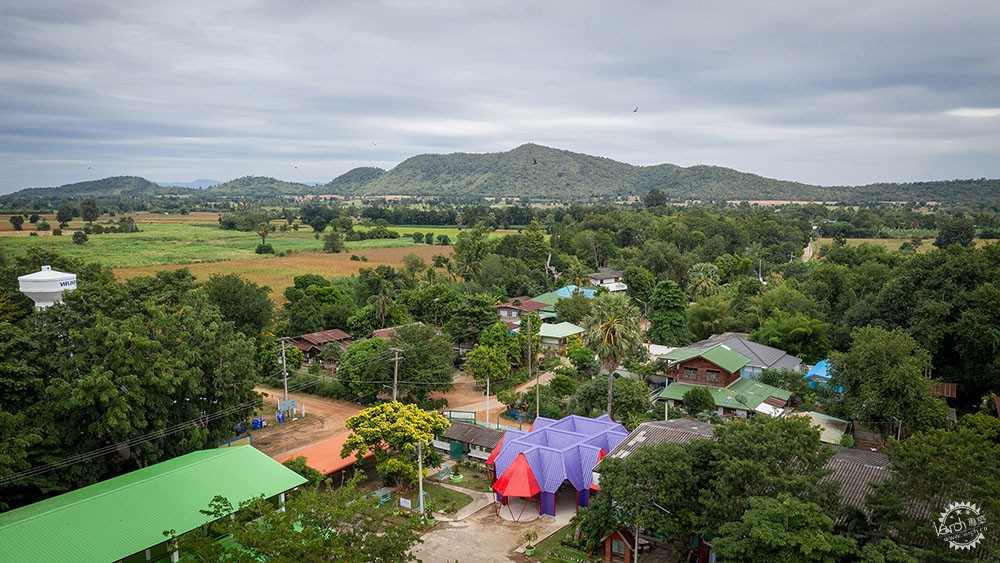

Pareid建筑工作室和朱拉隆功大学的学生在泰国西部的两个集水漏斗周围建造了一个开放式的教室。

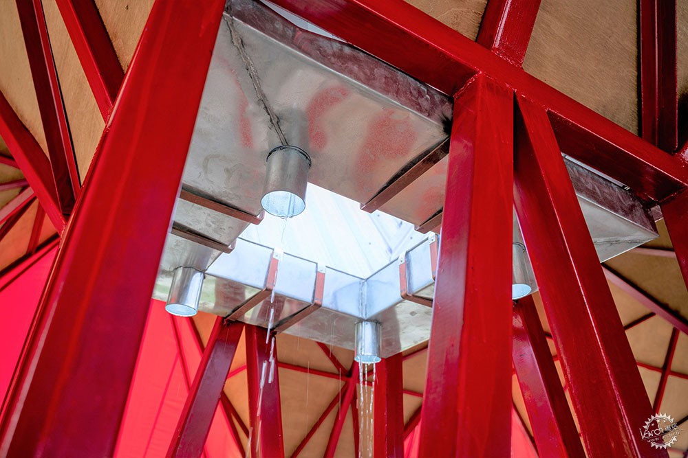

这间名为“Pylonesque”的教室是泰国Uthai Thani省Ban Wang Toey学校一个附加的空间。它被一个由两个漏斗组成的屋顶所覆盖,这些漏斗可以收集水,并把它们输送到地下储存容器。
Pareid建筑工作室的联合创始人Hadin Charbel说:“他希望这座建筑既是教室,也是一个看得见的集水结构,以展示水对学校学生的重要性。”
Architecture studio Pareid and students from Chulalongkorn University have built an open-walled classroom around two water collecting funnels in western Thailand.
Called Pylonesque, the classroom was created as an additional space at the Ban Wang Toey School in the Thai province of Uthai Thani. It is covered by a roof made of two funnels that collect water and channel it to storage containers underground.
Hadin Charbel, co-founder of Pareid, said he wanted the building to be both a classroom and a visible water collection structure to demonstrate the importance of water to the school's students.

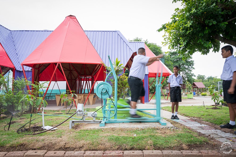

为强调这一设计理念,设计师还在教室周围放置了机械设备,这为储存水源提供了动力。
"The project is located in a very rural part of Thailand, where running water in some instances is not as easily accessible as one might assume," he told Dezeen.
"It seemed fitting that a multi-use space at a local school could integrate architecture and local strategies as more than just a practical response, but one that would stimulate the students, while also making water collection accessible, transparent and a conscientious act."
To reinforce this, exercise machines have been placed around the classroom to power pumps that move the water between the underground storage areas.

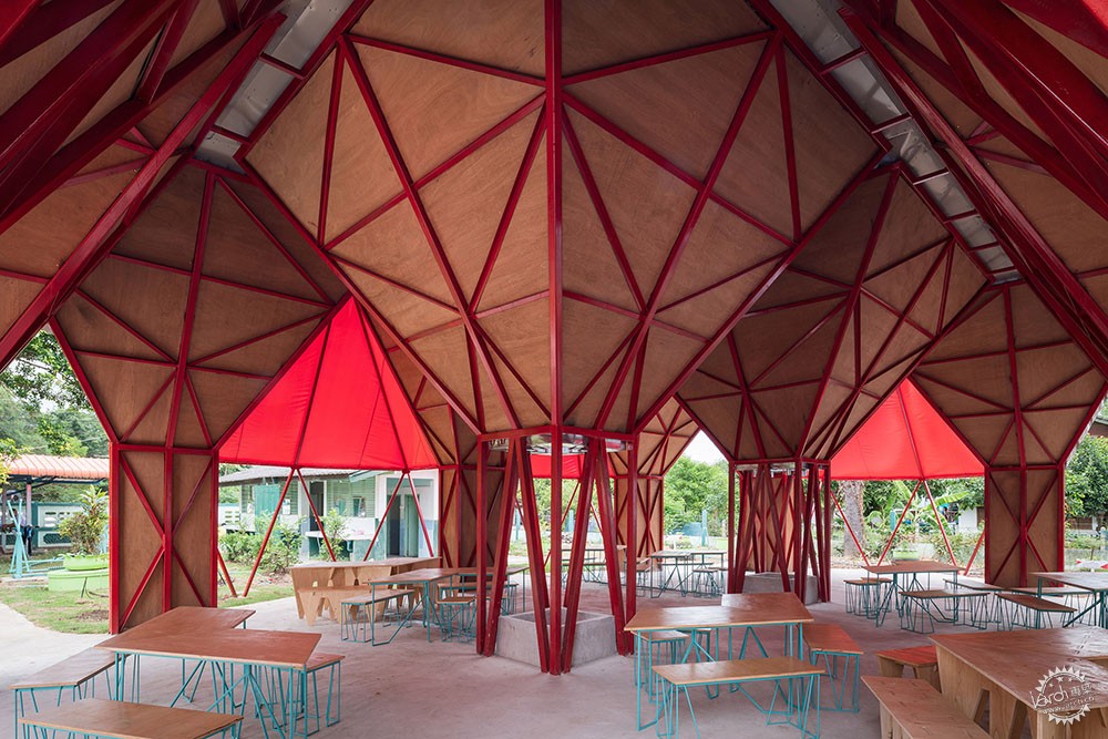

Pareid事务所与朱拉隆功大学合作设计了教室,使之成为一个灵活的空间,这适合泰国的气候,不依赖于人工的制冷和光照。
Charbel说:“泰国的环境有点棘手,因为它涉及两种极端环境条件——暴雨和全年高温。该地区大多数典型建筑都是用窗户完全封死的。”
他继续说:“Pylonesque设计的目的是利用自然环境,同时限制一些不良影响。这建筑由较高的天花板、开放式平面、无墙周长和特定的饰面组成,轻质的半透明乙烯基和用于隔热的水煮胶合板,使我们能够轻易做出想要的效果。”

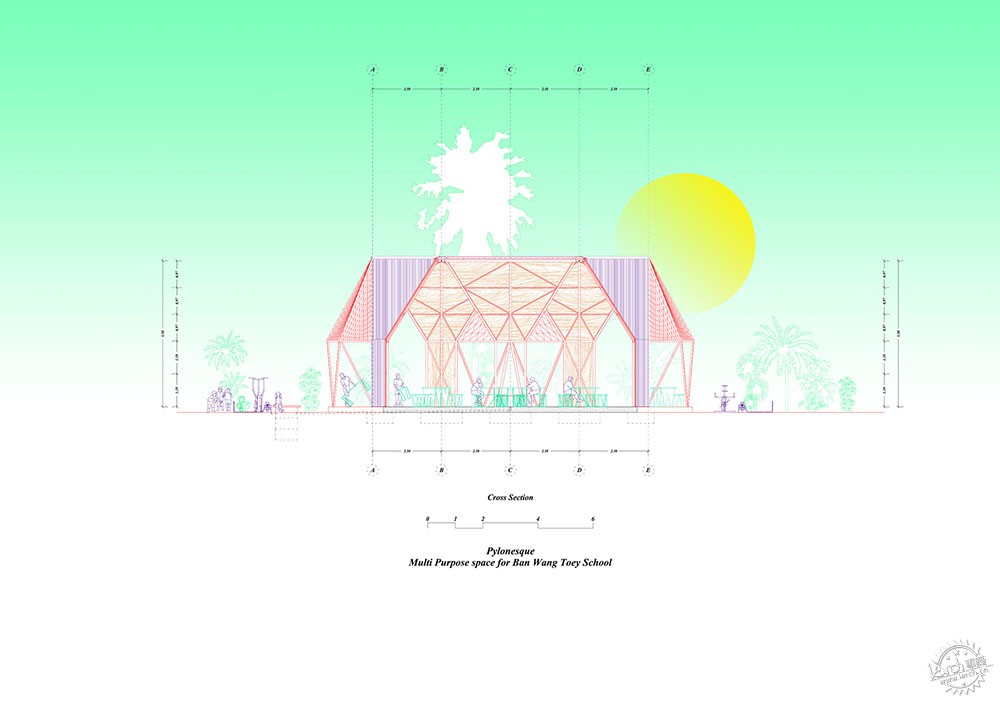

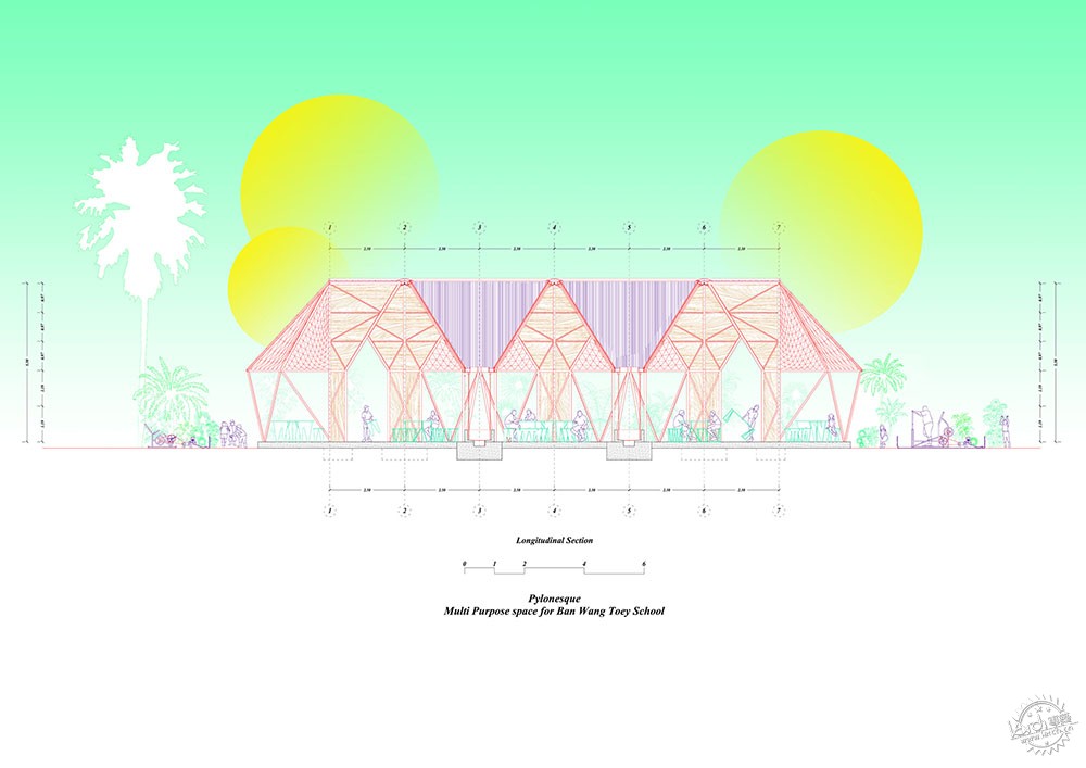

Pareid designed the classroom in collaboration with students from Chulalongkorn University to be a flexible space that was appropriate to the Thai climate and did not rely on artificial cooling or lighting.
"Thai context is a bit tricky, as it deals with two types of extreme environmental conditions – heavy rains and year-round heat," explained Charbel. "Most typical constructions in the area respond to this by being entirely sealed off with some windows, which in turn results in the need for fans and artificial lighting."
"Pylonesque was designed with the intention of utilising the natural environment while limiting some of the undesirable impacts – a combination of high ceilings, open plan, wall-less perimeter, and specific finishings such as translucent vinyl for light and water boiled plywood for thermal insulation, allowed us to do this," he continued.

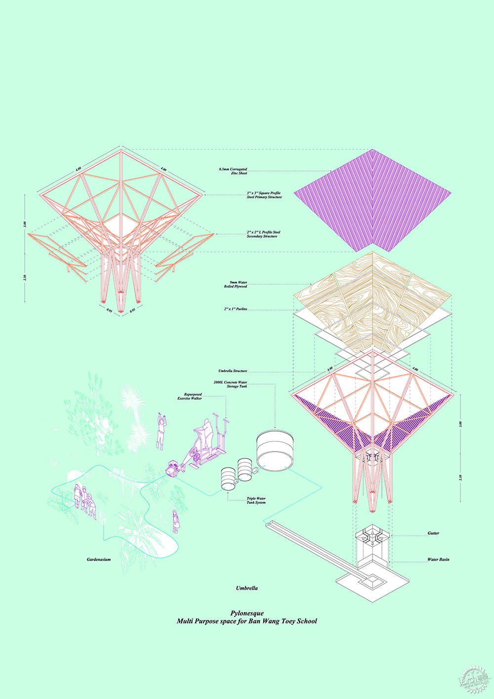

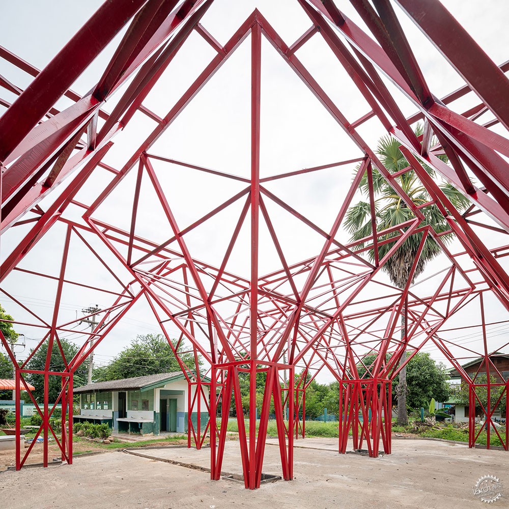

项目的主体结构由简单的钢框架组成,形式类似于电力塔架,这既是建筑物命名来源。
Charbel说:“通过研究电力塔架的构造和形状,我们决定设计一种结构,使其可以作为脚手架,并使用手工安装。因此,每个直线构件的最大长度为4米,从而便于一两个人手动移动金属棒并将其就地焊接,再随着安装进程逐渐往上攀爬。”
“建筑的整体结构由一个个重复的倒伞状模块组成,这些模块可以建立有限数量的切割和测量,但仍然保留了几何的复杂性。

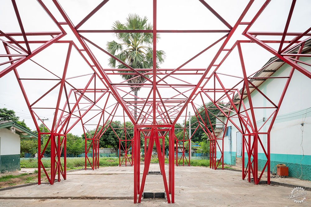

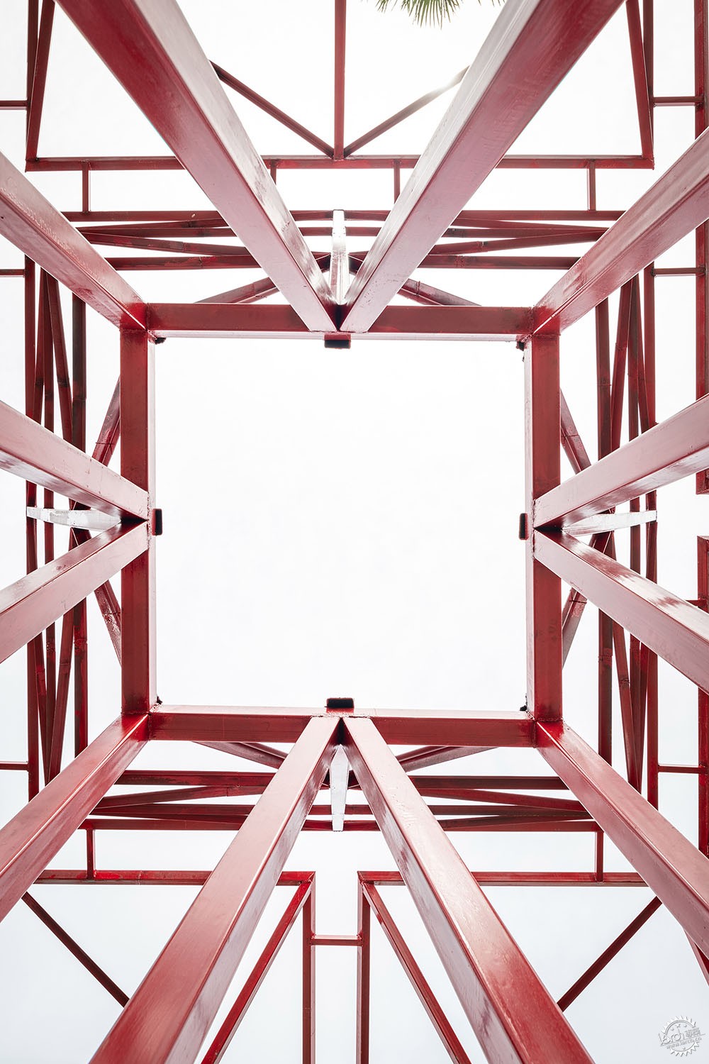

The project's main structure is made from a simple steel frame that takes its form from electricity pylons and gives the building its name.
"By studying the construction method and geometry used for electric pylons, we decided to generate a structure that could double as a scaffolding and be mounted by hand. Thus, the maximum length of each linear member is four meters, which allows one or two people to manually move the metal bars and place and weld them in situ, where it can progressively be climbed as it's mounted," said Charbel.
"Geometrically, the structure as a whole is made of a repetition of inverted umbrella-like modules that can be built with a limited number of unique cuts and measurements but still allow for a geometric complexity."

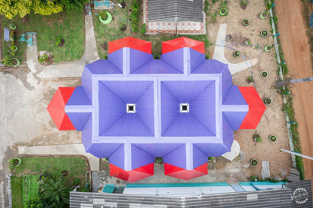

The red steel frame is topped with purple corrugated zinc panels and red canopies to give the building a distinct identity and contrast with the other school buildings.
"The school's existing buildings are primarily a combination of dark and light greens, which blend in with the vegetation and resonates with part of the school's name, Toei, which translates to 'green banana leaf'," said Charbel.
"However, the purpose of this new building and space is to become a new gathering point and a kind of beacon on the school grounds, so we opted for a strategy of standing out while fitting in."

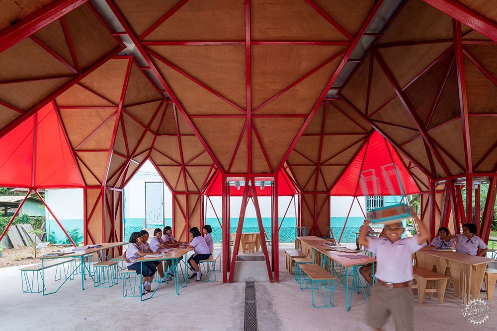

除了集水漏斗之外,其它的覆盖空间完全开放,Pareid事务所为建筑设计了一系列的模块化家具。
Charbel继续说:“以往的教室和空间按等级顺序固定,我们没有规定空间应该如何使用,而是设计了定制的模块化家具,这允许学生和工作人员根据需要重新排布。”
The covered space is completely open, with no fixed items except the two water-collecting funnels. Pareid designed a range of modular furniture to be used in the classroom.
"Traditional classrooms and spaces operate on the basis of a hierarchical order," Charbel continued. "Instead of mandating how the space ought to be used, we implemented custom modular furniture that would allow for students and staff to rearrange as needed."
