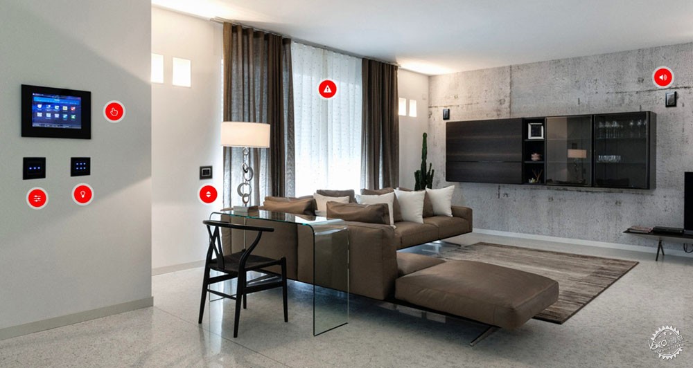

1、体验家庭自动化是说服客户的关键
大部分体验过家庭自动化的人群都很难回到传统系统。为了吸引客户,项目的关键就在于让人们现场体验到到家庭自动化的优势,即测试控制面板的不同选项、管理空间的环境状况、改变光线的强度与颜色、调整室温、不同类别传感器的交互式使用。
1. Experiencing home automation is key to convincing the client
The vast majority of people who have ever inhabited an automated space will hardly feel comfortable returning to traditional systems. To convince a new client, it's key that they can experience in situ the benefits of home automation: test the different options of a control panel, manage the environmental conditions of a space, change the intensity and color of the light, adjust the temperature, and/or interact with the different types of switches and their sensors.

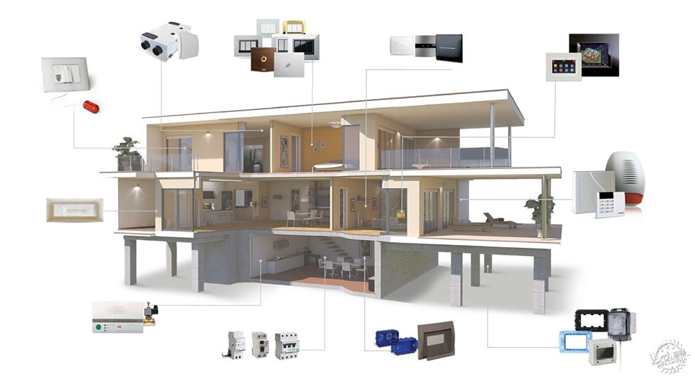

3、将家庭自动化应用于“生成集成式策略”,这会比实现的单个目标更加有效
一旦使用者明确了需求之后,设计师应当结合集成式策略,从而对整个环境进行控制。举例来说,当为夜晚选择预定义环境的时候,该系统会通过单一流程来执行灯光、窗帘的启闭,以及警报器的激活。但是这也不会阻止每个单一选项的管理,但这会比将它们视作整体来考虑而更简单有效。
3. It's more effective to apply home automation to 'generate integrated solutions,' than to fulfill individual functions
Once the needs of the user have been identified, it's advisable to plan integrated solutions that allow programming and controlling of environments. For example, when selecting a predefined environment for the night, the system will execute, in a single process, the attenuation and shutdown of lights, the closing of curtains, and the activation of the alarm. This doesn't prevent the management of each option separately, but it's easier and more effective to consider them, from the outset, as responses as a whole.

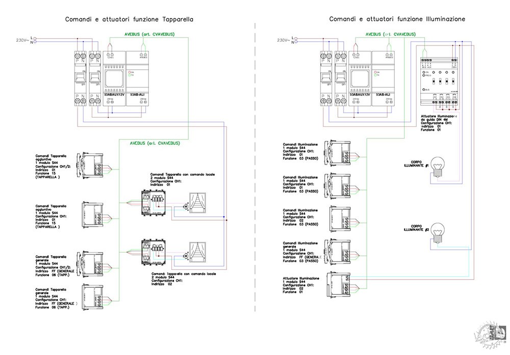

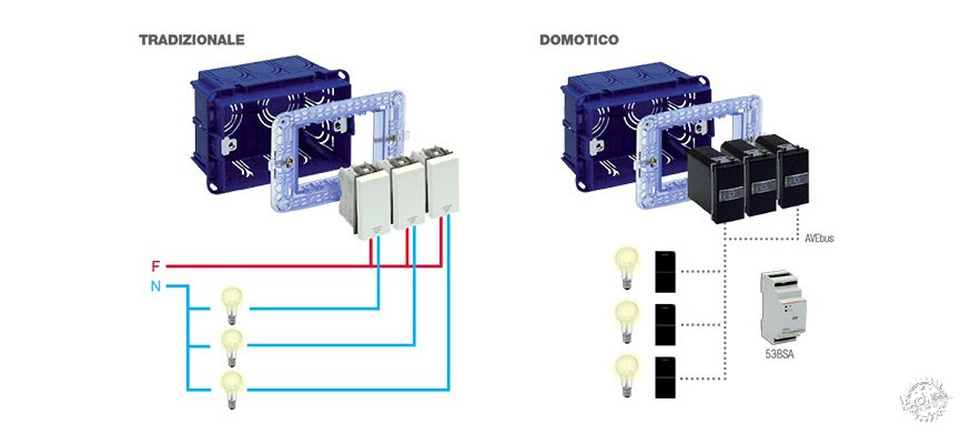

4、传统电气平面与家庭自动化平面并无差异
如果要将家庭自动化引入项目之中,那么建筑师必须简单地定义转换机制的定位,以及其中每个部分的特定功能。在这样的布局中,负责安装自动化系统的公司则有责任进行现场电力装置的干预设计。这种非屏蔽双绞线(Unshielded Twisted Pair——UTP)比传统的布线方式要更容易一些,并且只占用一条管道。
需要特别说明的是,在开始这些工作之前,家庭自动化必须包含在施工计划之中,因为在后期的流程里,整个操作会变得更加复杂。
4. There is no difference between a traditional electrical plan and a domotics plan
When bringing home automation into a built project, the architect must simply define the locations of the switches and other devices, and the specific functions of each one of them. With this plan, the company in charge of the installation of the automation system is responsible for intervening the electrical installation on site, giving the specialist the instruction to incorporate the wiring required by the home automation. This UTP (Unshielded Twisted Pair) cabling is much simpler than the one traditionally used, and occupies a single pipeline.
It's important to point out that home automation must be included in the construction plan before beginning the heavy work since in more advanced stages the complete process becomes more complex.
