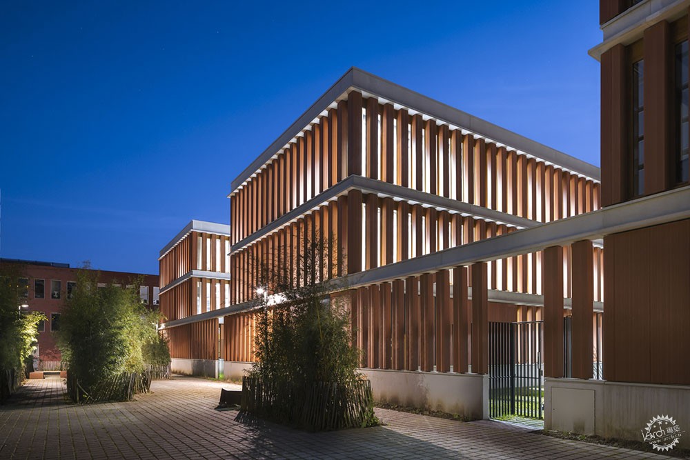

文字描述来自建筑事务所。建筑位于法国里尔的Rives de la HauteDeûle联合开发区,面积约5,100平方米。在2011年的建筑招标竞赛中,客户要求建筑师使用来自周边地区的传统材料,并让建筑与历史紧密相连。该项目由Atelier Tarabusi设计建造,建筑师运用了一种意想不到的富有创造性的建筑设计方法。建筑场地位于勒布朗-拉丰(Le Blan-Lafont)老工厂的对面,周围环绕着许多大型工业建筑以及一些小型工人住所,那些工业建筑当前正在进行项目改造。
Text description provided by the architects. The Doge, a 5,100 square meter office building, intended to welcome young startups, is situated in the joint development zone of Rives de la Haute Deûle in Lille, in the heart of EuraTechnologies. The architectural competition in 2011 imposed a strict limitation, requiring the use of terracotta, historic materials from the immediate surroundings and the region. The structure designed by Atelier Tarabusi, and handed over in 2017, proposes an unexpected, inventive and pertinent architectural approach. Just across from the old Le Blan-Lafont factory, the environment is characterized by the presence of large industrial buildings, which are either rehabilitated or undergoing transformation; and by the small scale strips of workers housing.
