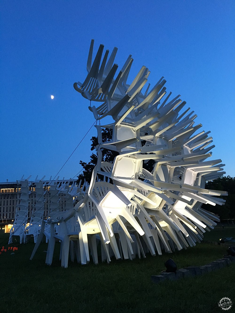

在这个非常有想象力和启发思考的运动中进行感性的转变,伊萨卡岛和布鲁克的CODA将几百只简陋的塑料椅子变成Cornell大学Arts Quad中的一个项目。远看是一个尖锐的单一实体,仔细的观看发现是简单、朴实的重复模块。CODA 解释说,“对象的功能不再从它们的使用(腿、扶手、作为)来衡量,而是用它们的形式(尖峰、曲线、空隙)来衡量,由于它们离开地面旋转,它们失去了与人体的关系。”我们访问了 Caroline O'Donnell,他是 CODA的领袖,他解释了完全可回收的 URCHIN在发展和建设中所面临的挑战。

In this exceptionally imaginative and thought-provoking exercise in perceptual shifts, Ithaca- & Brooklyn-based CODA transformed hundreds of humble plastic lawn chairs into a project in the Arts Quad at Cornell University. Viewed from afar as a spiky singular entity, close inspection reveals the simple, unpretentious repeated module. CODA explains, "the object’s features are no longer understood in terms of their use (legs, arms, seat) but in terms of their form (spikes, curves, voids) as, due to their rotation away from the ground, they lose their relationship with the human body." We asked Caroline O'Donnell, principle at CODA, to explain the challenges faced in the development and construction of the fully-recyclable URCHIN.

重要的不是损坏椅子,而是按秩序排列它们,在展馆拆卸后重复使用。我们需要做最小的切口,同时让整个展馆的曲线在不断变化中。我们还需要独特的连接,让它尽可能看不见,然后把注意力集中在椅子上。经过多次试验,我们解决了独特长度的螺纹杆,通过椅子上的小切口用螺栓连接在一起。

It was important not to damage the chairs in order for them to be reused after the pavilion is demounted. We needed to make minimal incisions, while allowing the curve of the overall pavilion to be constantly changing. We also needed the unique connections to be as invisible as possible to focus the attention on the chairs. After many tests, we settled on threaded rods of unique lengths that were connected by bolts through small incisions (ear-piercings) in the chair.

许多!虽然椅子在结构上被定性,它们仅仅被定为用于坐的通常的位置,不是我们有的在方向上的负荷。这很难计算。我们用数字建模,并做了模拟和比较结果。由于它们是户外家具,椅子不防火,为了获得建筑许可,需要满足城市中的消防等级。

Many! While the chairs are rated structurally, they are rated only for sitting in the usual position, not having the loads in the directions that we had them. This was very difficult to calculate. We modeled it digitally and made mock ups and compared the results. Since they are outdoor furniture, the chairs are not fire rated and a fire rating was required from the City in order to get building permission.

我们试图从制造商那购买散装以及捐赠的椅子。最终,最好的选择是用Home Depot的折扣购买椅子。所有的椅子都有独特的连接(螺纹杆),用Grasshopper建模。在几个星期的过程中,椅子被安置在垂直的C形里,然后用两天进行现场安装在一起(36 C形柱)。

We attempted to buy in bulk from the manufacturers, as well as to have the chairs donated. Eventually the best option was buying chairs at a discount from Home Depot. All of the chairs have unique connections (threaded rod) which were modelled in Grasshopper, and installed by our team. Chairs were built in vertical C-shapes inside over the course of a few weeks, then carried out to the site and installed together (36 C-shaped columns) in two days.
