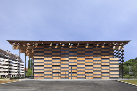

日本公司隈研吾建筑事务所完成了矗立在法国贝桑松杜河河岸边的木质方格立面的艺术文化中心。

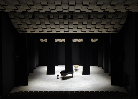

艺术城,包括贝桑松艺术中心,拥有地方画廊,艺术学院,以及音乐城。音乐学校配备了自己的礼堂。
Japanese firm Kengo Kuma and Associates has completed an art and culture centre with a chequered timber facade on the banks of the Doubs river in Besancon, France
Entitled Cite des Arts, the centre comprises the Besancon Art Centre, which includes a gallery for regional collections and an art college, and the Cite de la Musique, a music school with its own auditorium.

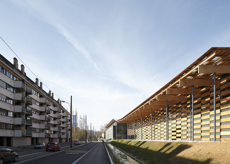

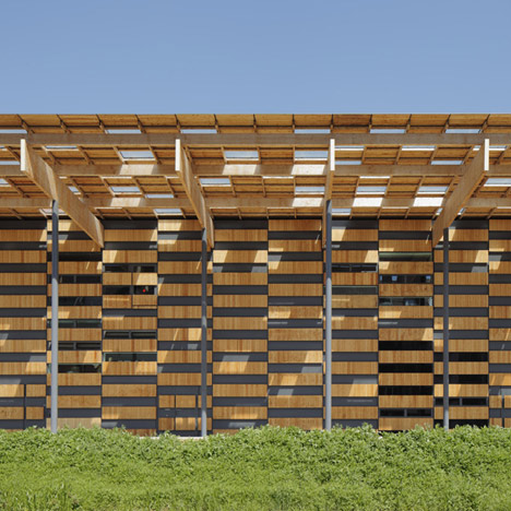

隈研吾建筑事务所赢得了设计竞赛,他为这个中心的单层屋顶下设计了木质包裹的复杂结构。屋顶桥梁结构为两个三层建筑的中间部分的空白提供有遮蔽的开放空间。
”我们不想就提出一个简单盒子的概念“, 建筑师说。 “我们旨在用现存的异构元素创造一个统一的区域,在屋顶下创造特殊空间---一个树荫空间,从河流方向吹来的风可以穿过这个空间。 我们用漂亮的屋顶盖住了美丽的河岸。”

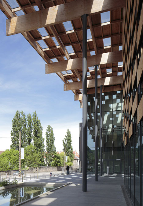

Kengo Kuma and Associates won a competition to design the centre with plans for a timber-clad complex united beneath a single roof. This roof bridges the gap between a pair of three-storey buildings, creating a sheltered terrace in the space between.
"We did not want to propose a simple box," say the architects. "By covering the gorgeous riverside with one generous roof, we aimed to give a unity to a site characterised by heterogeneous existing elements, and to create a special space under the roof, a 'shade of trees' space where the wind from the river could blow and pass through."

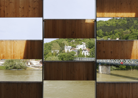

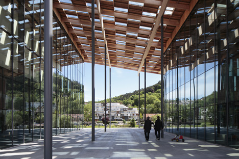

钢和玻璃面板在棋盘般的木质立面穿插构成外部形态,创造出的不同透明度使两座建筑中间的空间变得多样。 接待区域充满自然光,教室和展览画廊则相对封闭,不透明。
Steel and glass panels are interspersed between the chequerboard of timber that blankets the exterior, creating different transparencies to various spaces inside the two buildings. Reception spaces are filled with natural light, while classrooms and exhibition galleries are made more opaque.
贝桑松艺术中心以及音乐城/隈研吾建筑事务所/Besancon Art Centre and Cite de......第6张图片
“美丽的光阴可能穿过这个马赛克墙面拥抱在河边驻足的人们,”建筑师说。
"A beautiful shade may pass through this mosaic and enfold the people on the riverside," say the architects.

屋顶创造了建筑和自然的连接,让方案变得很有开放感。半透明的屋顶象征建筑与非建造的融合,当人们从Citadelle俯瞰发现这个建筑的时候作为一种伪装。这是一种吸引游客聚集到他保护区域之内的行为。 象征城市和自然,市民和河岸,公众与文化的相遇。
The roof creates the link between the building and its environment and makes the project blatant. Semi-transparent, the roof symbolises the fusion between built and not-built and act as camouflage when people discover it from the Citadelle which is height overlooking. It is an invitation to the citizen to gather below his protection. It symbolised the encounter between the city and the nature, the citizen and the riverbank, the public and the culture.

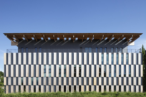

大屋顶下进行统一,两个不同功能的立面能在图案上细微差别进行辨别,一个是木板,一个是钢板。图案尺寸为:(FRAC)区域当代艺术基金会 水平 5000x2500, (CRR)区域学院 1625 x (垂直层高的一半)
Organisation Principle
Unified below the large roof, the two functions are identifiable by subtle differences in the patterns of the façade composed by wood panels and steel panels. The pattern dimensions are for the FRAC: 5000 X 2500 Horizontal while for the CRR 1625 X half floor height vertically.

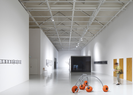

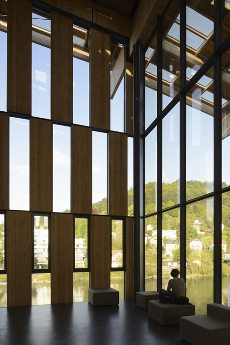

FRAC部分分布于旧砖结构仓库。在抽掉两个楼板以后,空隙区域成为主要展览室。 FRAC的大堂尽可能地透明,面向艺术走廊和城市开放。 自然顶部光线的散射得益于屋顶自由布置的玻璃面板。为了和底层树冠有跟多交互感,光线轻轻穿过树叶照射到地面。 CRR空间则更加封闭内敛,除了他14米高的大面积透明的大堂。 FRAC和CRR两者都由屋顶连接,创造出半室外空间,艺术走廊由于半开放空间充满了自然光线。 走廊是一个大的空隙,在全部建筑中发挥功用。他作为一个门户,一个庇护所;加强了两个不同功能方案的特质。
The FRAC is partially located in the old brick warehouse building. After taking out two of the existing slabs, the void created is containing the main exhibition room. The large lobby of the FRAC is as much as possible transparent, open to both "art passage" and city side. The natural top light is diffused thanks to the random positioned glass panels of the roof, in order to achieve to communicate the feeling of being below a canopy of tree, where the light gently come through leaves down to the ground. The CRR is more an introverted space, except for his lobby which is 14 m height and largely transparent. Both lobby of FRAC and CRR are connected by the roof, creating a semi-outdoor space, the "art passage", which is flooded of natural light through the semi-transparent roof. This passage, a large void, is structuring the overall buildings: it acts simultaneously as a gate and a shelter; it emphasises the particularity of this project witch gathering two different functions.

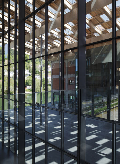

屋顶
屋顶是方案中象征统一的元素。不同方式的材质元素得以集结,比如玻璃,太阳能板,植物,不同颜色质地的金属板。自然光由于不同材质吸收和折射率的不同在材料表面震荡。他创造了一层像素化的材质,偶然的像素设置使整个图案与众不同,抽象,跟环境色调又有点融合。 透明度在下面的程序中显得很必要:教室,管理区域,展览厅的顶部不透明。 但在大堂,或者其他一些被覆盖的室外空间里又需要变得透明。
The roof
The roof is the emblematic and unifying element of the project. Composed in a random way with different element such as glass, solar panel, vegetation and metal panels with different color finish, the natural light vibrates on its surface, depending of the absorption and reflection of the different elements composing it. It creates a pixelised layer where the apparent aleatory position of the "pixels" define a unique image, abstract and confounded with the environment hue. The transparency is partially defined by the necessity of the program below: opaque on top of the rooms such as classroom, administration, or exhibition room. It gets more transparent when it is on top of the lobby or when it is covering the outdoor spaces.

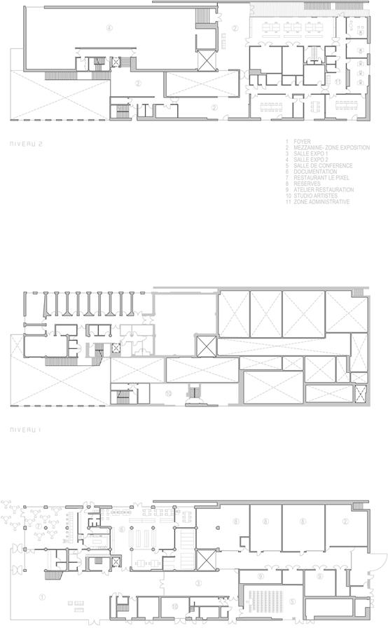

Besancon Art Centre floor plans贝桑松艺术中心平面
