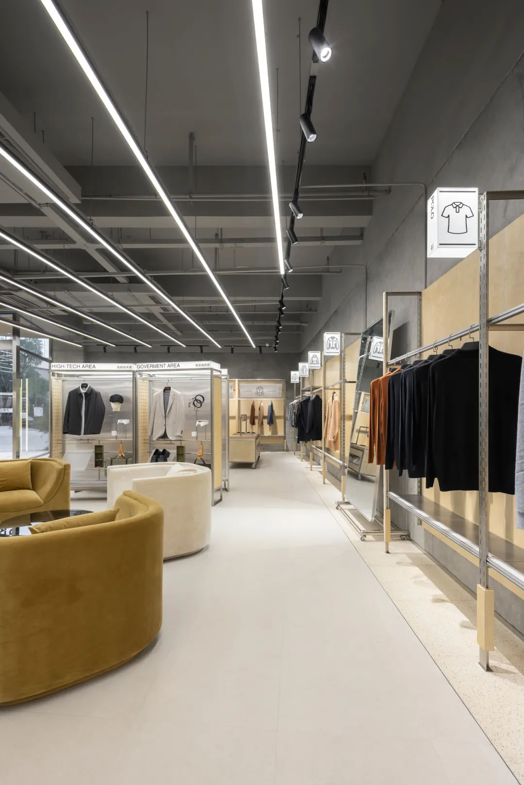

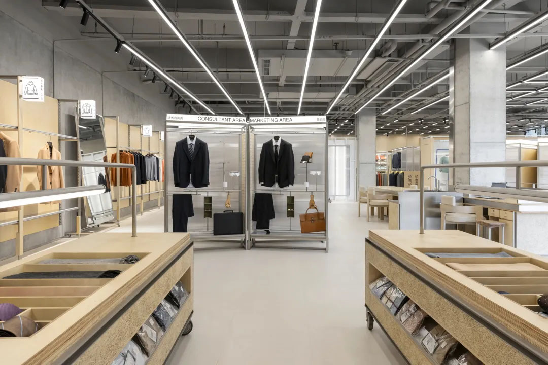

由此,大犬团队设计了一个开放式空间,减去非必要的造型,使其空间的裸露结构变得可视化。深灰色的裸顶,led条形灯的网格排布方式,线性光作为天花的构图元素,突出其节奏与序列。
As a result, the Greater Dog team designed an open space that removed unnecessary shapes to make the exposed structure of the space visible. The dark gray bare ceiling, the grid layout of LED strip lights, and linear light as the composition element of the ceiling highlight its rhythm and sequence.

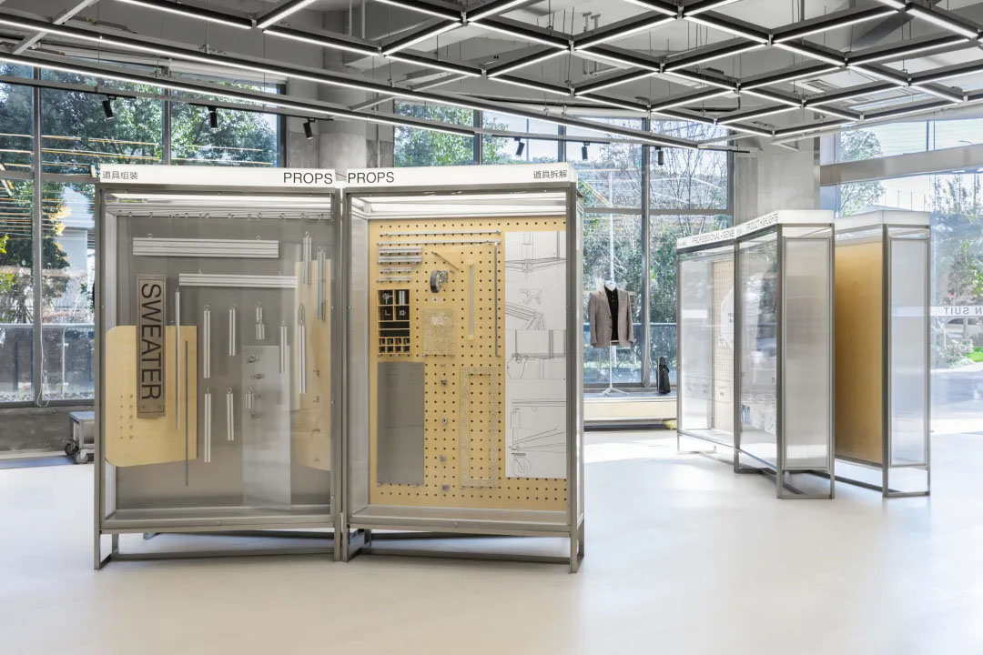

入口处聚集的品牌信息展示区域,借由8个相似的柜体道具,以分解的叙述方式,在不同的柜体里分别展示了Progen Suit的品牌故事与基因、服装产品亮点与可编辑陈列系统的道具拆解。
The brand information display area gathered at the entrance, with eight similar narrative wardrobes, shows the brand stories and genes of Progen Suit, the highlights of clothing products, and the props of the editable display system.

单品陈列区以更具细分化的形式来展开:单西、套西、西裤、衬衫、大衣、Polo衫、毛衫、夹克、卫衣这九大品类作为悬挂与折叠的墙面分类展示形式出现;饰品柜结合了配件与衬衫展示作为可活动的推车陈列道具出现在该区域。
The single-item display area is presented in a more differentiated form: the nine major categories of single suits, suits, trousers, shirts, coats, polo shirts, sweaters, jackets, and hoodies appear as the wall classification display form of hanging and folding; The accessory trolley combines accessories and shirt display as a movable trolley in this area.

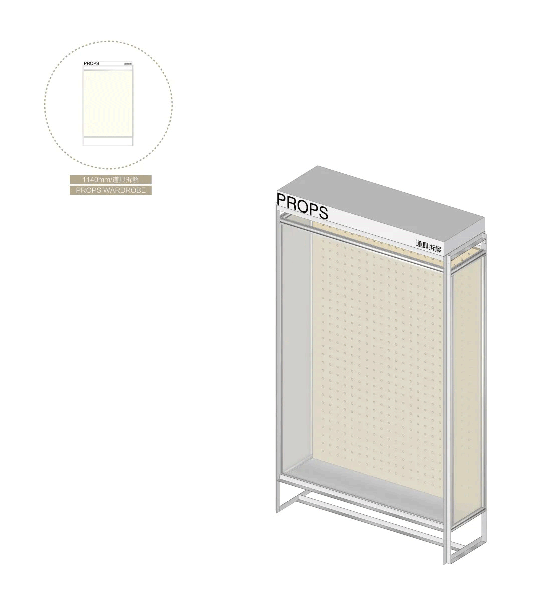

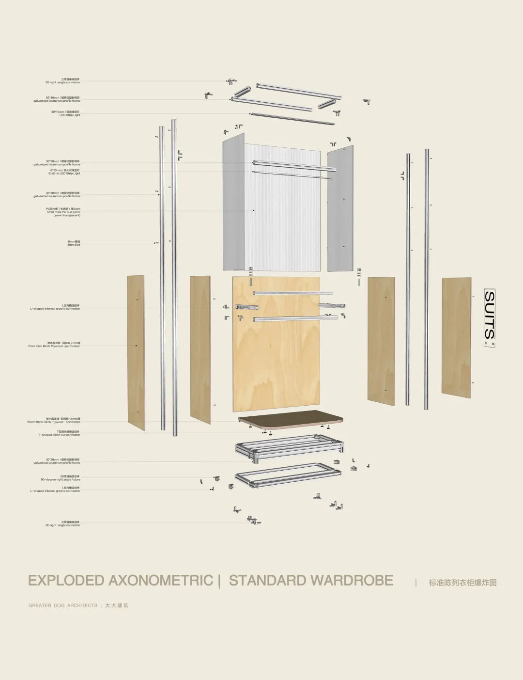

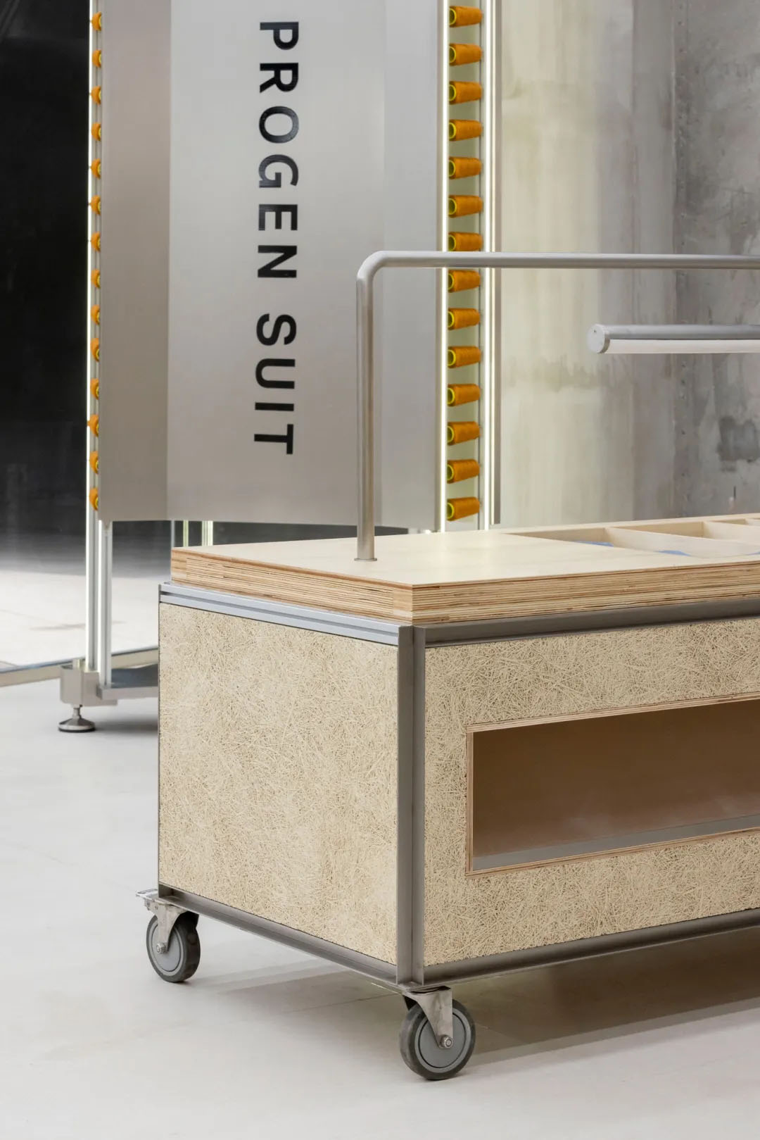

标准衣柜系列  Standard Wardrobe Series
标准衣柜通过使用30mm*30mm的铝型材进行不同方式的搭接来解决陈列高度、宽度与柜体本身承重的问题。该型材因其灵活组装的可能性以及其轻盈性和高性价比而被选中,与桦木海洋板和PC阳光板进行搭配运用,组成标准衣柜的雏形。铝型材的凹槽不仅可以安装螺栓、连接件等作为骨架的主要衔接,还可以作为led照明灯条的卡槽,满足陈列品的细节照明需求。
The standard wardrobe solves the problem of display height, width, and bearing itself by using a 30mm X 30mm T-Slotted Profile for Interlocking in different ways. This profile was selected for its flexibility in assembly, as well as its lightweight and cost-effective. It is applied with birch plywood and PC panels to form a standard wardrobe. The groove of profiles can not only be used as the main connection for installing slots, and connectors, but also for LED lighting strips, meeting the detailed lighting needs of the display.

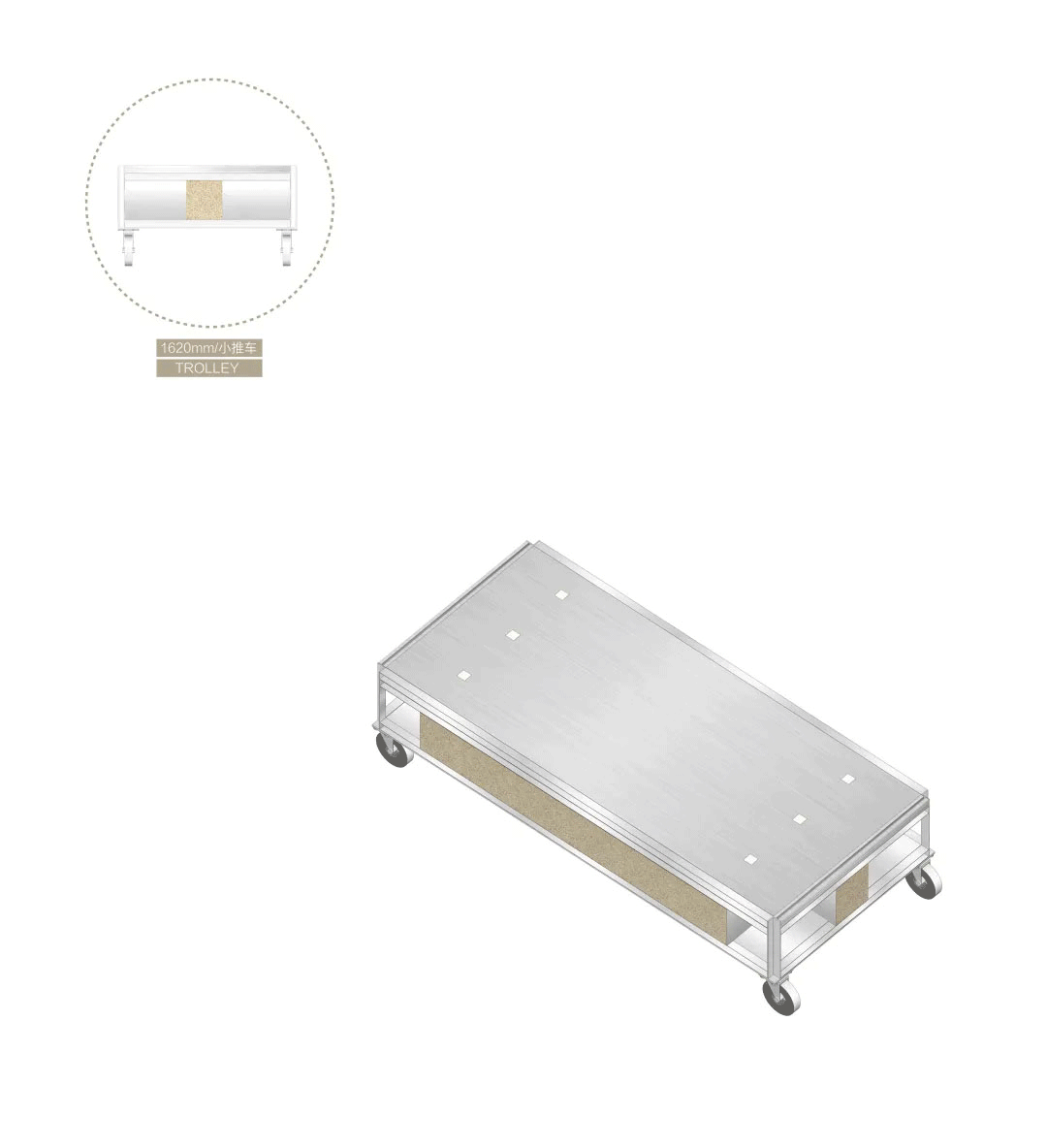

标准型材的运用不止如此,通过尺寸,功能需求的变化,它可以衍生出更多的陈列道具:陈列推车、饰品推车、活动镜、活动衣杆、推车工作台等等,它们被设计师灵活的组合与创建,形成具有组装乐趣的道具陈列体系。
The application of standard profiles is more than that. Through changes in size and functional requirements, it generates more display props: display trolleys, accessory trolleys, movable mirrors, adjustable clothing racks, trolley workbenches, etc. They are flexibly combined and created by designers to form a prop display system with assembly fun.
