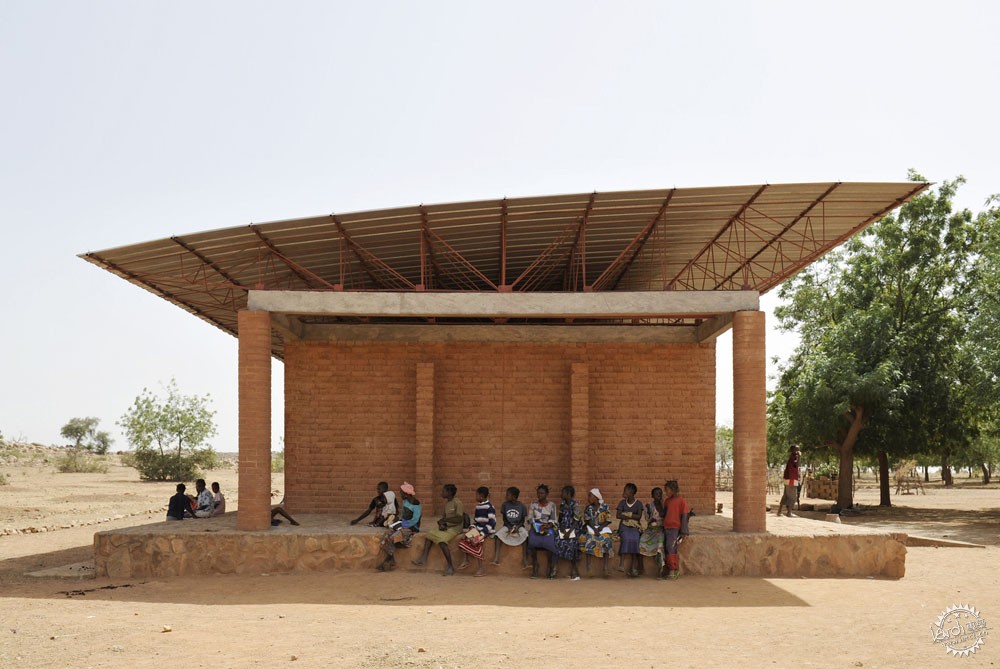

Gando小学/ Kéré Architecture
建筑师将屋面与厚重的砖石墙体分隔开,并且应用百叶窗,让建筑更加通风,同时拥有自然采光。
Primary School in Gando / Kéré Architecture
By detaching the roof from the thick brick walls, Francis Kéré provides ventilation, and pleasant internal lighting through blinds.

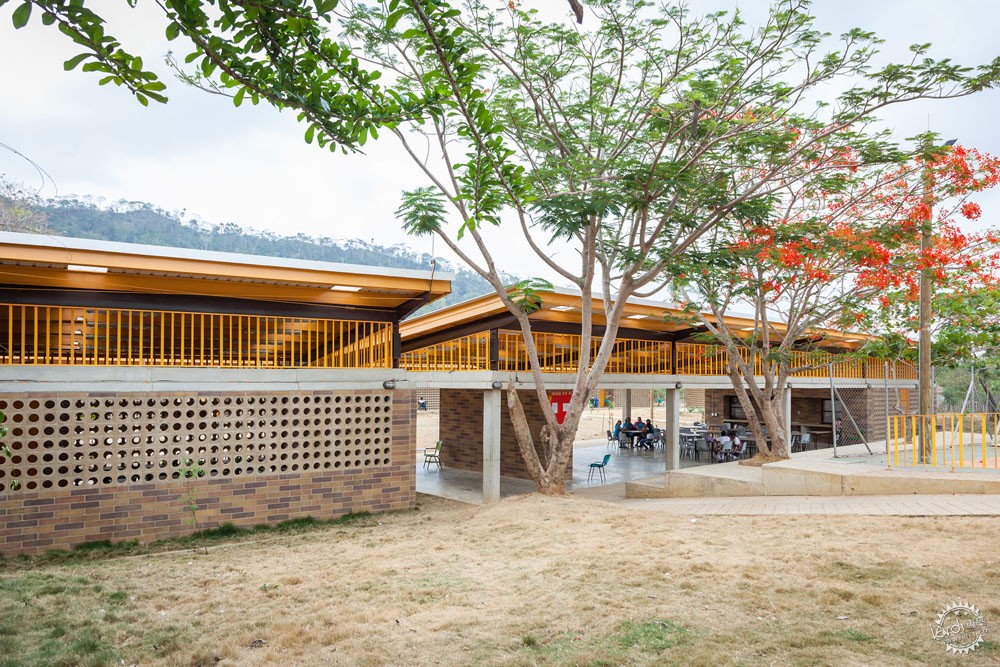

Pies Descalzos学校/ Giancarlo Mazzanti
在该项目中,建筑师应用了通风措施,这些措施应用在立面与屋面之中,建筑材质较为轻盈,其形态也有效阻挡了部分热辐射,为学校带来自然通风。
Pies Descalzos School / Giancarlo Mazzanti
The various filters in the project, both on the façades and on the roofs themselves, along with the lightweight materials and slim shapes, block the radiation and provide ventilation at this school in Colombia.

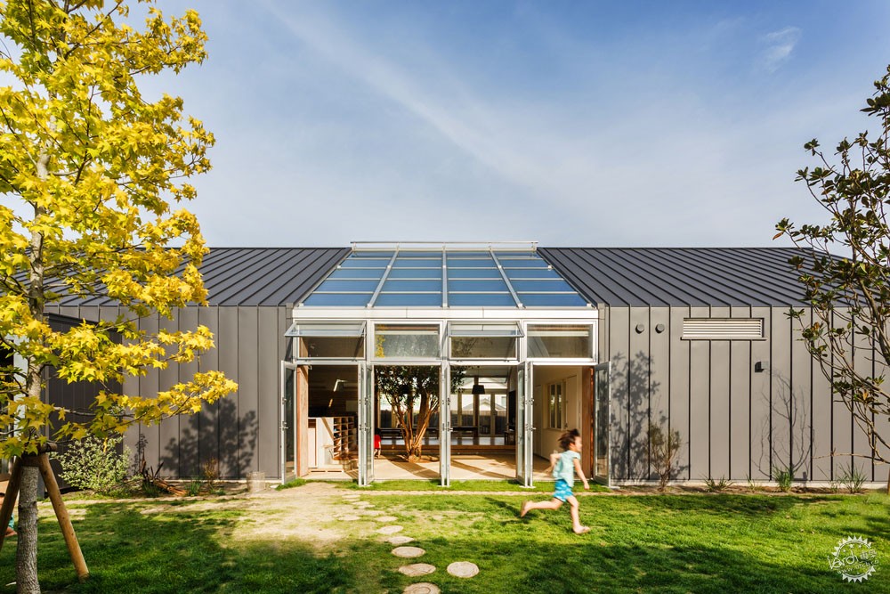

HN幼儿园 / HIBINOSEKKEI + Youji no Shiro
该地区的一年大部分时间都十分寒冷,因此建筑师将室内外空间相结合,应用了树木与自然采光,让建筑环境更加宜人。
HN Nursery / HIBINOSEKKEI + Youji no Shiro
Due to the cold weather most of the year, this project brings the outside to the inside. Trees and generous natural lighting make for extremely pleasant environments.

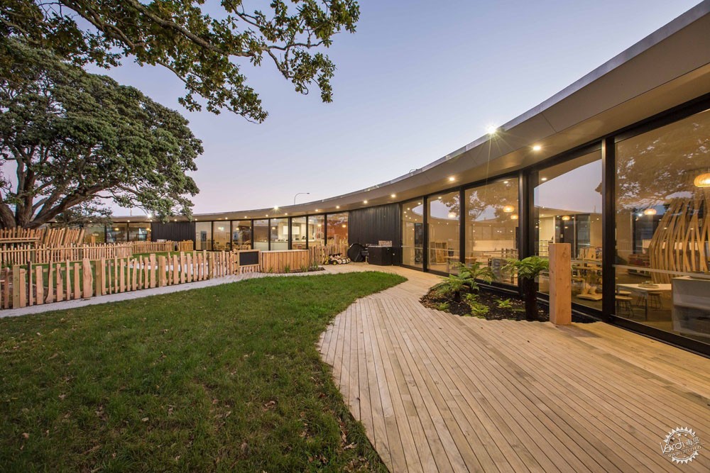

Chrysalis儿童中心/ Collingridge and Smith Architects
这个项目位于新西兰,建筑环绕两棵巨大的树而排布,构成有趣的空间。
Chrysalis Childcare Centre / Collingridge and Smith Architects
The arrangement surrounding two huge trees creates interesting atmospheres in this project in New Zealand.

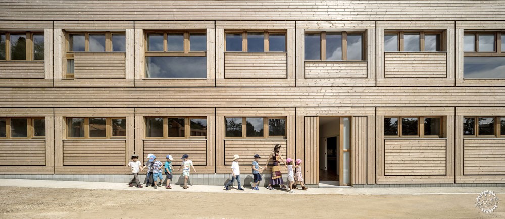

El Til·ler学校/ Eduard Balcells + Tigges Architekt + Ignasi Rius Architecture
建筑师充分利用了窗户结构的优势,为孩子们创造了合乎尺度的起居空间。
El Til·ler School / Eduard Balcells + Tigges Architekt + Ignasi Rius Architecture
The architects took advantage of the rational structure of the windows to create interesting living spaces for the children, consistent with their size.
