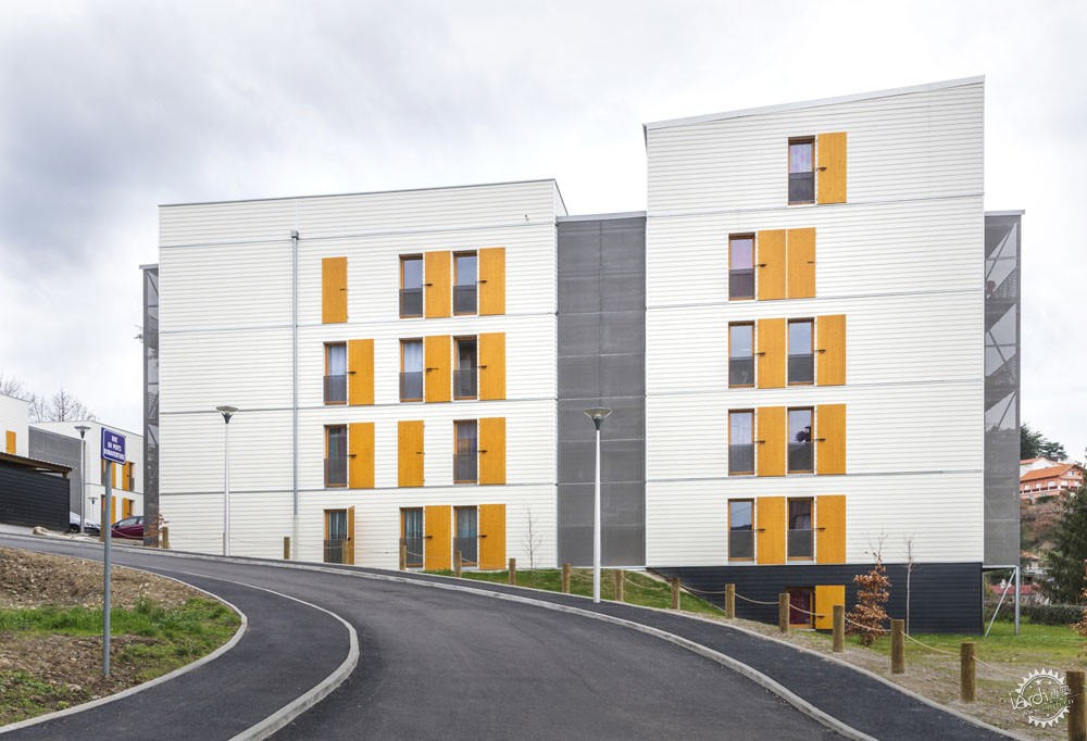

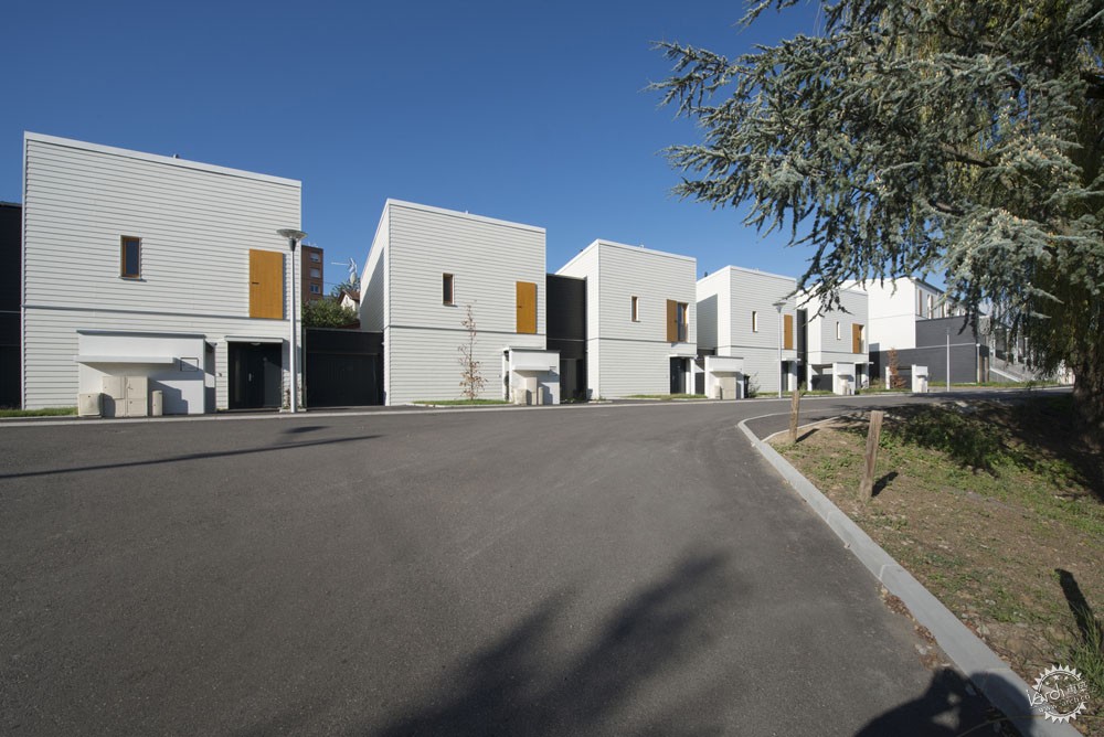

里夫德比耶社会福利住宅公寓/ Tectoniques Architects第1张图片
60 Social Housing Apartments in Rive-De-Gier
由专筑网Brick,杨帆编译
我们的经验
Tectoniques建筑事务所在建造生态住宅方面有着丰富的经验,致力于雄心勃勃的环保措施,采用基于干法施工的特殊施工规程,主要使用预制木构件。里夫德比耶项目将这种基本方法带到了一个新的高度。
整个项目由私人组合居住单元、中型房屋和小型集体住宅区组成,完全采用干法施工,将二维宏观组件以及三维模块用于卫生和技术设施。这种施工方法由Ossabois研发,被称为“5D工艺”。
Our experience
The Tectoniques agency has extensive experience in building housing in eco-neighbourhoods, with a committed and ambitious environmental approach, using a specific construction protocol based on dry construction mainly using prefabricated wood components. The Rive de Gier project takes this basic approach to new heights.
The entire programme, composed of individual grouped accommodation units, intermediate housing and small collective housing blocks, is entirely built using dry construction methods employing 2D macro-components along with 3D modules for the sanitary and technical facilities. This construction method developed by Ossabois is known as the "5D process".

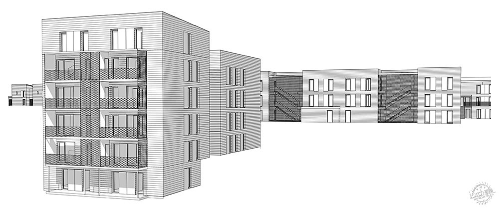

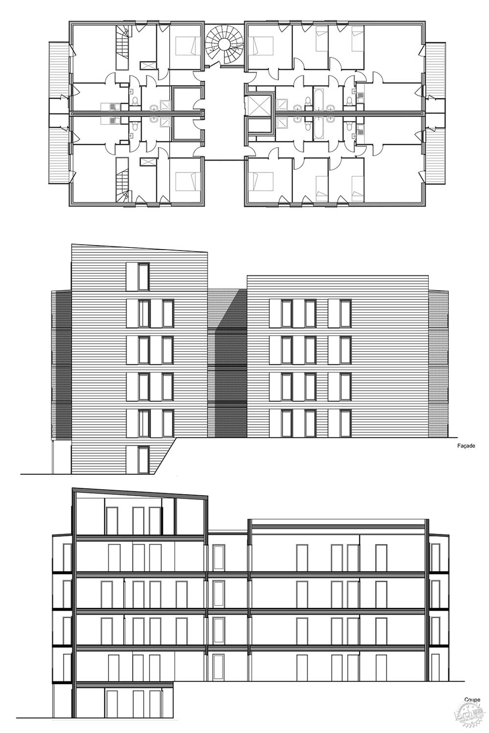

里夫德比耶社会福利住宅公寓/ Tectoniques Architects第2张图片
城市和景观方面的挑战
项目场地位于现有城市网的中心地带,周边景观优美。
第一个挑战是与六座现有建筑以及邻近学校、周边住宅和成为社区特色的绿色空间建立开放积极的联系。
A challenge in both urban and landscaping terms
The project site is located at the heart of an existing urban network complete with the surrounding landscaping.
The first challenge was to establish an open, positive connection with the six existing buildings and the neighbouring school, as well as the surrounding residential housing and the green spaces that characterise the neighbourhood.

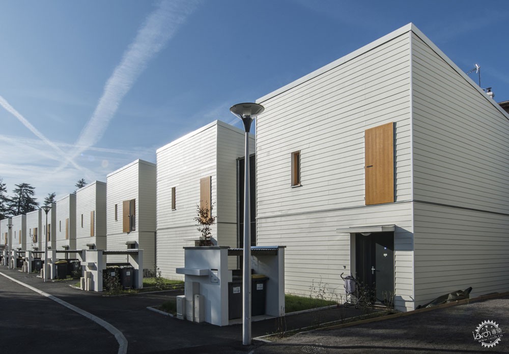

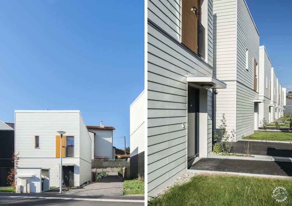

里夫德比耶社会福利住宅公寓/ Tectoniques Architects第3张图片

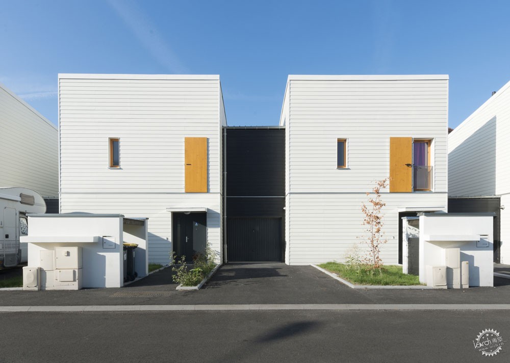

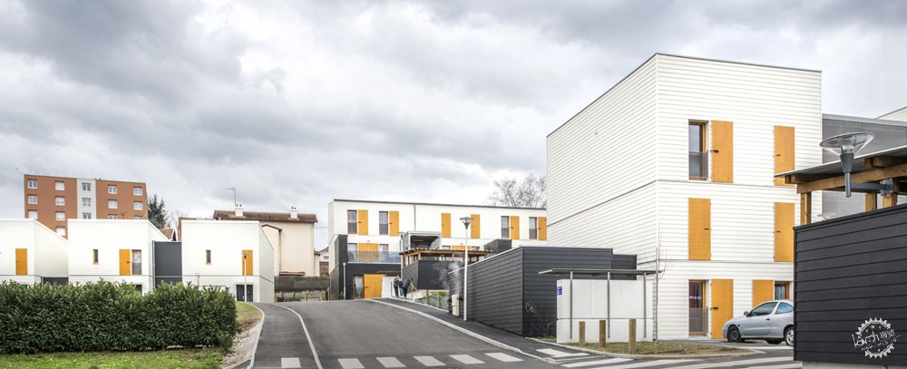

里夫德比耶社会福利住宅公寓/ Tectoniques Architects第4张图片
项目建于山坡侧面没有遮蔽的场地上,这里有清晰的视野,具有很大的便利性。它为建造真正的标志性项目提供了理想条件。建筑风格适用于不同规模,以避免创建宏大的体块,产生可分解的小型体块和体量。
The project is built on the flank of the hillside, on a site that is well exposed and has clear views with no particular inconveniences. It offered the ideal conditions in which to build a truly exemplary project. The architecture works on a variety of scales to avoid creating an imposing mass, instead producing small blocks and volumes that are broken down and split up.

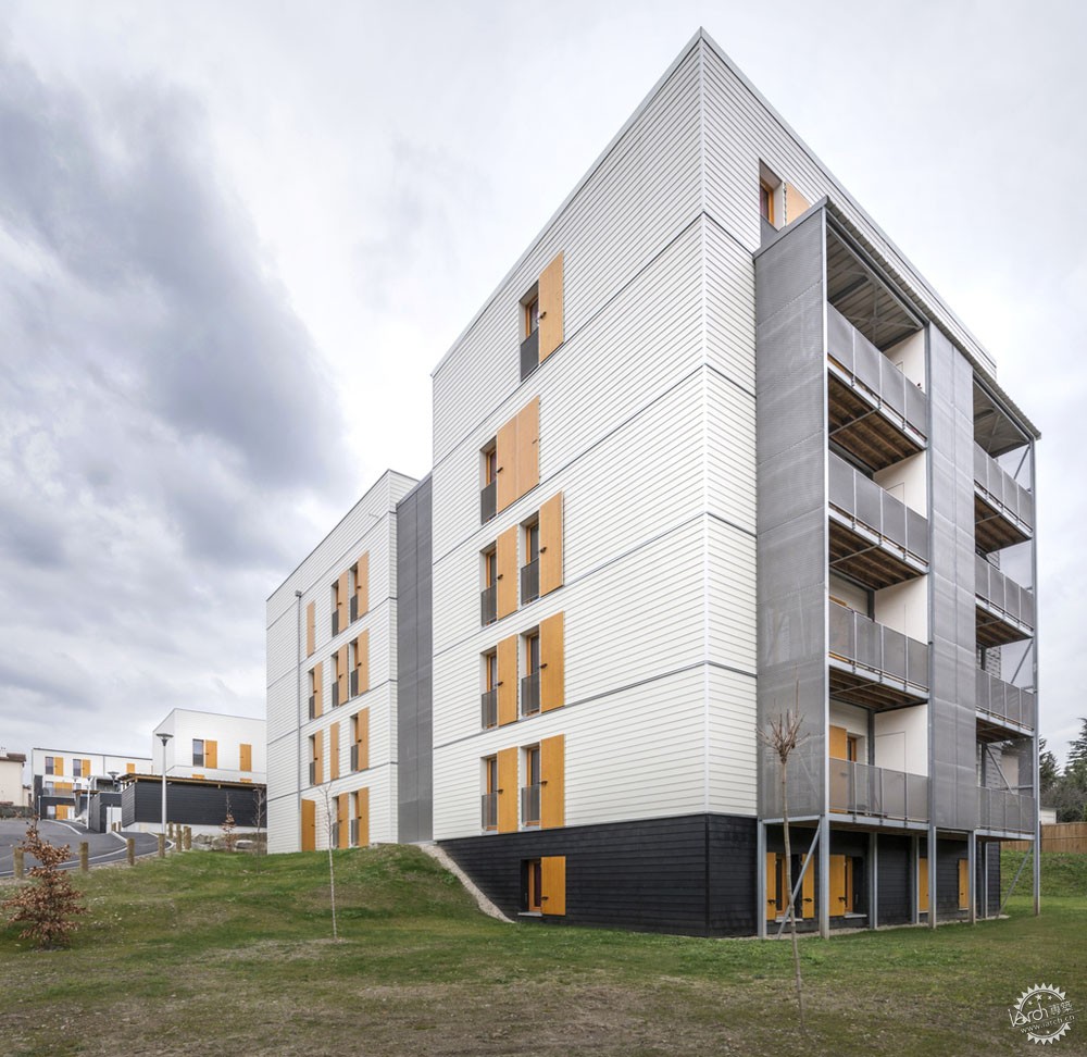

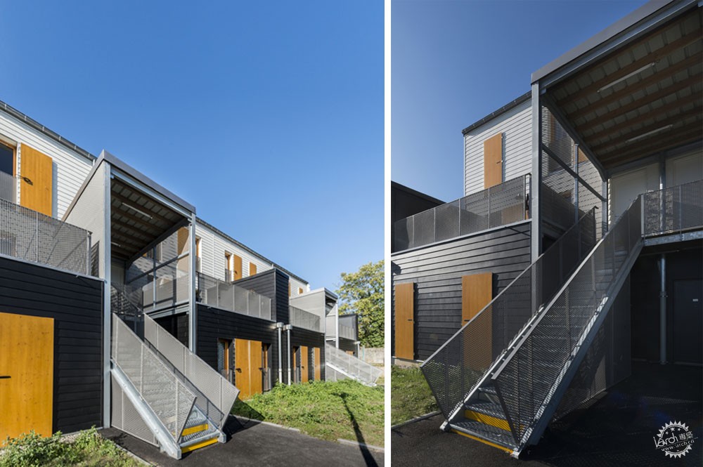

里夫德比耶社会福利住宅公寓/ Tectoniques Architects第5张图片
木质结构很轻,能理想地解决在陡峭坡地上建造的困难。
阳台、外部走廊和花园层都增强了项目所需营造的家庭感。它们在街道、花园和私人住宅的公共空间中形成了不同的阶层。
The very light wood construction is ideal for adapting to the difficulties of building on this steeply sloping plot of land.
The balconies, exterior hallways and garden levels all work to assert the domestic feel of the project. They form the different stages between the public space of the street and the gardens and the private housing.

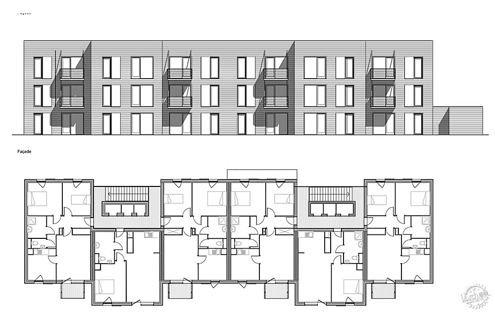

里夫德比耶社会福利住宅公寓/ Tectoniques Architects第6张图片
使用5D工艺的干法施工
这种施工方法由Ossabois研发,主要使用木材,但并未系统性使用,一些结构由以下材料构成:
金属:阳台和走道
混凝土:集中公寓的电梯井道
混合金属混凝土:独立住宅单元的地板组件
用于所有其它结构的木框架:立面、屋顶、承重墙和特定住宅单元里的室内地板。
Dry construction using the 5D Process
This construction method developed by Ossabois, mainly, but not systematically, uses wood as some structures are made of:
-Metal: Balconies and walkways
-Concrete: The lift shaft for the collective apartment block
-Mixed metal-concrete: components for the flooring separating housing units
-Wooden frameworks for all other structures: facades, roofing, load-bearing walls and internal flooring within a given housing unit.

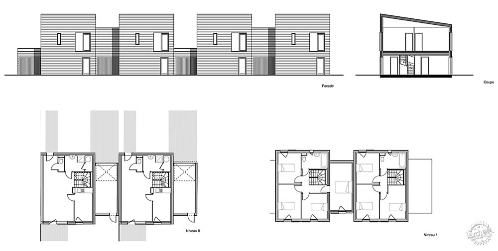

里夫德比耶社会福利住宅公寓/ Tectoniques Architects第10张图片
Plans/平面图
